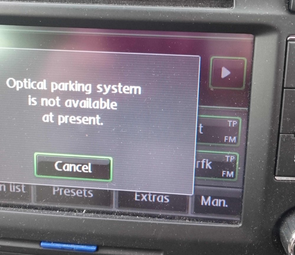

So It looks like it might be the sounder that makes the beeping sound from the VCDS scan.
1 Fault Found:
1080340 - Parking Aid Speaker
          B107C 14 [009] - Open or Short to Ground
          Confirmed - Tested Since Memory Clear
             Freeze Frame:
                    Fault Status: 00000001
                    Fault Priority: 3
                    Fault Frequency: 13
                    Reset counter: 19
                    Mileage: 85257 km
                    Date: 2020.01.21
                    Time: 12:58:29
Which ties in with ths thread I found the other day
And this message came up on the screen again.

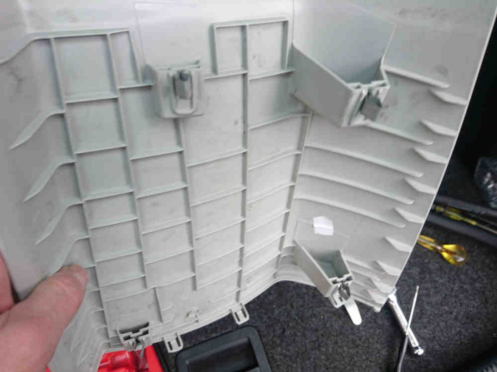

Right here's a little how to replace the speaker.
First I must thank Ark for making the other thread where He metions the location of the speaker as without that thread I don't know how I would have found where it was, even the Dealer coudn't help when I asked where it was.
You need to pull off the seal around the top of the rear door, then remove the piller trims at the offside rear and the next one along at the back door
The rear one just pulls off (takes some force)
I'm having trouble with photo sizes and editing the above post I will sort it later!

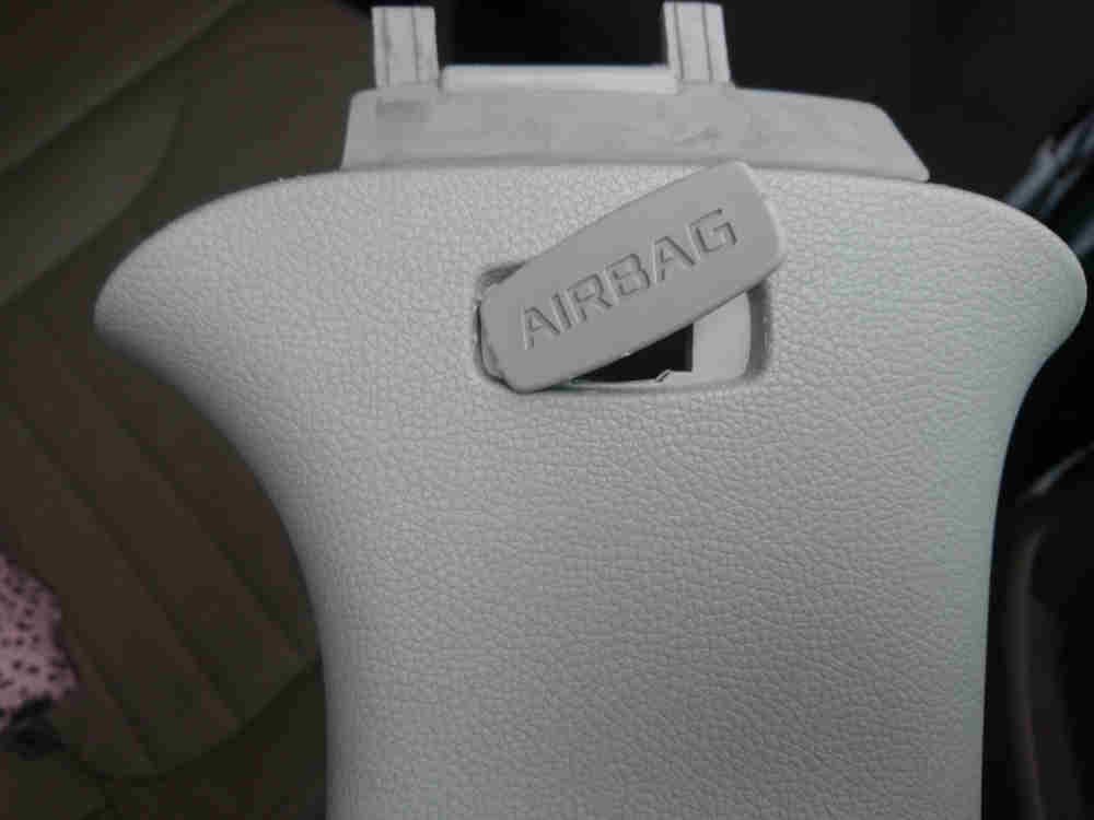

The one near the door has a fixing screw behind the airbag logo, don't worry about the air bag too much as it's in the roof not in the piller.

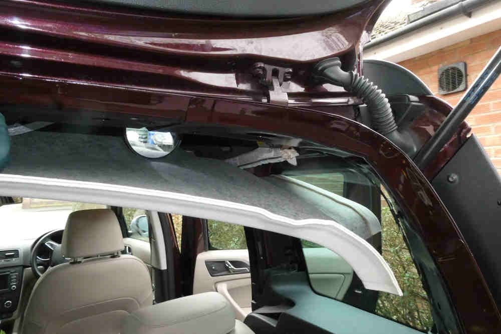

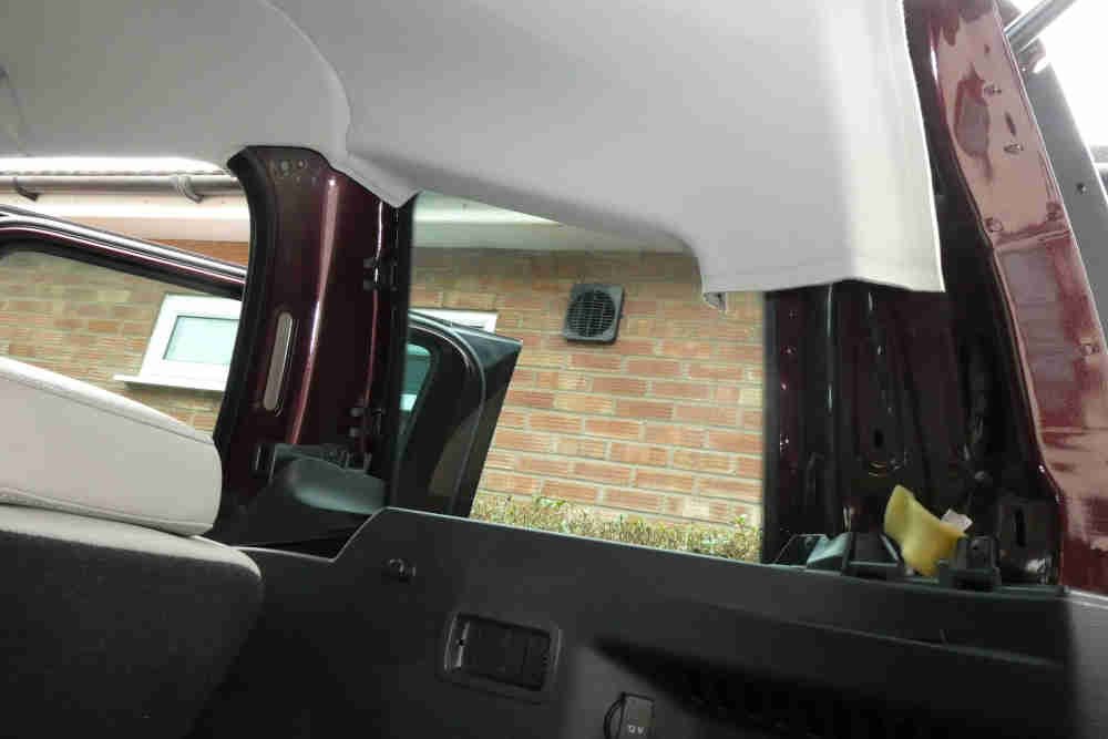

This then lets you pull down the headlining to get some access, If I was to do this again I would also remove the grab handle above the door as I found  a crease in the headlining after I had finished, I'm hoping this will pull out with time and the heat in the car in the summer.
When you pull down the headlining you can't see the speaker as it's faceing forwards in the hump of the roof, I used a mirror to see it and find out how it was attached .

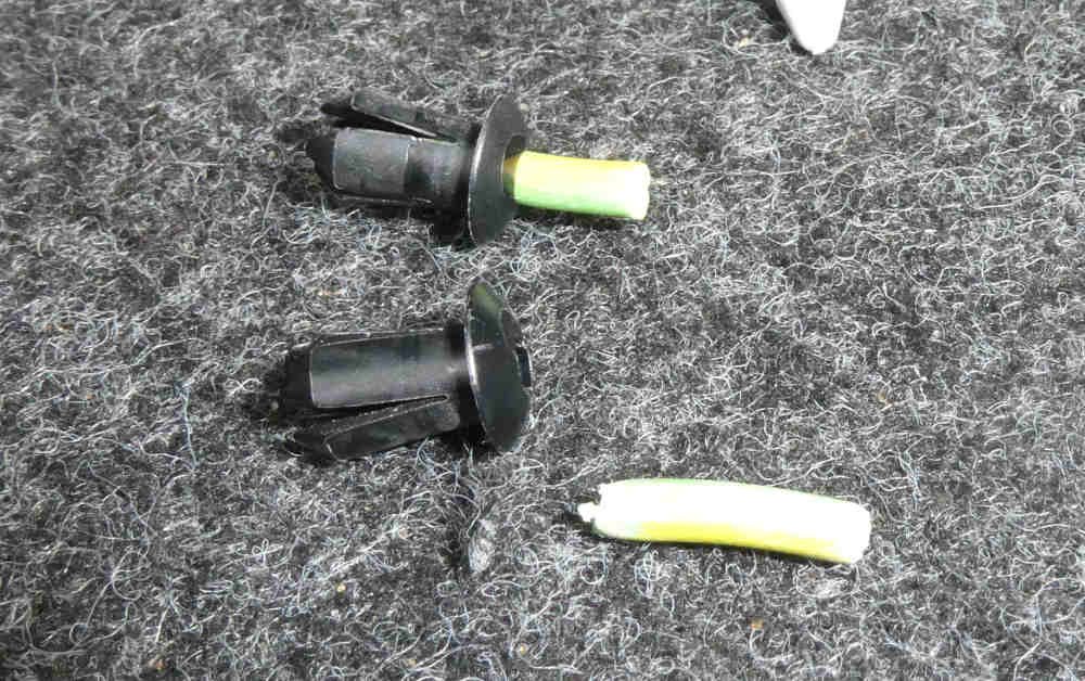

It;s fixed with the plastic rivets that have a pin through the middle to expand them, I managed to punch these through to release the speaker, but the plastic pins were lost into the hollow body section so on re assembly I had to improvise with some pieces of cable insulation.
I'm having trouble with my photo's all being too large so i will add pictures when I've re sized them.
Hidden screw in door piller trim
This is with the headlining pulled down, note the crease near the door piller .
Access is not easy!
Sorry about this being a bit of a mess I didn't know there was a time limit on editing😕

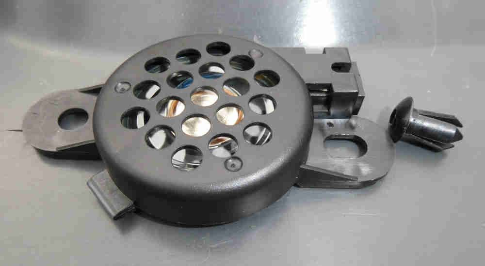

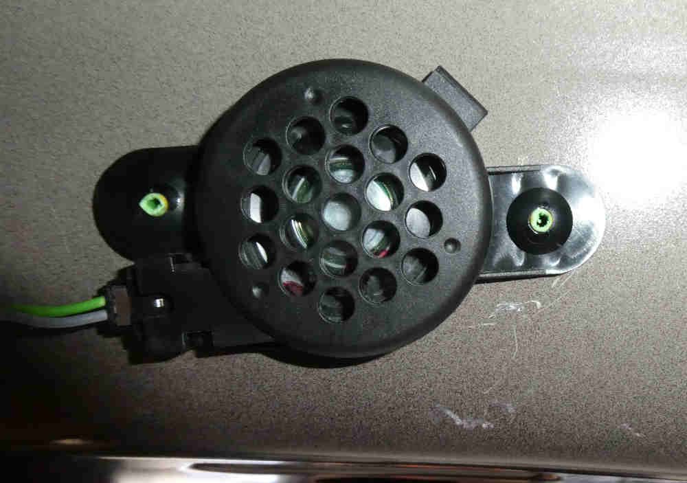

This is the new speaker in place and the old one with the plastic rivet, plus the small pieces of cable insulation I used to replace the the lost centers.
I hope this helps others, it's not difficult but very awkward because you can't see what you are doing.
Speaker was £24
