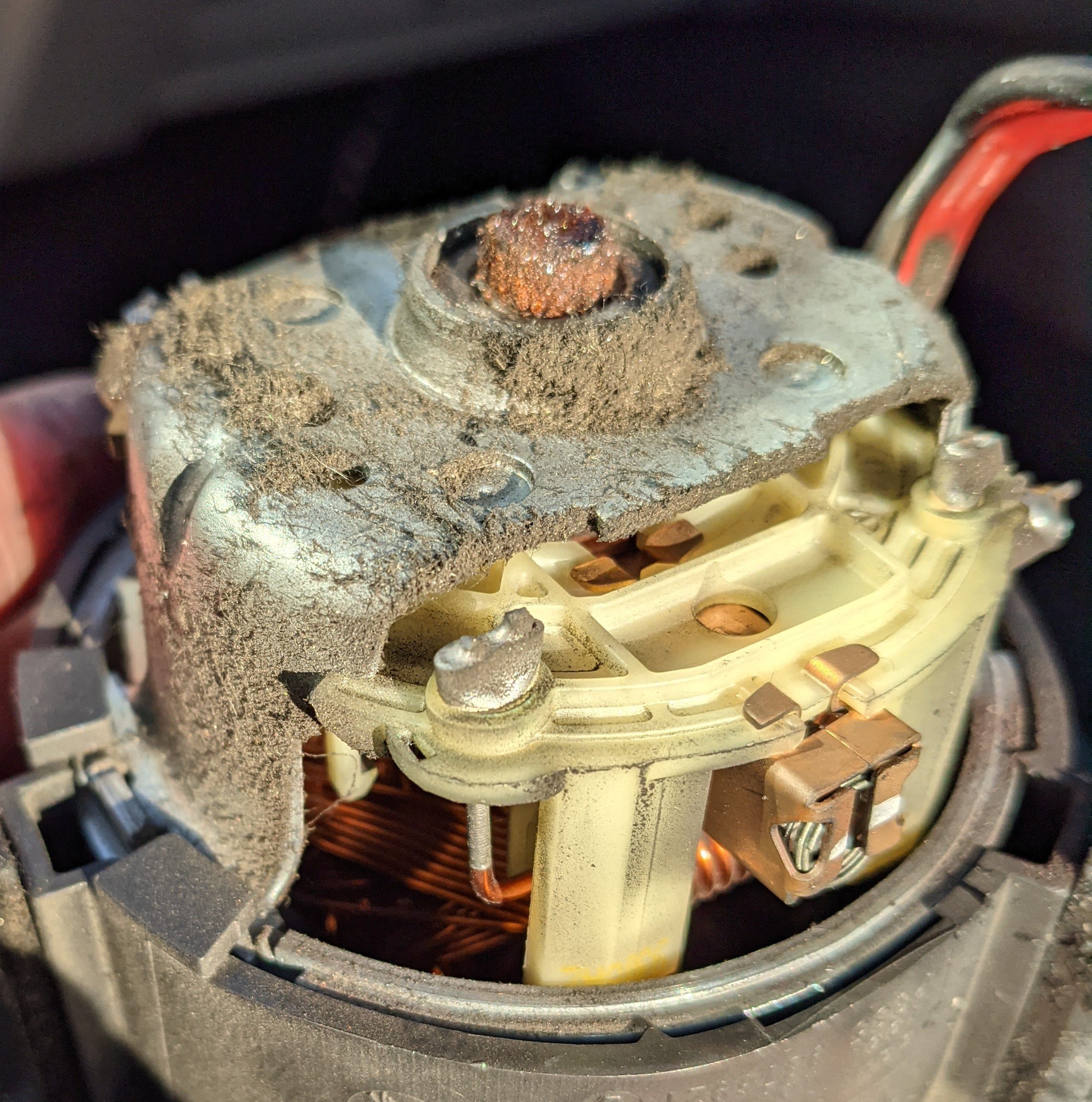

  11. Hi Austin 7 No the motor and fan are upstream of the pollen filter, the air is drawn in under the scuttle at the front window at the nearside corner, then pulled straight down to the fan/motor then across to the pollen filter and into the HAVC. The rust on the motor shaft looks much worse than it was, there was a lot of dust on the fan, But the car is 8 years old. I don't think it had ever been really wet. There was a little what appeared to be condensation inside the motor housing, should have taken more photos. The motor shaft was just bare mild steel so some rust was pretty inevitable, the other end was not rusty at all and the bearings felt fine, maybe it was a combination of the low battery and slightly dragging bearings that made it fault out?
  12. Thanks for the reply Langers. Yes I'm sure you are correct about the S4, sounds familiar but it was about 5 years ago. I am an amature with VCDS as I said I only use it infrequently at times of trouble! I removed the blower this morning and by the time I had manoeuvred it out It was turning but a little stiff and it would spin when powered up. I removed the motor and it did look a little rusty (see pic) I cleaned it all up and applied some 3in1 to the bearings and it felt much better. Put it all back together and all seems fine now. Not to bad to get at, removed glove box and one piece of heater ducting, just a bit fiddly to get it in and out of the housing.
