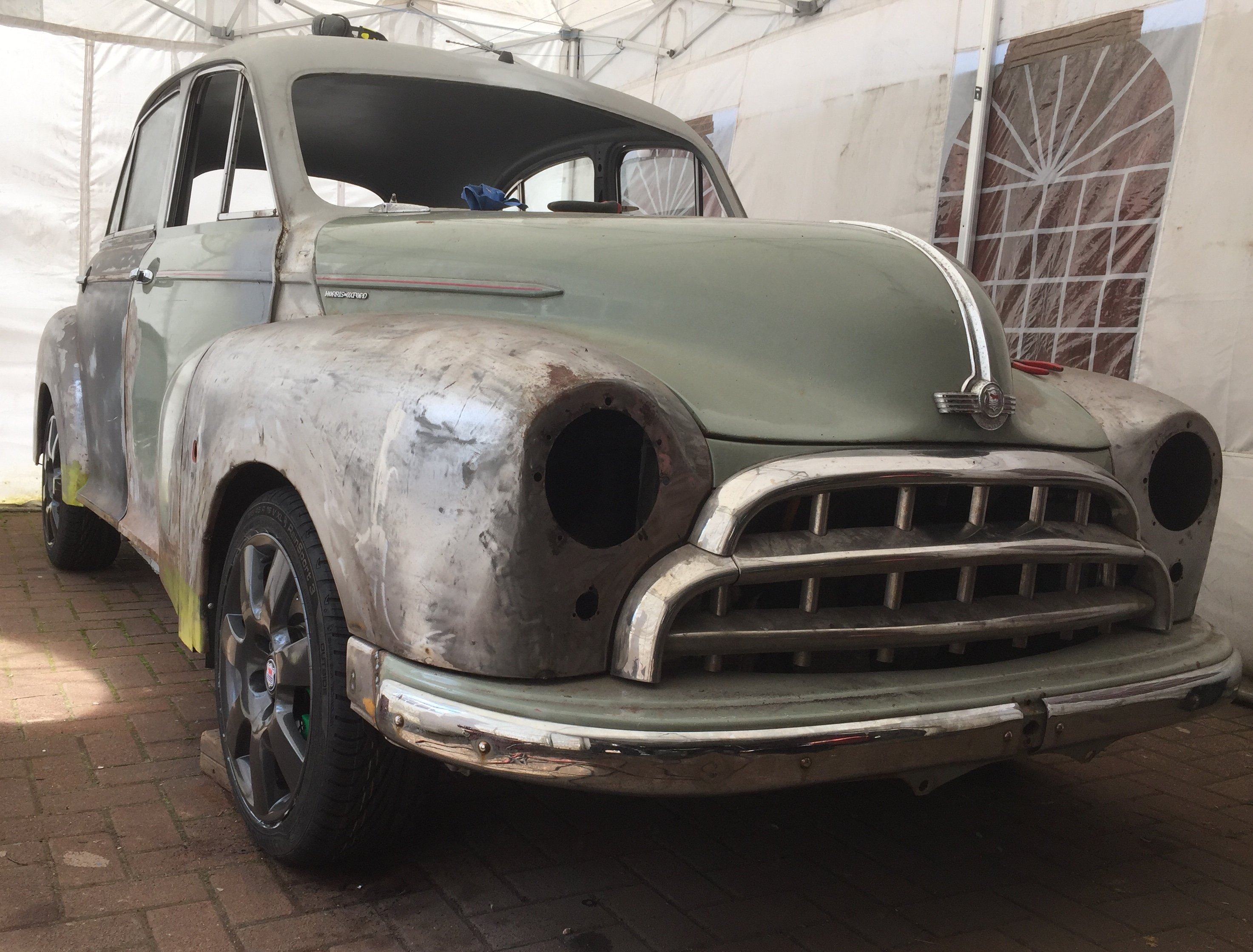

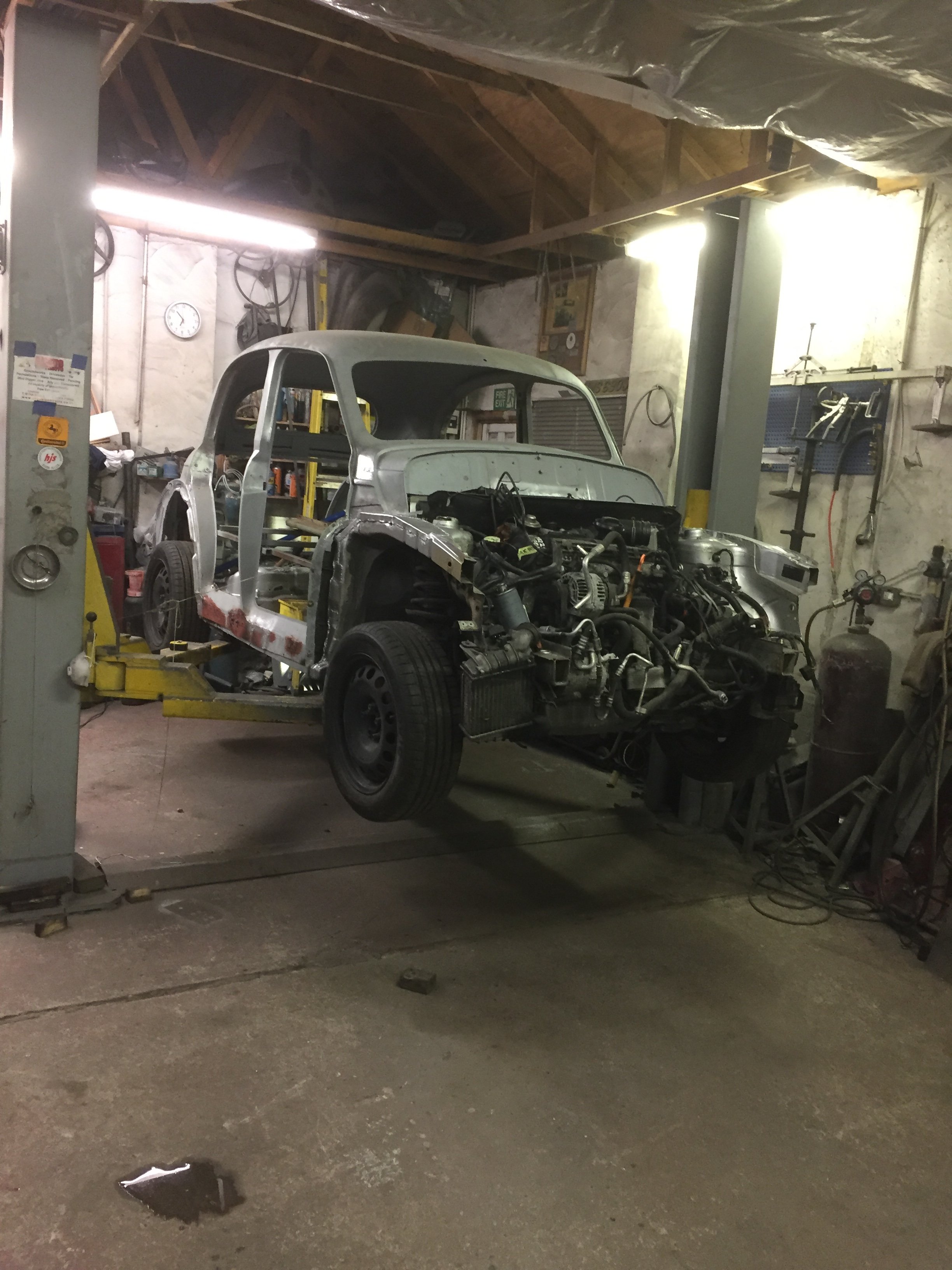

I’m a classic car builder, Morris Minors to be exact, after 30+years of restoration and modification to these cars, I craved something different... but loved the old cars.. so after much research I ( along with another partner in crime) hatched a plan.
The Morris Oxford MO is the big brother of the Morris Minor, and has the same wheel base as the Fabia...well, you get the idea..
A cat c Fabia vrs was purchased from Copart and the marriage of the two began.
Before I get burnt at the stake, the car I bought was quite severely damaged and was very close to being a breaker, so I recon I saved it from being parted out.
I’ll be stripping out the wiring loom to relocate the fuse box and BCM, the dash clocks and various other switches and stuff... I’ll also be looking at thinning down the loom and removing systems that are no longer required, eg, central locking, stereo, electric windows and heating/ ac....this will make it easier to relocate.....
I’ll be doing the electric works “live” with the loom in situ, as I did it previously with the original loom out on the work bench, and well, let’s just say I went a bit to far with the thinning down of the loom, with some hilarious results when re installed.

Now to try and get some original-looking paint?
Already bought Ken.
keeping it original “Birch Grey”

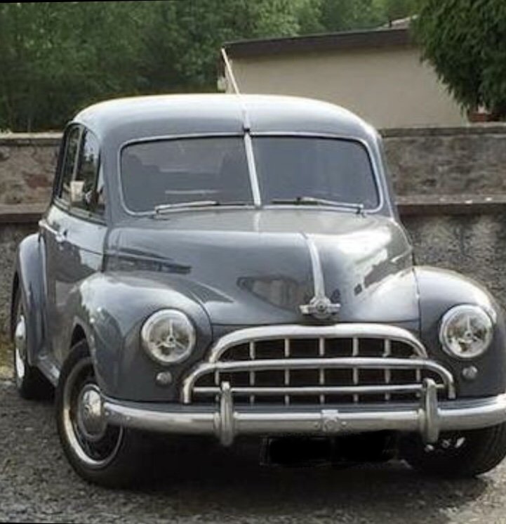

9 minutes ago, juanse_2691 said:
Original looking wheels for that sleeper look and you're golden.
here’s its brother... finished in Audi Nimbus Grey with steel wheels and centre caps..
Edited by Del-VRS
Forgot picture
That's excellent
Just now, juanse_2691 said:
That's excellent
thank you,
Yes  you are right, they are excellent.
Unfortunately not everyone shares your view..
some of the negativity we have faced from both sides of the spectrum has been quite unreal...
but if they ever had a go in one, I’m sure they would see it different...
cheers
D.

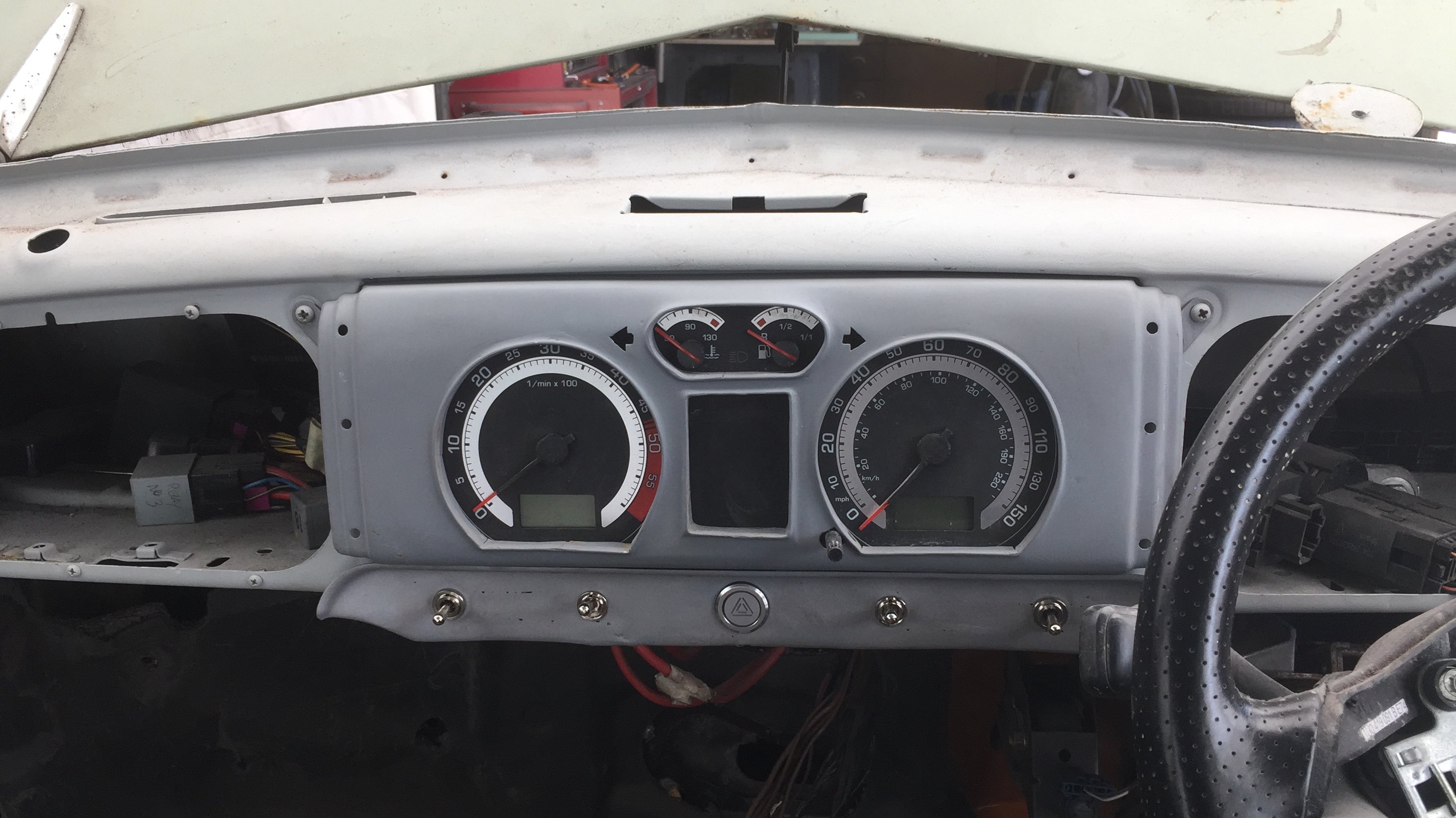

Yes, that's exactly the sort of look I was thinking of.
How on earth did you make that metal surround for the Skoda instrument cluster, or is it something you can buy?
All hand fabricated, took 4 days of my life off me that did....😂😂😂
D.
D.
I thought it might be, because I didn't see it being in sufficient demand to be a production part.
