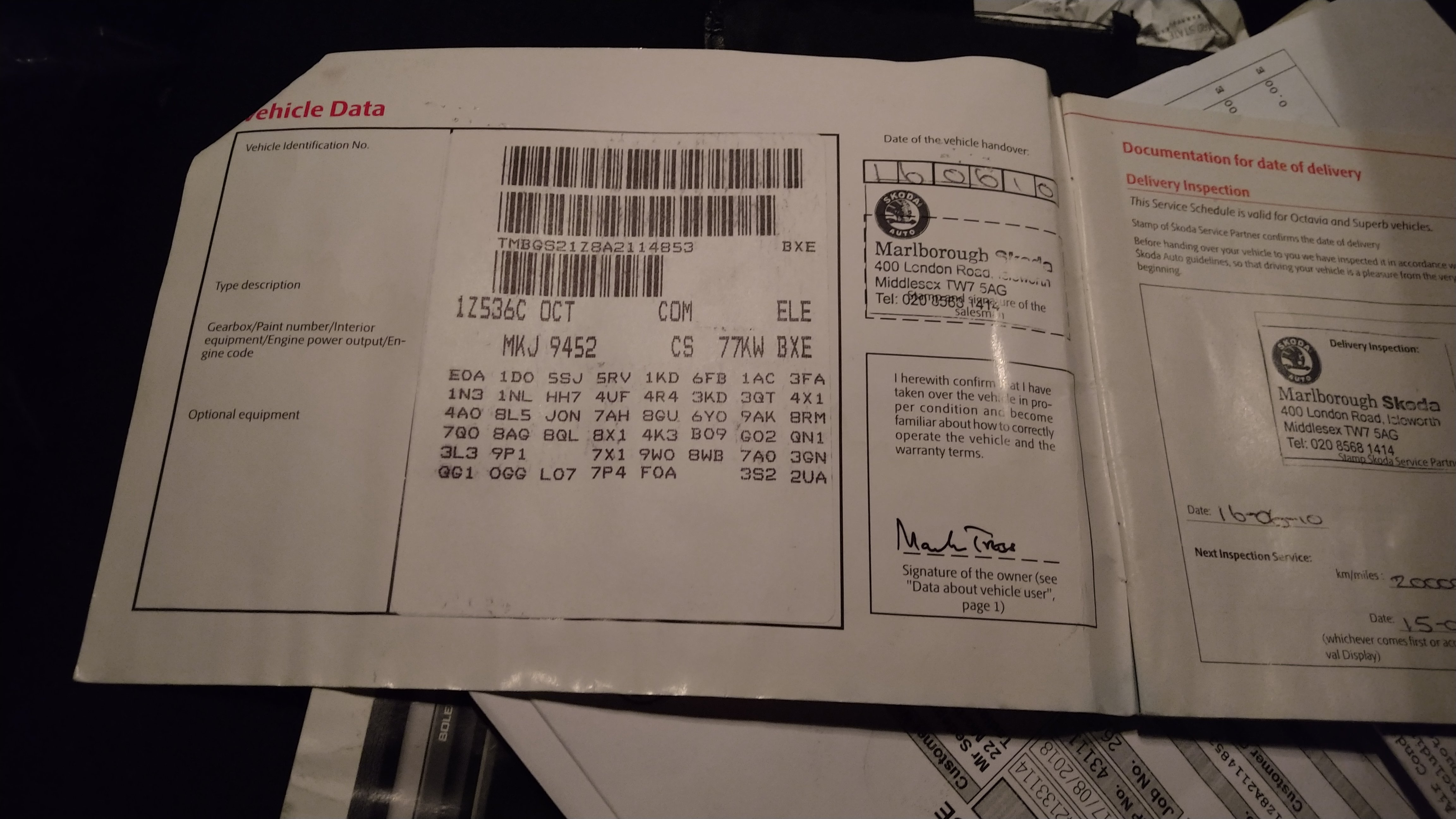

Good evening, need new discs and pads on the front. Checked PR codes in service manual and none of them match up with codes on parts websites. Anyone able to help?

I know the VRS doesn’t list the PR code on the manual, best option is to go out with a tape measure, I can’t remember what I did to make sure the pads where correct, probably just cross referenced off manufacturers websites.
@Vrsburnzymines 1.9 TDi might have to measure them tomorrow cos only codes I'm getting for part are 1ZE/F-M
It seems quite common from Skoda unfortunately
most likely to be 280mm discs but always worth measuring to double check as DSG or 4x4 models have upgraded larger discs
