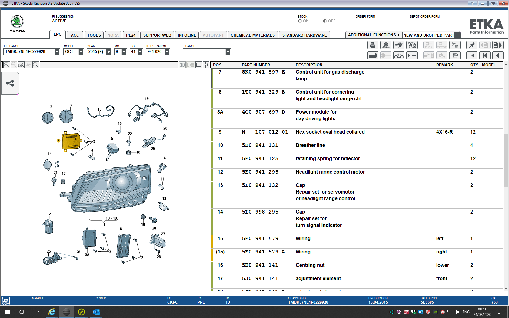

Here's what i got from Skoda when they were trying to find my issue...
I would look at anything mentioning headlight range, such as items 8, 12  & 13.
