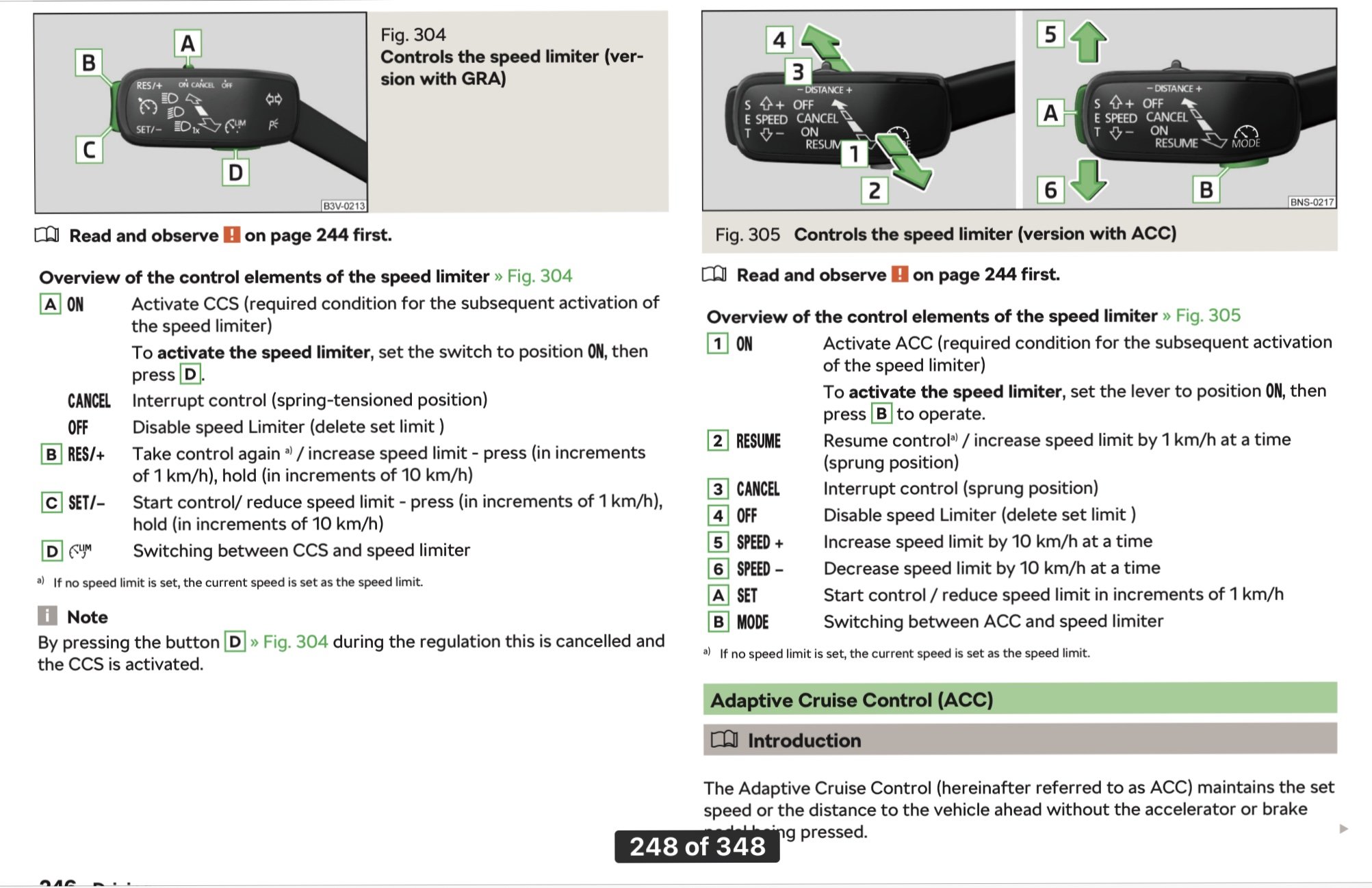

It will be something like this.
Another case of the Skoda firmware not always tying in with the book of words!
Actually, you can access this function from the Maxidot function on the steering wheel - go into "Driving Data" on the maxidot screen, go to the Speed Limit function and activate it from there.  When you go back into "Driving assist" function, you will see the tick box enabled!  Not intuitive.

Thanks for that. Will give it a try. But what exactly does this do? Is it related to ACC anyhow?
The checkbox is just there to say that Speed Limiting function is enabled; its a stupid tick box quite frankly and shouldn't really be in the ACC menu.
