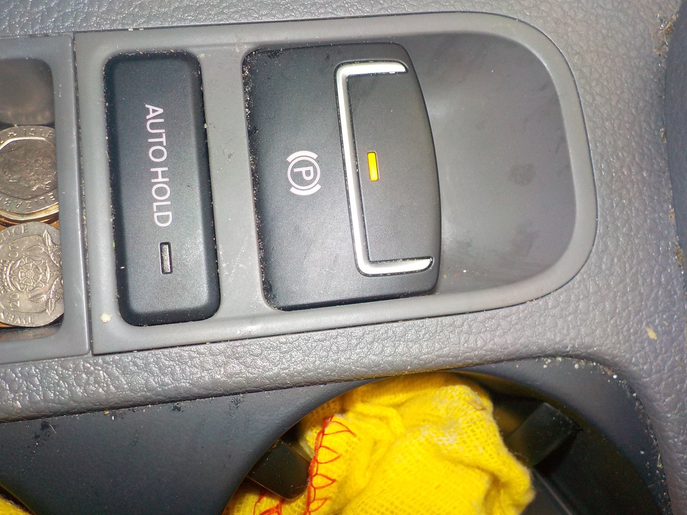

I think it's described in the handbook somewhere as an emergency stop mechanism that passengers can use if the driver becomes unwell
It is described as such.
Needs described as not fun for any passenger to apply as a joke,
or in error while trying to retrieve a coin they dropped & that fell into the space as you exit a car park / airport drop off point etc.
DSCN4731.JPG.95b7fd6aca0007c03a5da9e4fd2234fd.JPG.7560ac9ba62146d513186287a5387eb9.jpeg

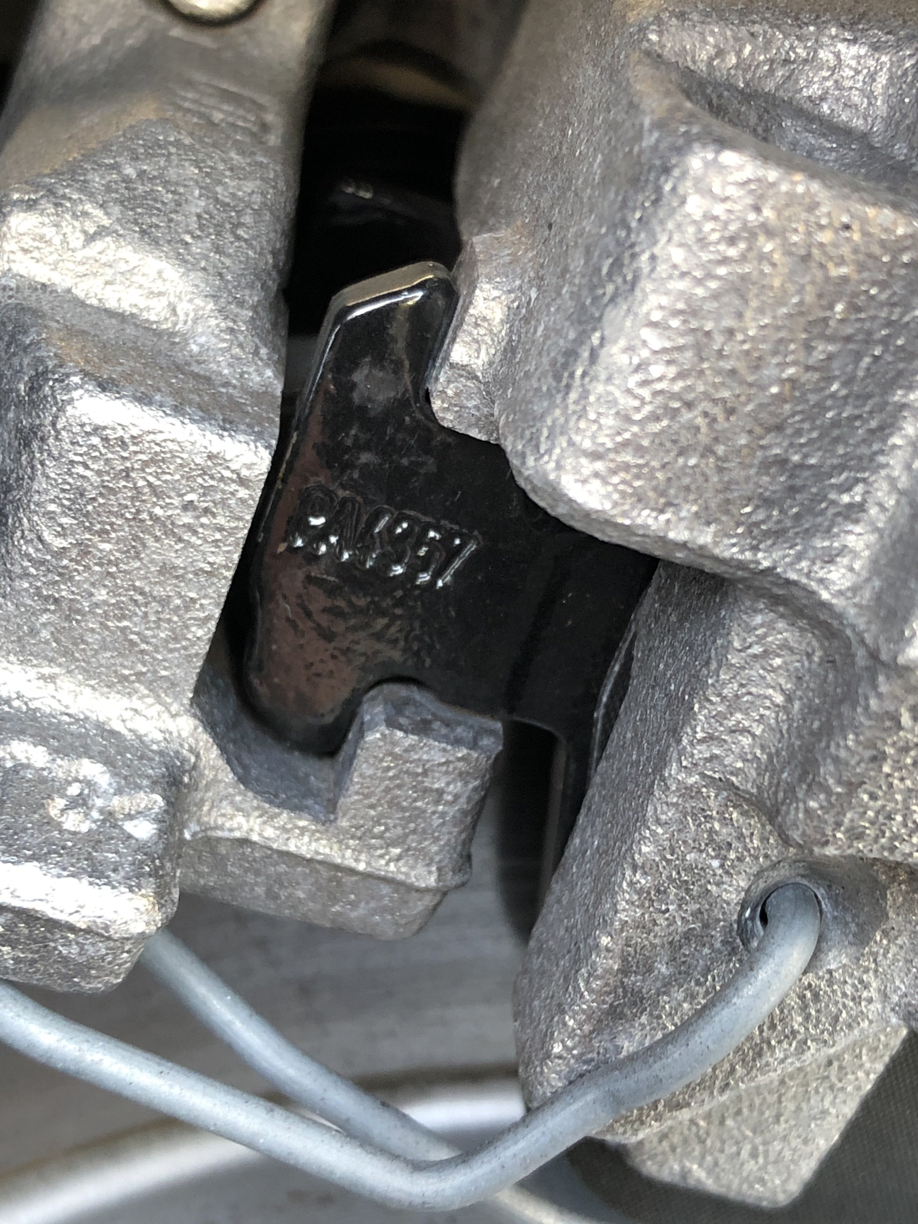

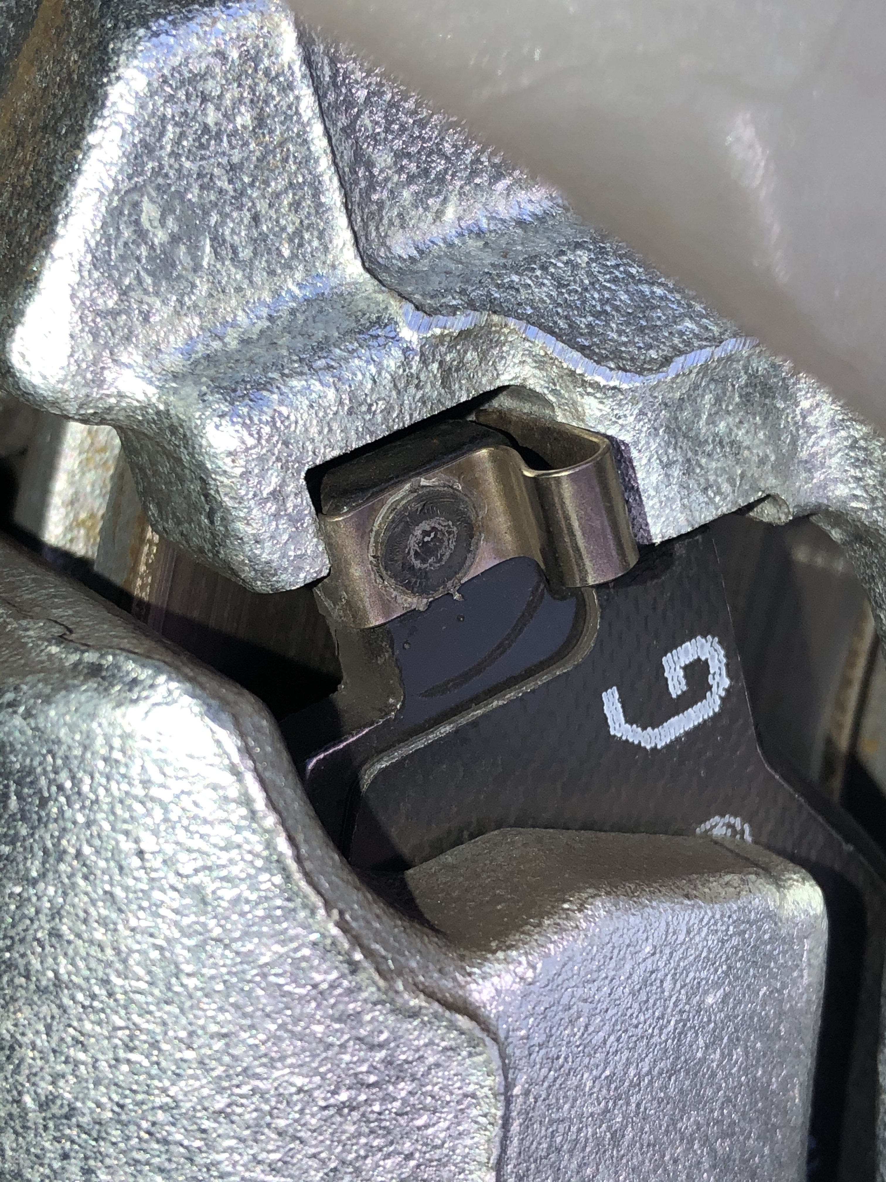

As this topic is about brakes, I’ve just noticed on my 2 week old Karoq sel that none of the brakes appear to have any Greece on the brake pad contact patches? Is this not a done thing on a new car?
can someone else with a new one post a picture so I know I’m not going mad?
heres a couple of picture of front and rear.
TIA!

Rarely fitted on new vehicles , there are anti rattle shims, damping pads and the paint on the pads is acts as an anti seize compound
Copper slip is used when fitting new pads to old calipers as this is when you're most likely to suffer brake squeal.
On a new car built in factory conditions with brand new treated /painted components there's less need for additional lubrication.
Grease can cause more problems than it cures, it the brakes get hot the grease can liquify and find its way onto the friction surfaces, not great for braking performance.
It also attracts dust, grit and dirt, another contributory factor to sticky / seized brakes.
