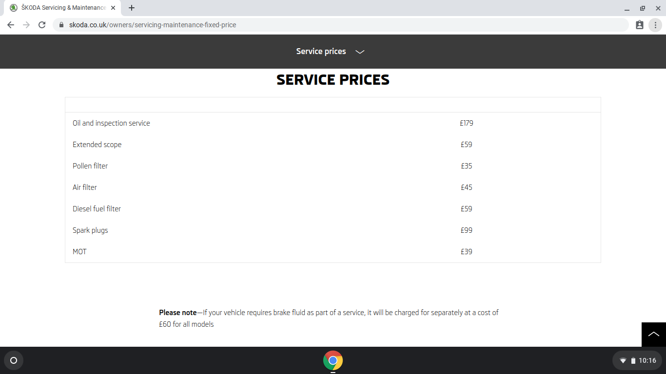

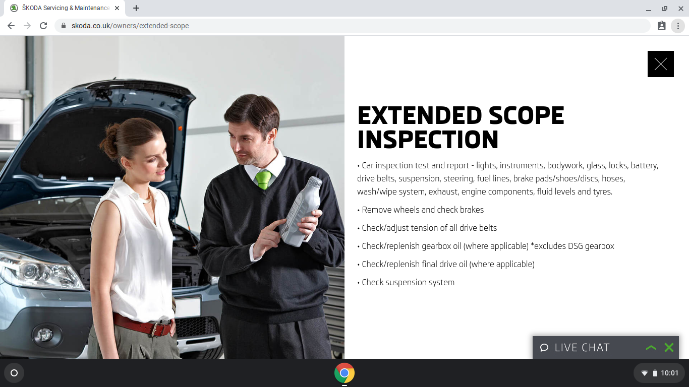

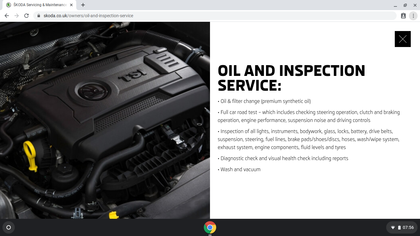

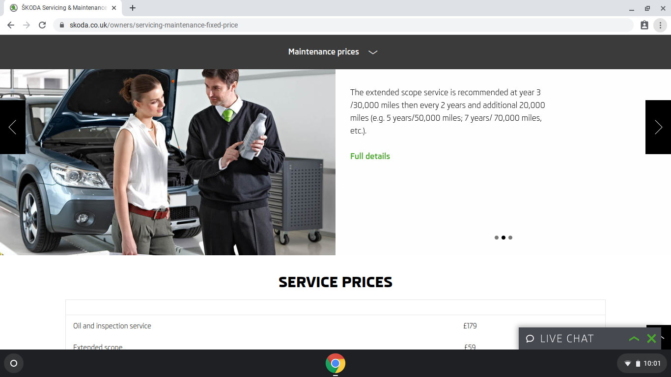

As said above, at the 4 year service, with a 1.2TSI having covered roughly 50K miles:- oil + oil filter + air filter + spark plugs - if you want/need to also replace the pollen filter - that leaves the brake fluid, it should have been changed at/before the 3 year service time, and so again at the 5 year service time.
It would be a really good idea to also get a "wheels off pads/shoes out" brake service as well.
I did the spark plugs last year. I phoned the dealer and all they wanted to do to it was oil and filter and charge me £179 plus MOT fee on top. So I've booked it into the local garage instead. 😀
