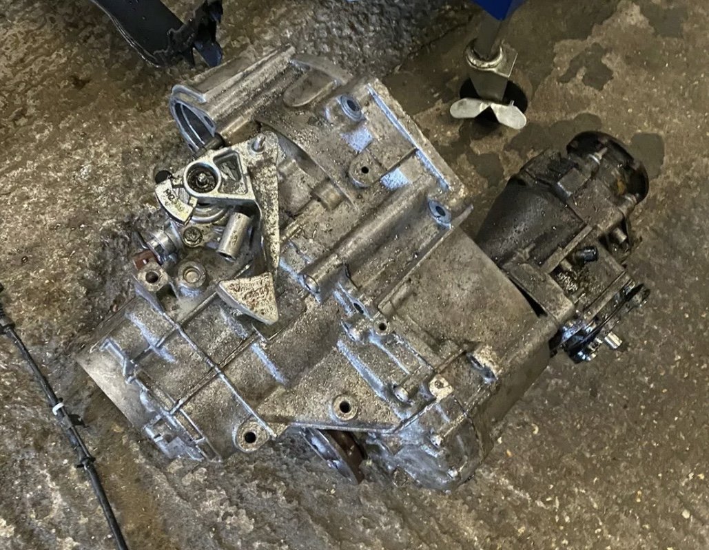

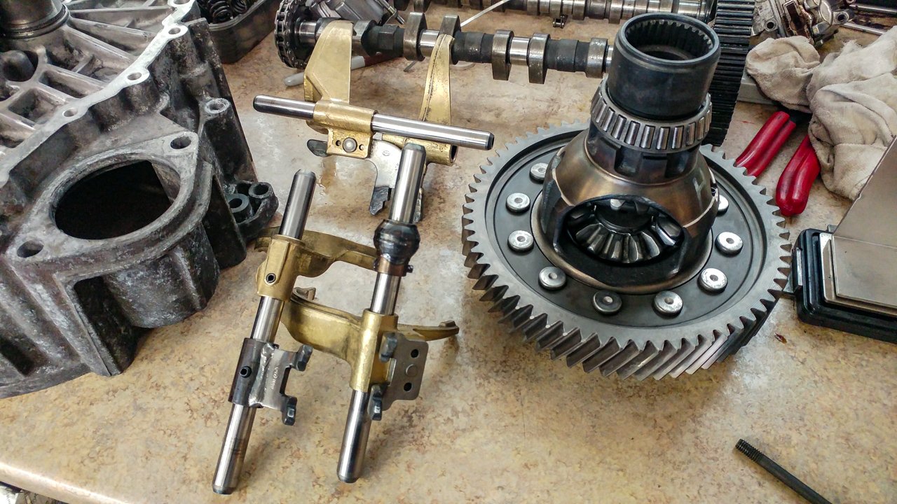

I’ve been doing more research for my 4x4 project and I found some better photos and a thread on ASN and it showed a quattro diff with the larger toothed side to the diff body that interlocks with the transfer case, then a long driveshaft goes through the transfer case through the interlocking part of the diff and into the spider gear of the diff as normal.
I believe this is the same system as the toyota celica gt4 gearbox , if u want to see it taken apart look for "project binky" on youtube.
on one of the lateste episodes they refurb the gearbox and u can see that although the tranfer case is mounted on the side of the box it gets is motion directly from the diff via a long shaft.
I’ve not seen the Toyota set up but this is the pictures from the ASN thread.
here you can see where the diff housing has teeth to interlock with the transfer box

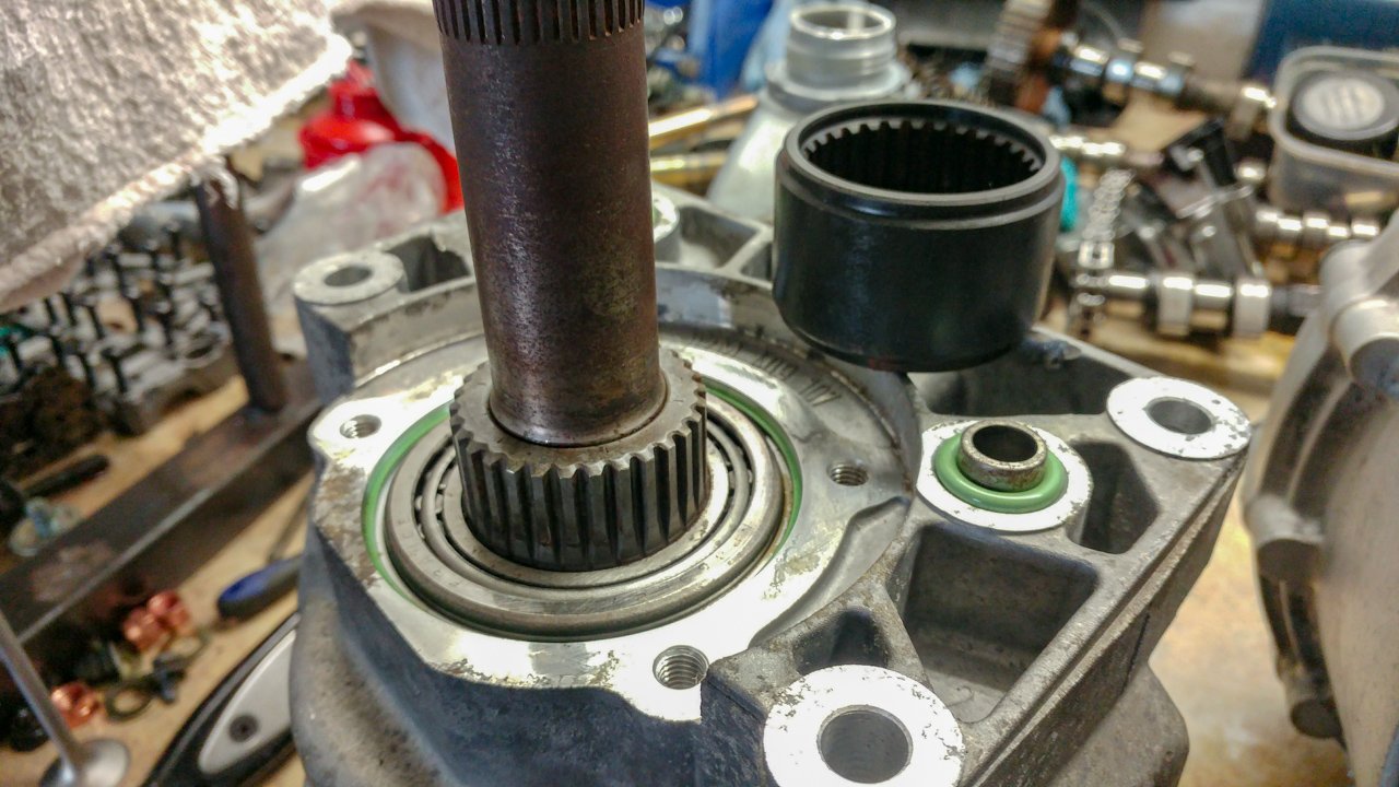

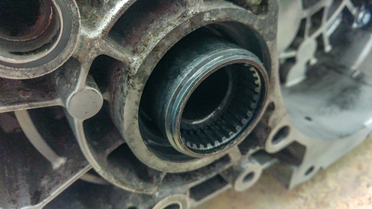

photo of diff installed into gearbox with the diff housing protruding out.
now a photo of the transfer box, the inner shaft is the front off side output shaft that runs through the hole transfer box to pick up the off side drive shaft, then larger cog at the bottom interlocks with the diff  housing and give a permeant drive to the haldex unit.
