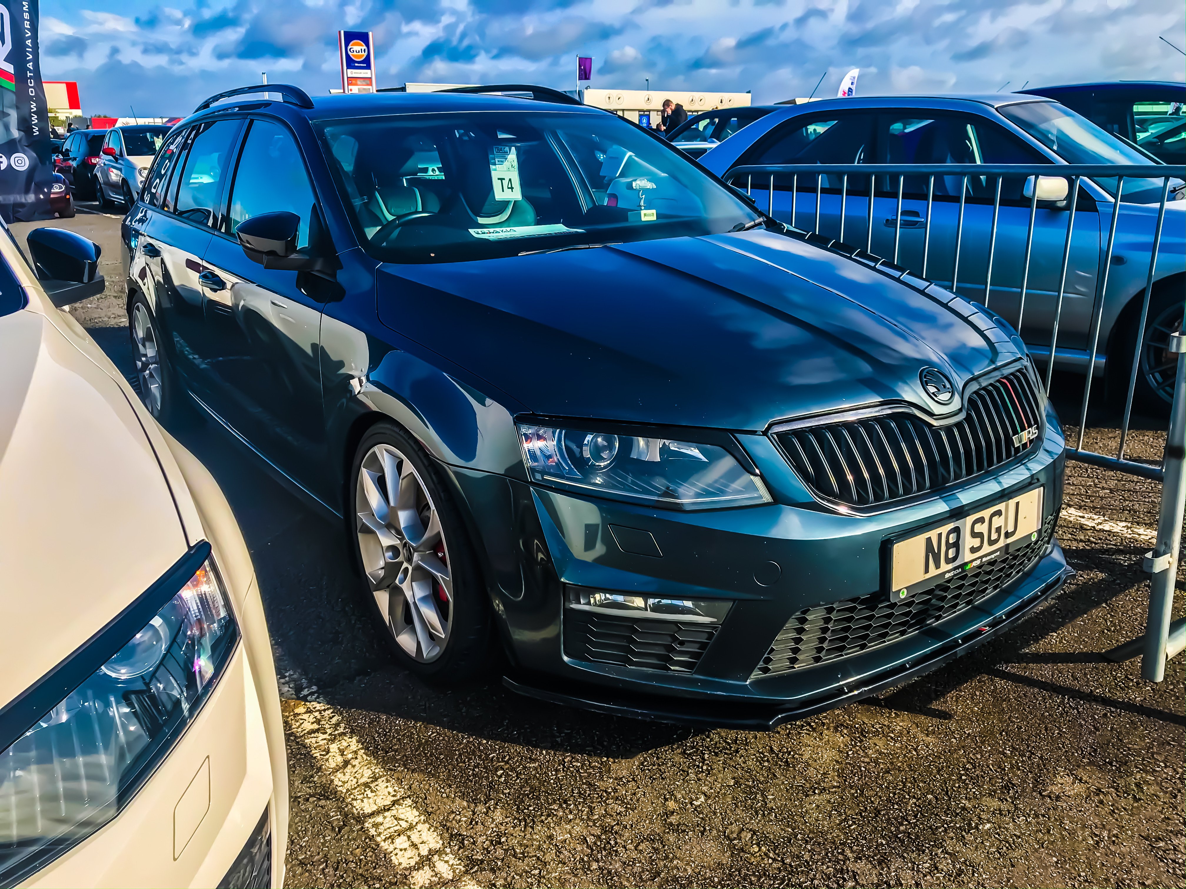

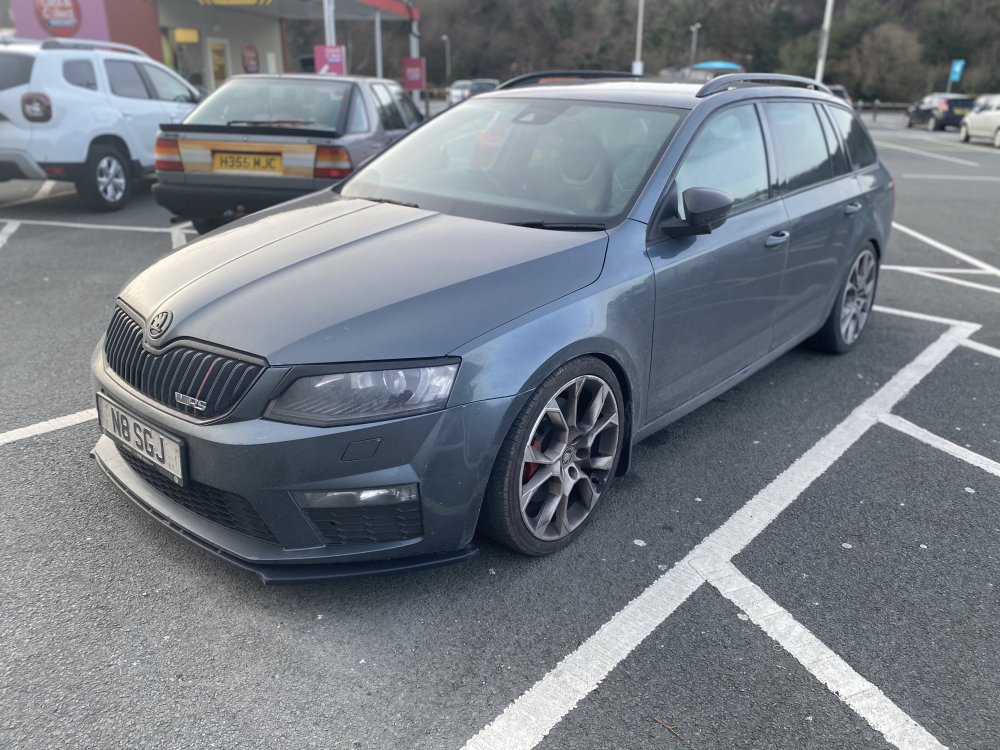

Mine is 25mm lower than a standard vRS and has the splitter. No issues with it yet, no caught splitter or bottoming out :) I am careful over speed bumps and potholes though. You can do a 30mm drop if preferred.
