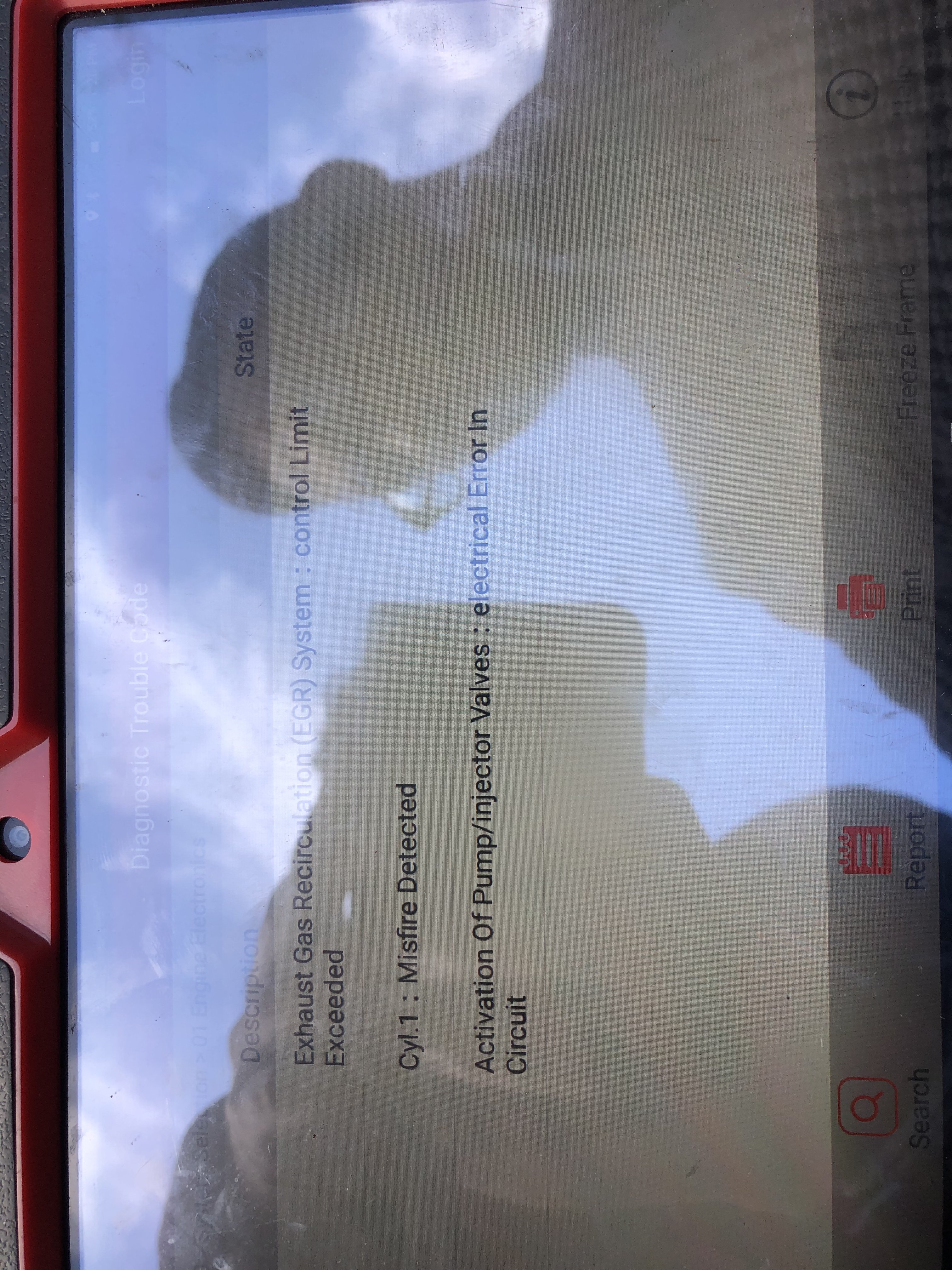

I got this, but the other 2 fault codes above that have been sorted. Just the “activation of pump” I need help with

Thankyou guys, gave it to the garage it was a major electrical fault behind relay circuit. It’s fixed now tho so happy days! Car runs a lot smoother.
