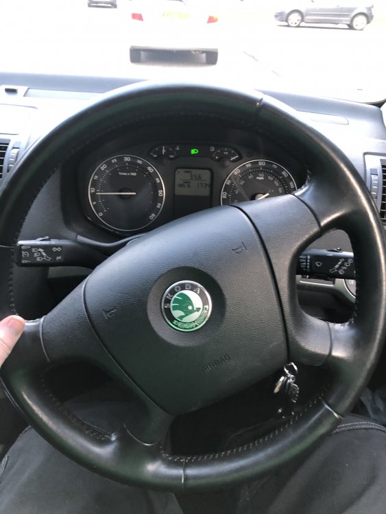

Car returned to me, for me to test drive ... now car is no longer pulling to one side, but steering wheel is severely off-centre when driving in a straight line (see picture) .. Mechanic is now thinking about taking steering wheel off (after disconnecting airbags etc) and realigning / straightening it up that way.

You need the road wheels aligning ...........fronts at least but ideally all four.
The steering wheel will be placed in the straight ahead position and then the road wheels require adjusting to recommended alignment settings.
No idea why it went out of alignment unless someone along the way has kerbed it or something has been adjusted that shouldn't have been, or something like that.
Edited by Tilt
Did he have the engine running when doing the alignment as I’m not sure how the electric rack behaves when being pulled about, but I found you get a more precise alignment with the engine on and running as it takes some slack out the system, and I’m guessing he had the steering wheel locked off at 12 o clock?
I’d make sure you find the center of the rack first, engine on and go from lock to lock counting how many turns it takes, then turn the steering wheel back to the middle and this is where you need to center your steering wheel.
If the wheel is already centered then he needs to check his wheel plates are moving freely when adjusting the toe, and try again with the alignment 👍
I had to sort my s6 out as my rack was off centered, I had to find the center of the rack, use VCDS to fit the steering wheel at 0* and then get the tracking done so it didn’t upset the ESP and ABS.

All sorted now.  As you both advised it was the wheel alignment that was way out - the 2 rear wheels in fact.  The tyre place said it was because the rear coil spring had been replaced, so maybe something to bear inn mind for the next time.
Initial suggestion from the tyre place was that it was the Steering Angle Sensor, but this was quickly ruled out.
Cost me £72 for all 4 wheel to be aligned, but the steering wheel is now perfect, and my Octavia actually drives so much smoother as well !
