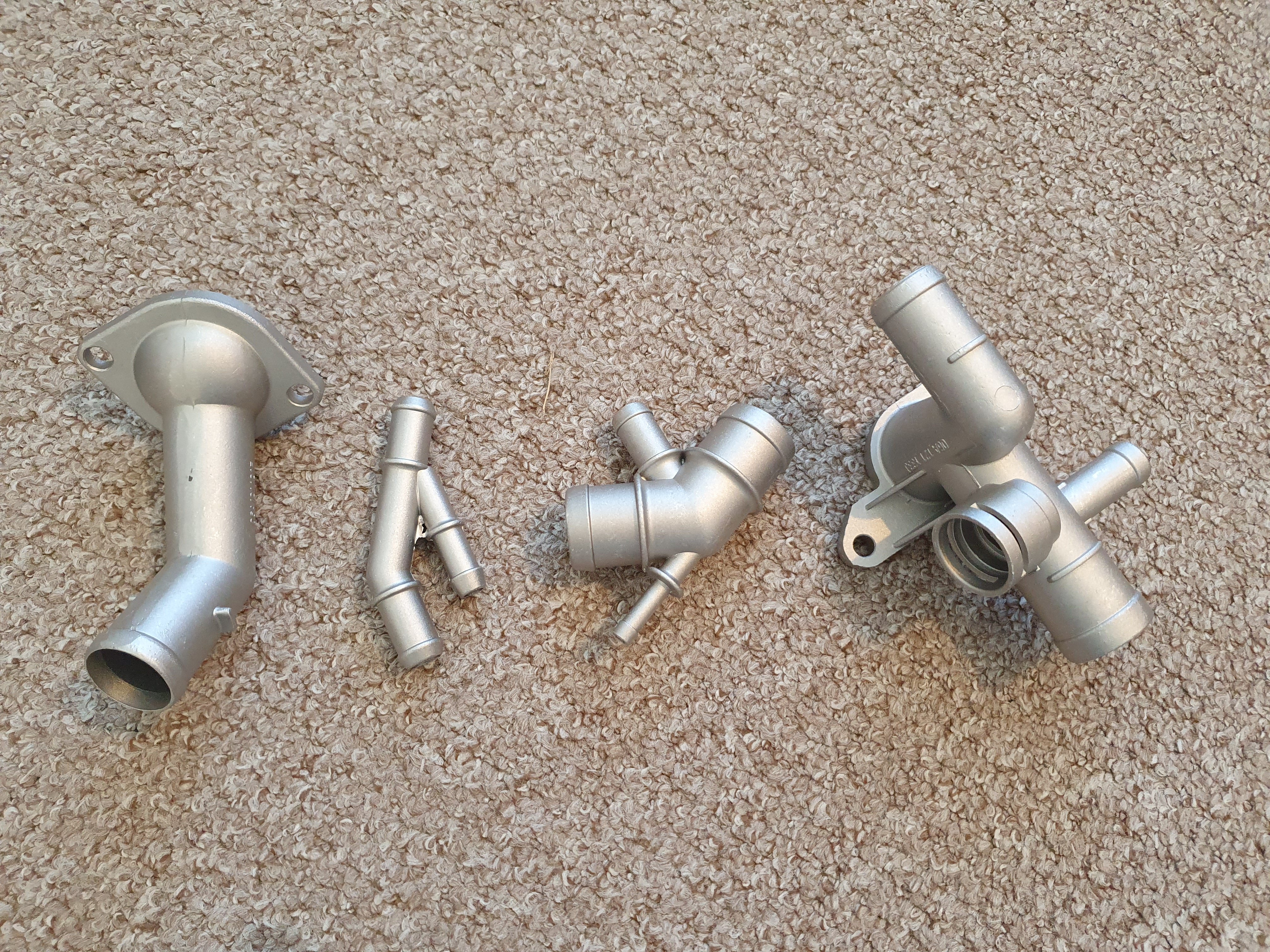

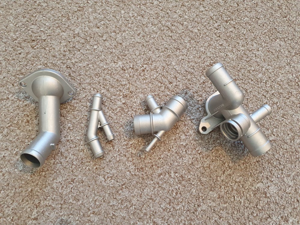

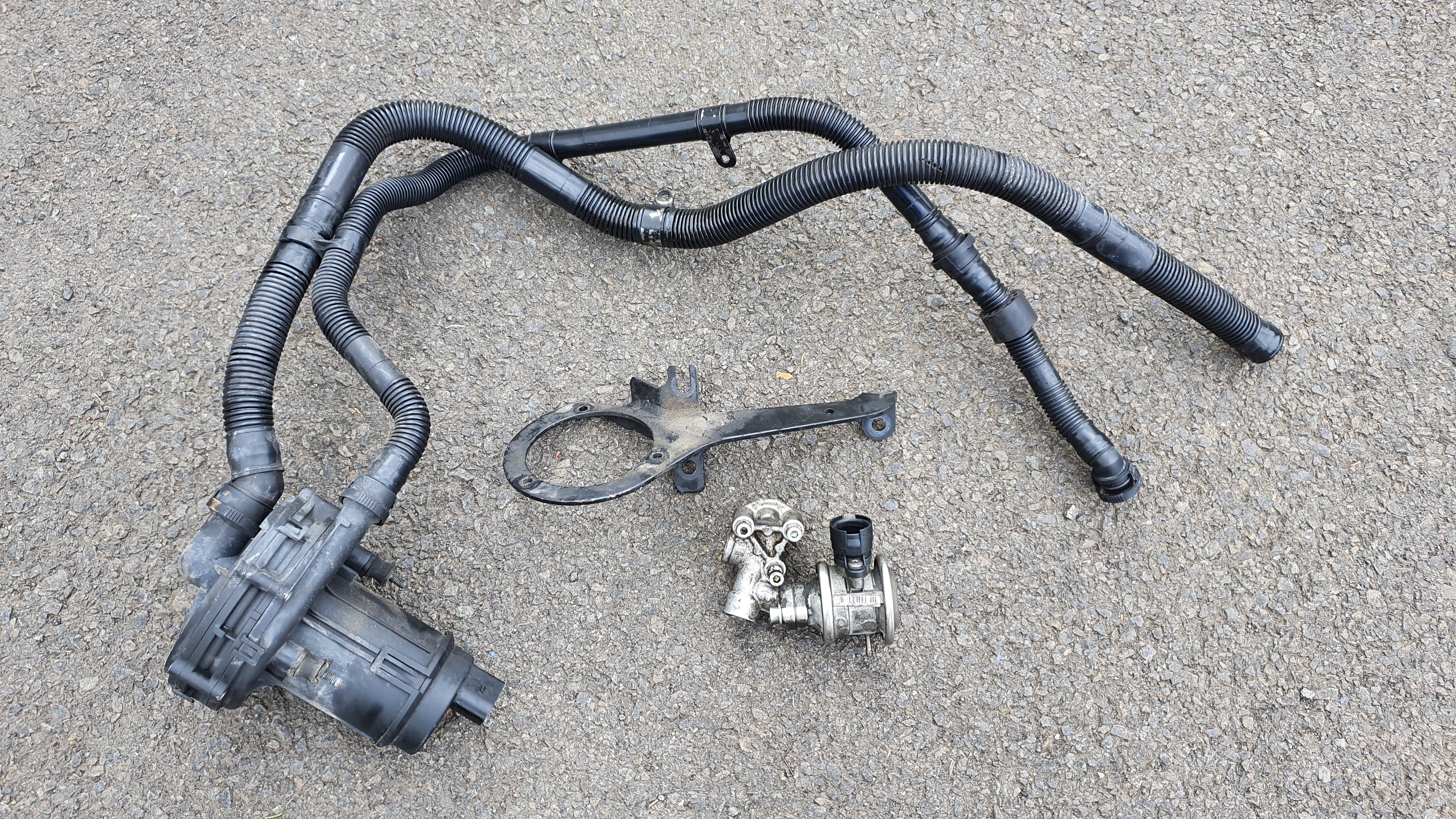

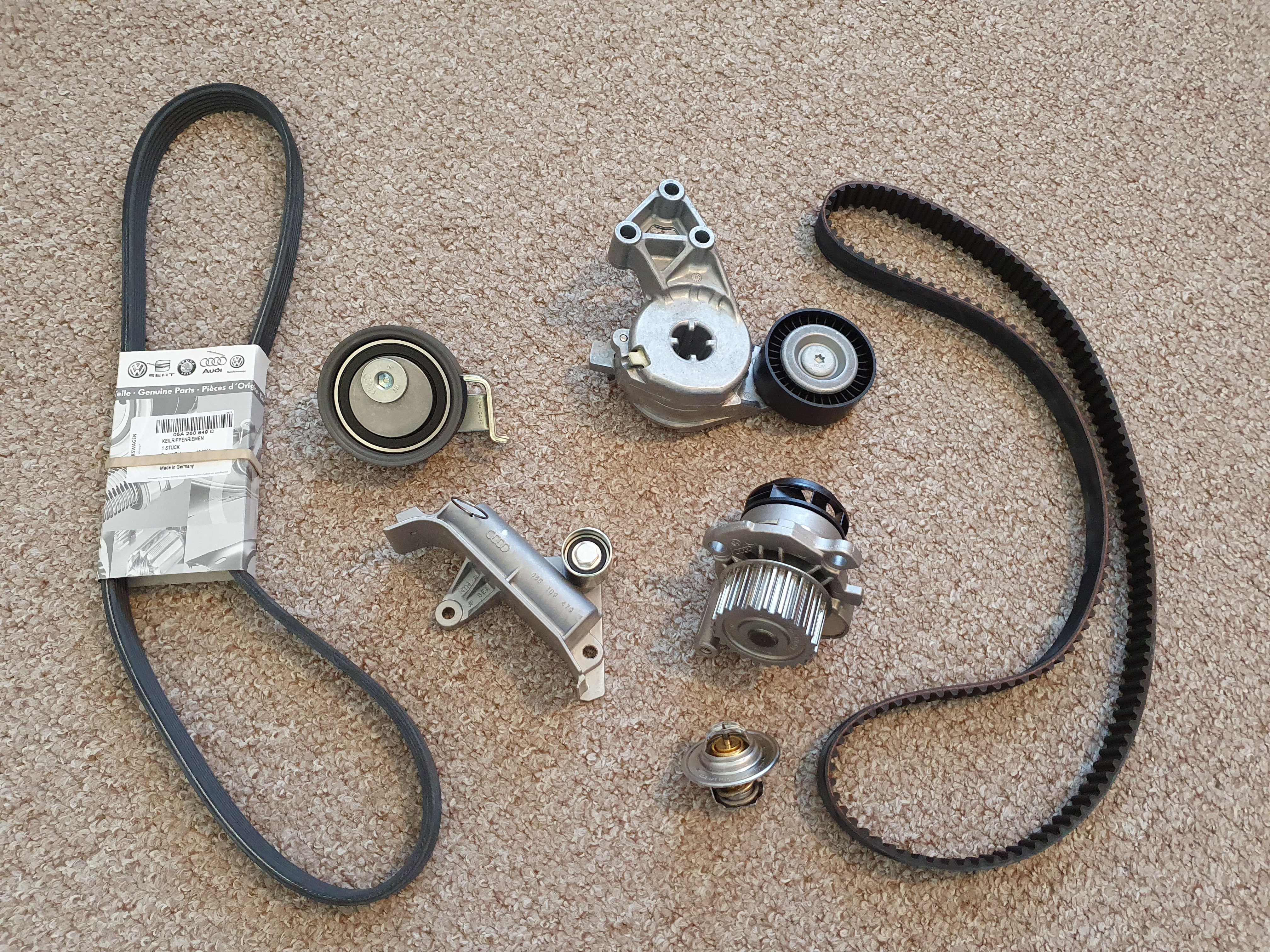

Hi there, thought I'd better update this thread. Decided to go all out and replaced the timing belt and water pump, along with the tensioners and auxiliary belt. I also replaced the plastic water pipe connections with alloy ones, removed the SAI and fitted a new thermostat. The car now sits at 90°C with no fluctuations.
