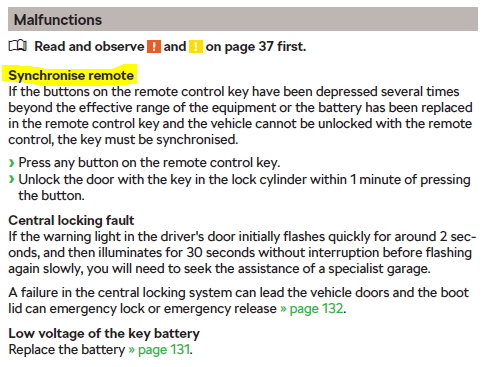

I might be wrong, but you may have to re-train the ECU (or BCM - whatever the relevant compute-device is called on a Citigo) to recognize your key. I think the procedure is in the manual.
It is, on some cars at least, often as simple as putting the remote key in the door lock and holding one or more buttons for a few secs..

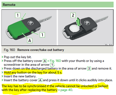

Still no joy.    Handbook and U-tube show several fix routines but nothing works.

I've got 2 of the correct battery and they both flash the red lamp, that and the fact it failed immediately after a main battery swap lead me to believe its not that.

Finally disconected a battery lead for a minute or so but to no immediate effect.   Later that day I manually unlocked and subconsciously noted a change in the LED activity.   I performed the fob reprogramming routine yet again bingo, and it worked.
