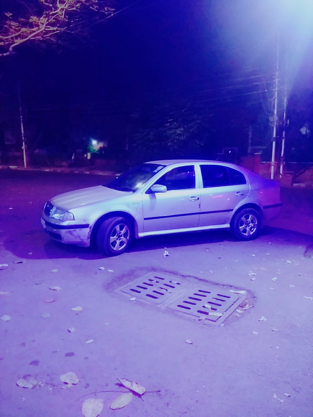

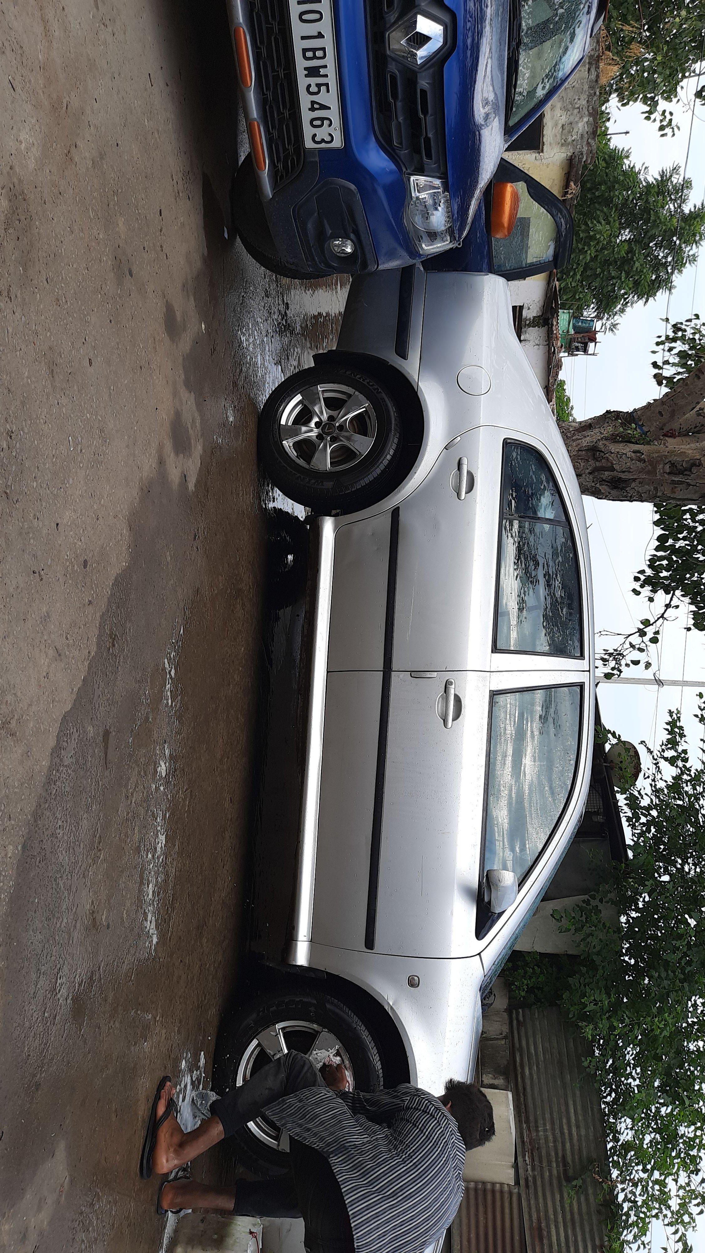

Hi All,
I own a Skoda Octavia 1.9 Tdi Classic Rider, last month i got involved in a tragic incident with my Octavia, I went for Air Pollution check & there while performing the pollution check the operator was revving engine to higher RPM & it lead to the diesel engine runaway.
The car went crazy for a minute after burning the fuel. Turns out the Turbo was faulty, so i thought probably engine would have survived, So changed the Turbo only & after that the car was not starting up, So i had worked on rebuilding the engine with new Pistons, ring everything's faulty parts were changed & engine rebuilt. After completing all the work. The car was starting after few seconds it stalls if left idle, or stays fine on pressing RPM. After that mechanic messed up the vacuum pipes & worked on the cleaning the injectors.
After that fixed all the vacuum lines & tried again turns out the car won't start again.
Probably i think diesel pump is the faulty, please correct me if i'm wrong.
Thanks in advance.
