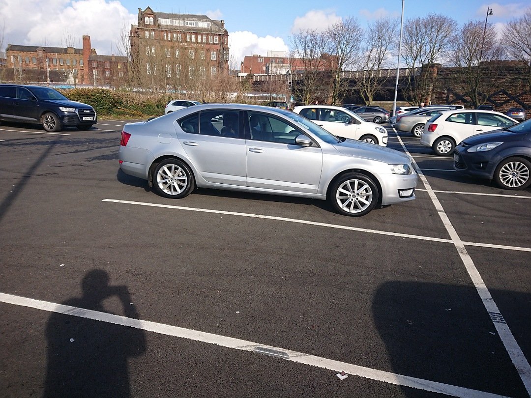

Anyway, I have a 2016 octavia SE estate, 1.6tdi.
my car has the standard 16” alloys. I’m currently looking at buying a set of Audi rims on eBay but I’m not entirely sure they’d fit. Will they be too wide, perhaps interfere with the wheel arches?

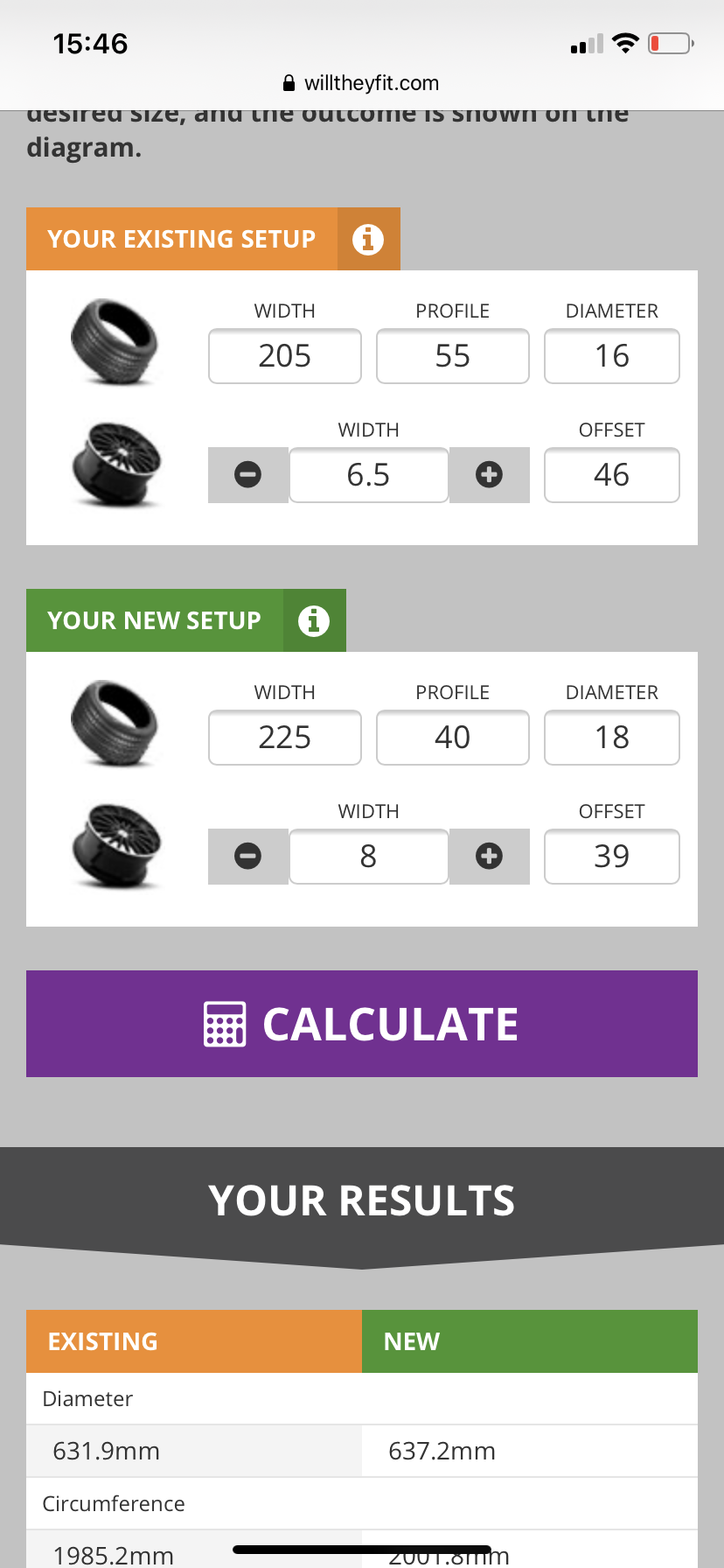

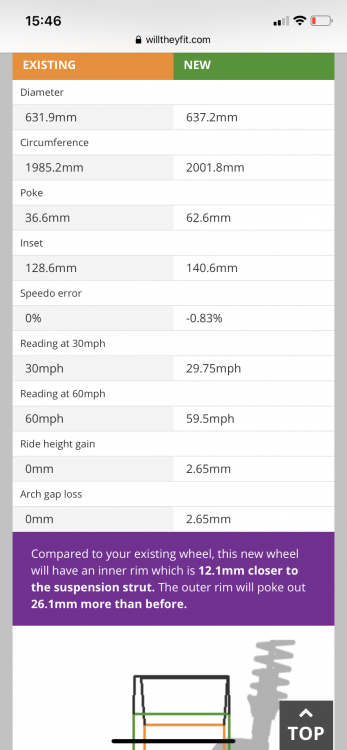

photos attached are of my exhausting dimensions and the new wheels.
id appreciate any advice/help

It might be helpful to see if any one could lend you a wheel to see if it fits without rubbing, or at least asking the seller if ypu could try one before you buy them.

That is the standard tyre size for 18" wheels and I have seen 8x18 et 41 on an Octy 3 and there is way more than 2mm clearance on the poke.
That will be no problem at all
