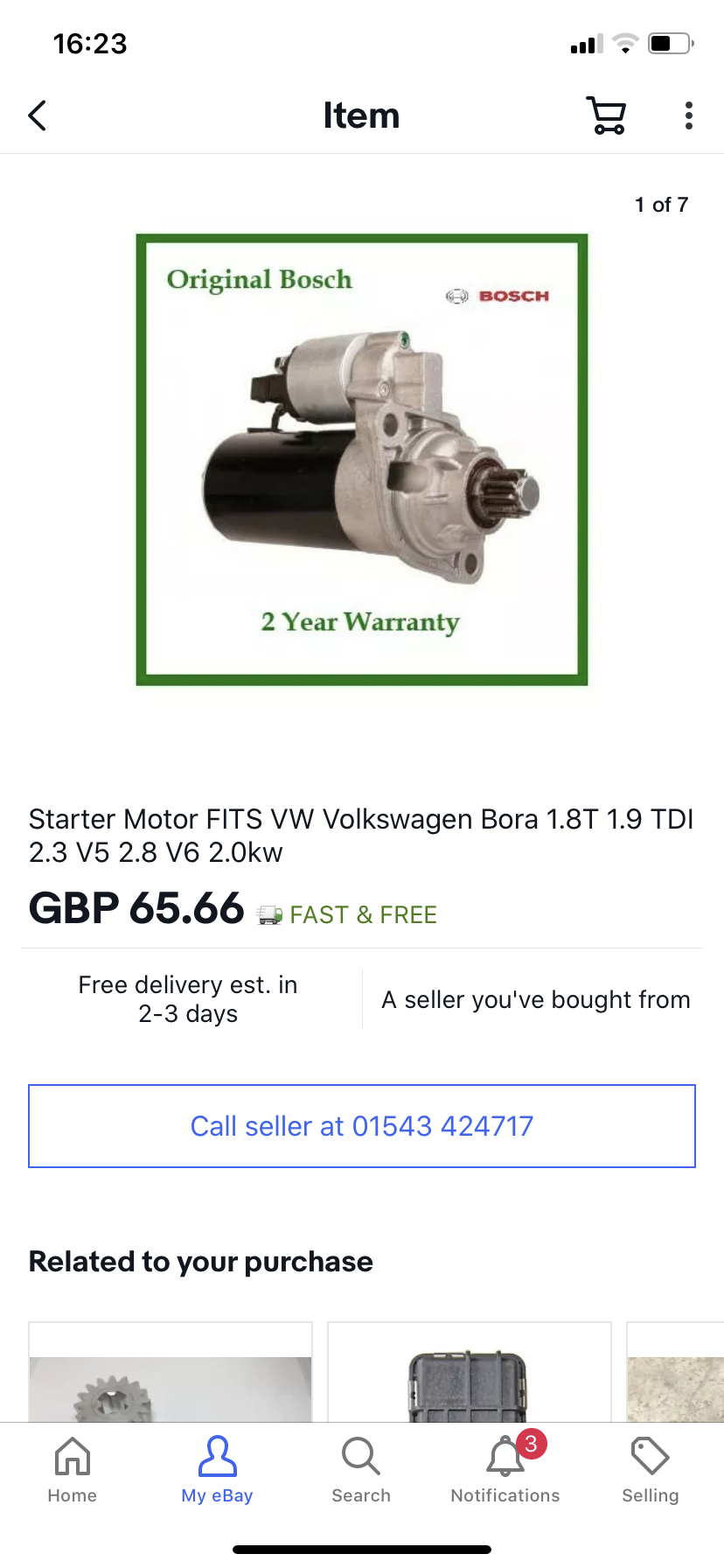

Alright. Pal, are you 6 speed yeah? If so search this on eBay for refurbed unit I’ve got on line with 2 year warranty the type is T00218
