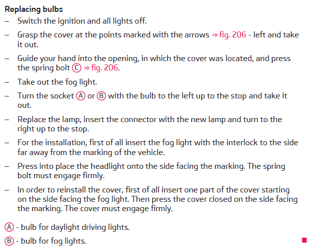

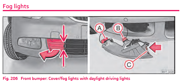

It pulls from the outer edge the side closer to the number plate on both sides. There was a bit of swearing when it gives, as you catch your hand somewhere when it pops. Then the lamp unit has a clip as you can see in the video
Warm them up with a heat gun, or if the wife is preoccupied, her hairdryer.
