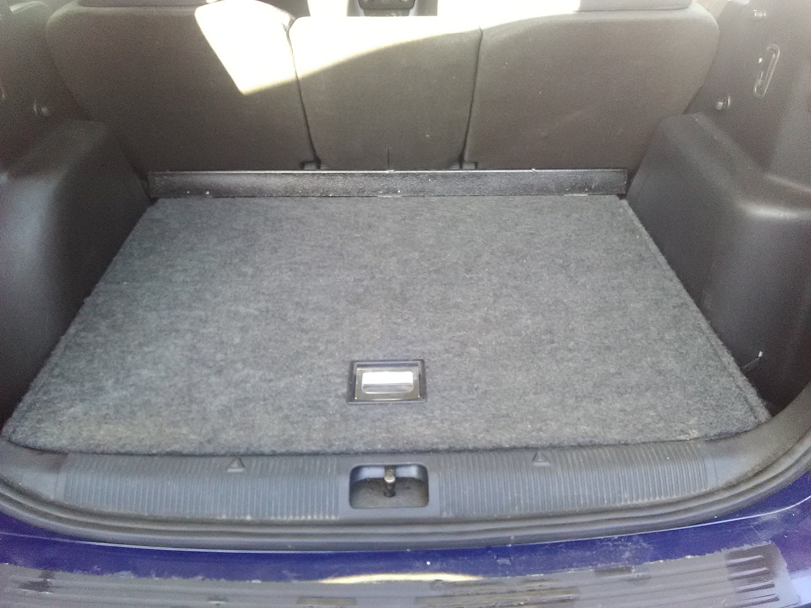

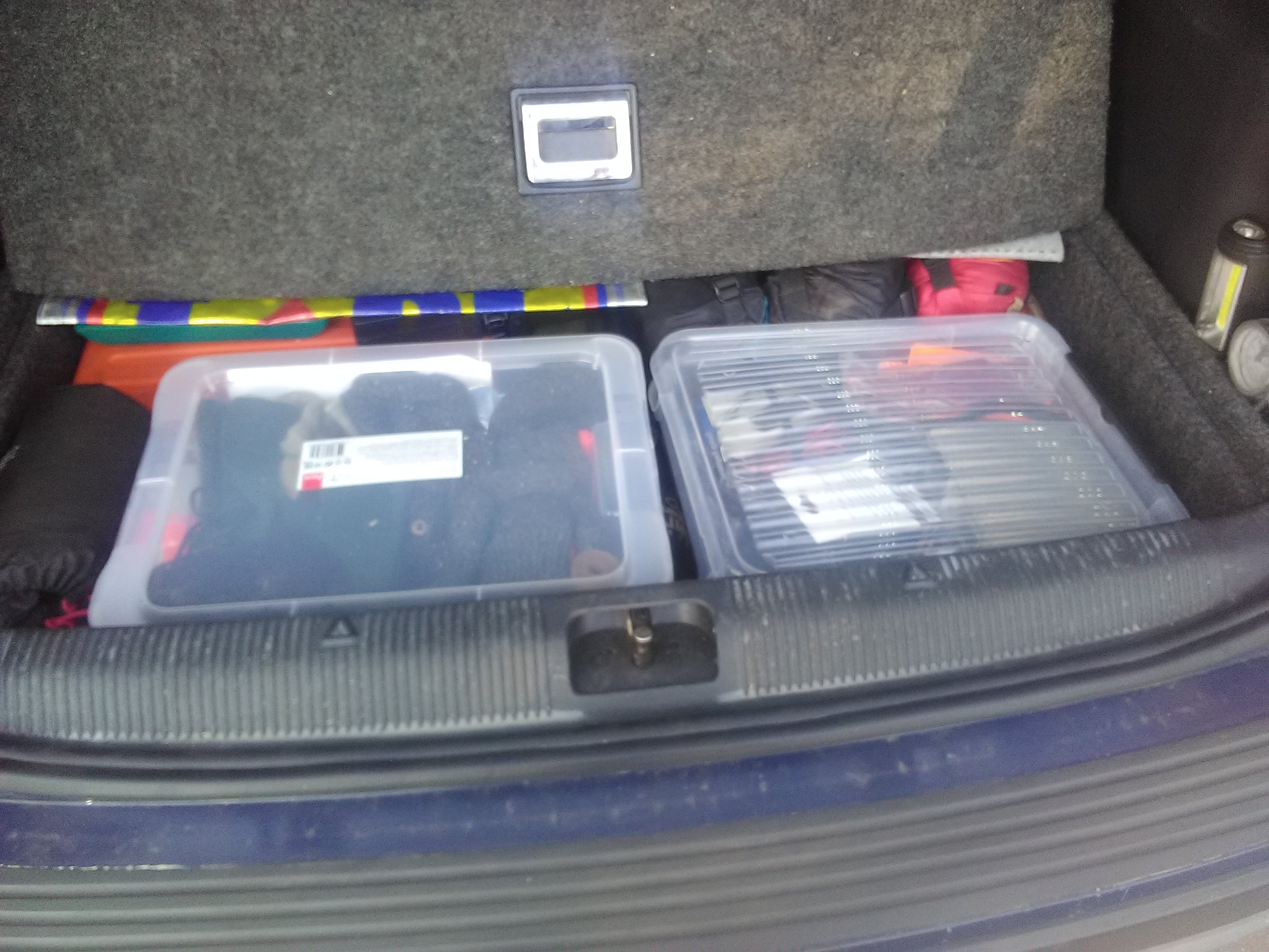

The variofloor I modified one from a MK1 Octavia, cheap & plentifull & will also fit a MK2 with little modification, I started a seperate thread but here are a couple of photos anyway which show the plastic storage boxes contained within, you can squeeze a lot more small items in these than loose in the area and they can be lifted out quickly to access my toolkits further forwards or the jack etc.

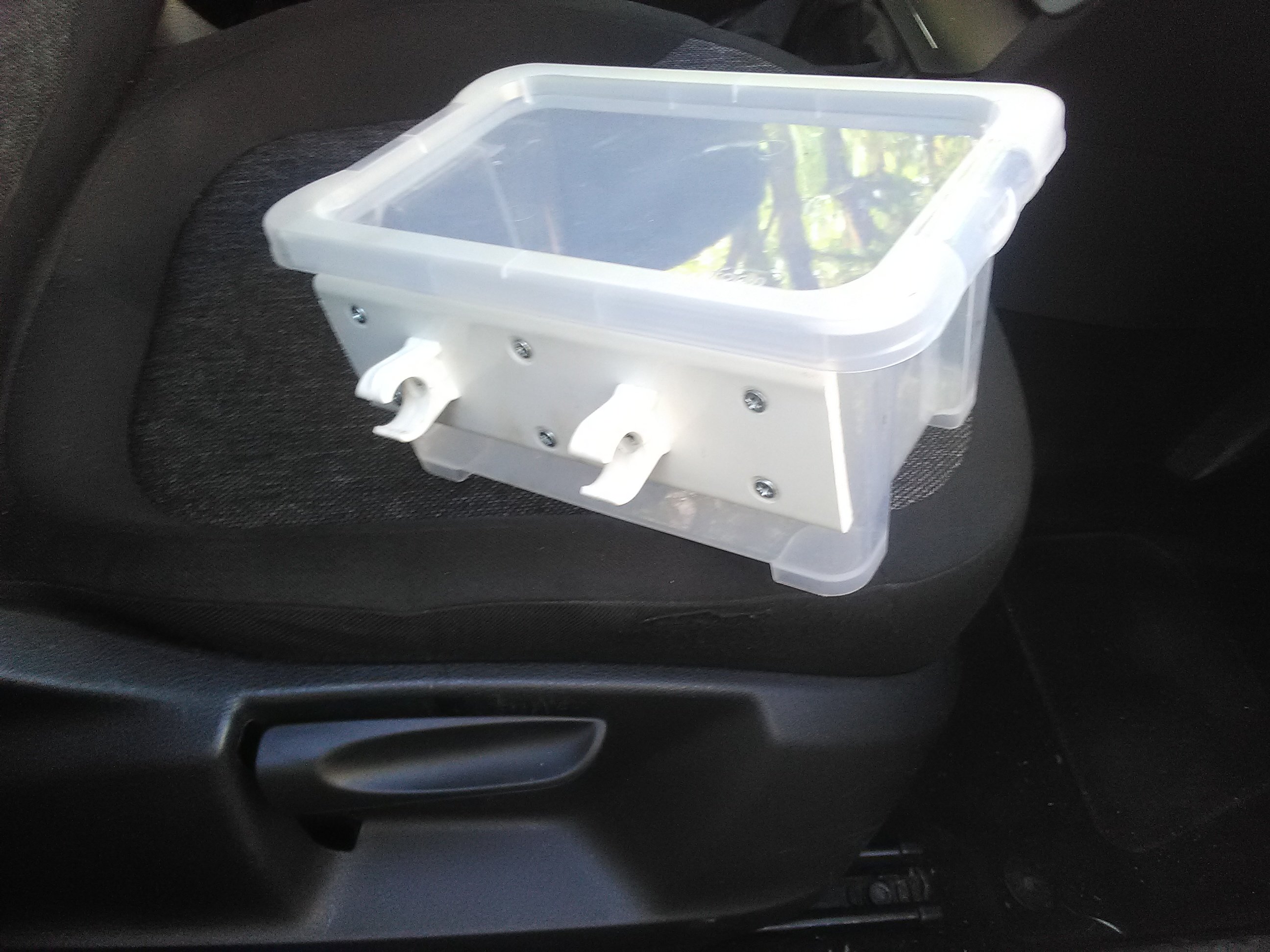

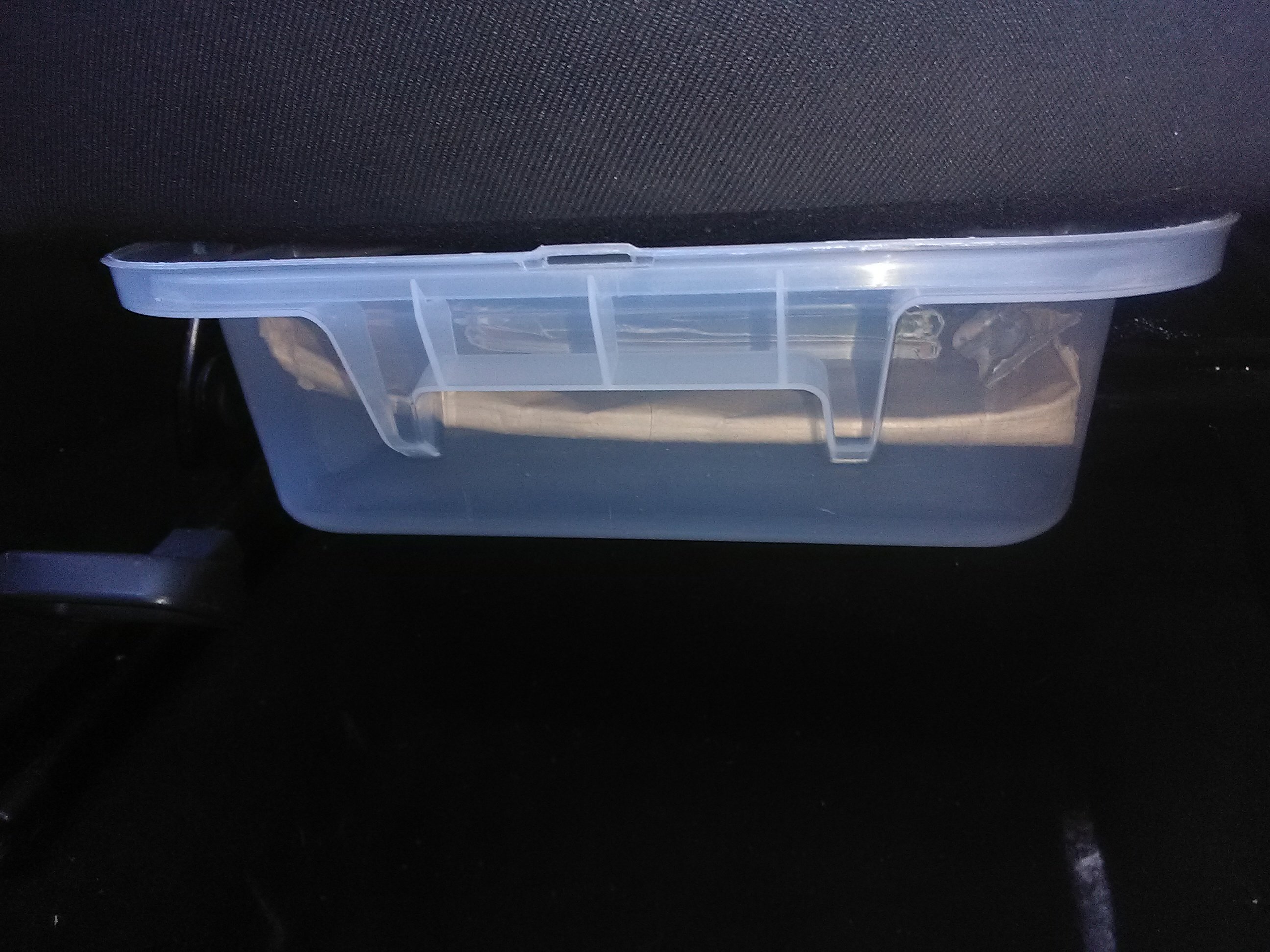

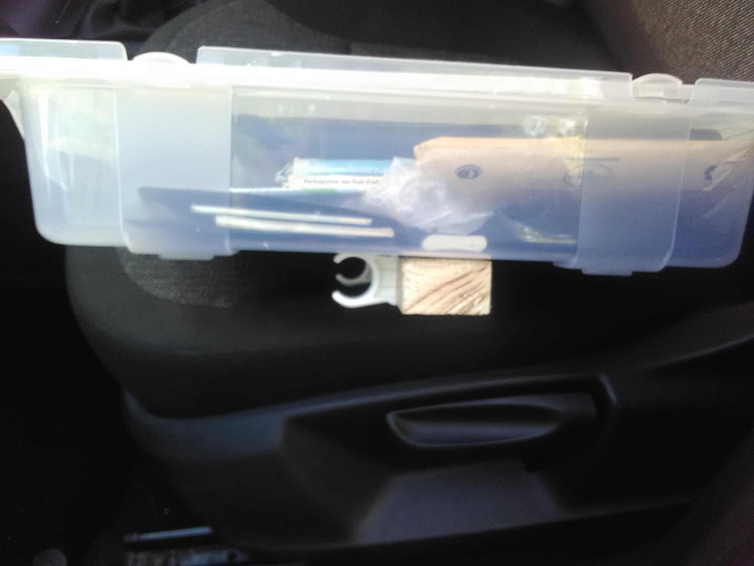

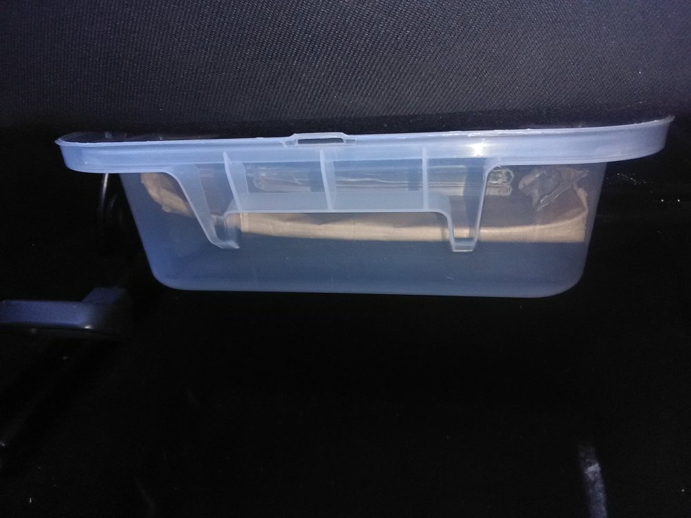

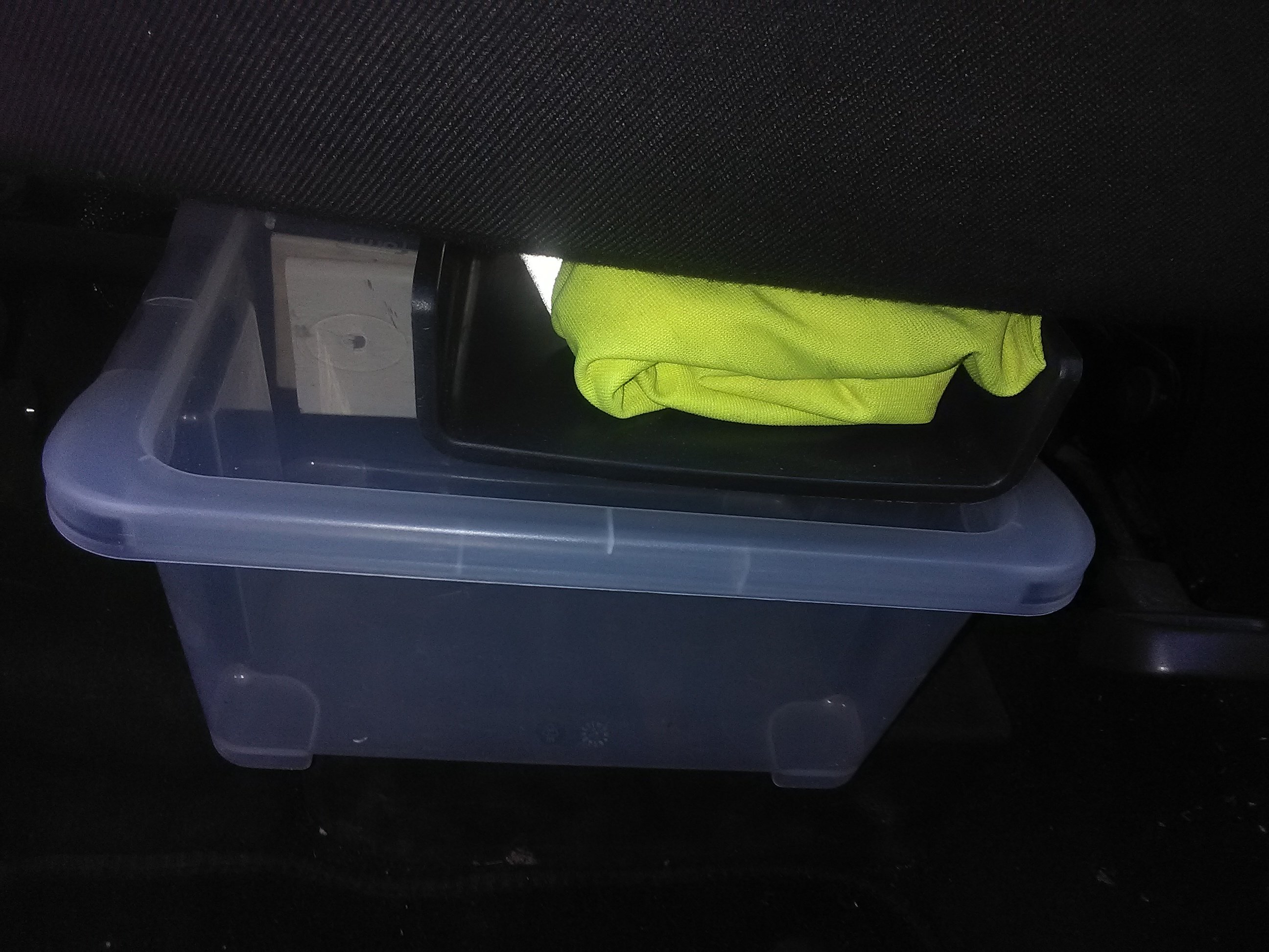

For the underseat storage I again used household plastic storage boxes that could be clipped in place under the seats, be invisible unless you lay down in the footwell, that would slide back & forward with the seat and not hamper the height adjustment, finally they can be removed to rummage through in better lighting, the smaller one is because the car currently has a bluetooth module which I will remove as the new head unit has that function.
You will see that they simply clip into place on the underseat frame rail using 22mm copper pipe clips
Edited by J.R.

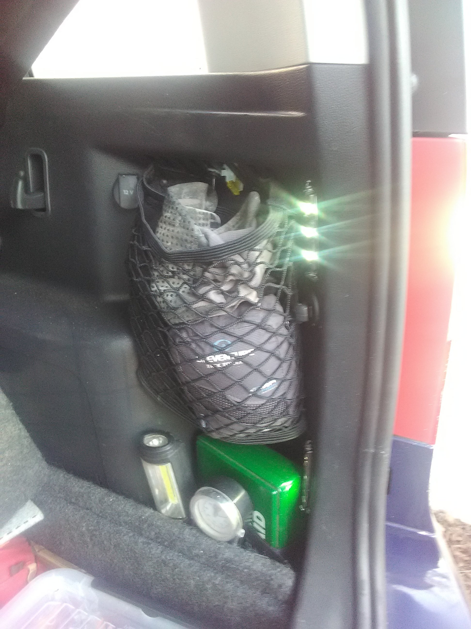

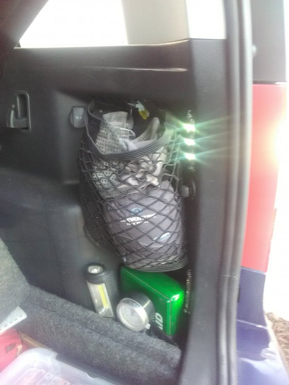

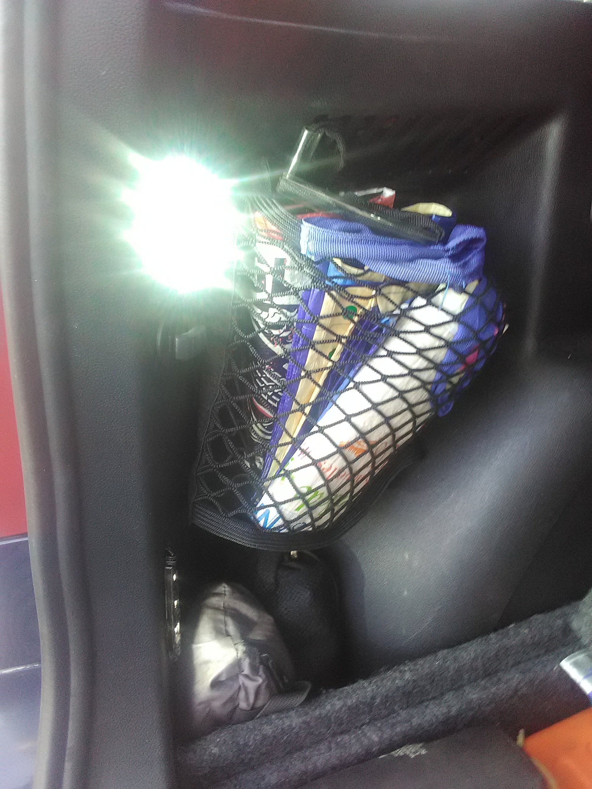

The the vacant spaces at the side of the boot were made useable by using plastic cargo nets from Ali-Express, you should also be able to see the 12v LED link lights that I have used to light up the whole area including above the parcel shelf, they come in a string of 10 with 3 bright LEDS on each one and can be used individually, they cost next to nothing.
Just realised that you can just make out a toggle switch and fuse above the storage net on the RH side, the switch is to disconnect the trailer wiring module which adds to the parasitic battery drain and the fuse is the one that protects all the trailer lights, better to have them both accessible and visible.
Edited by J.R.
