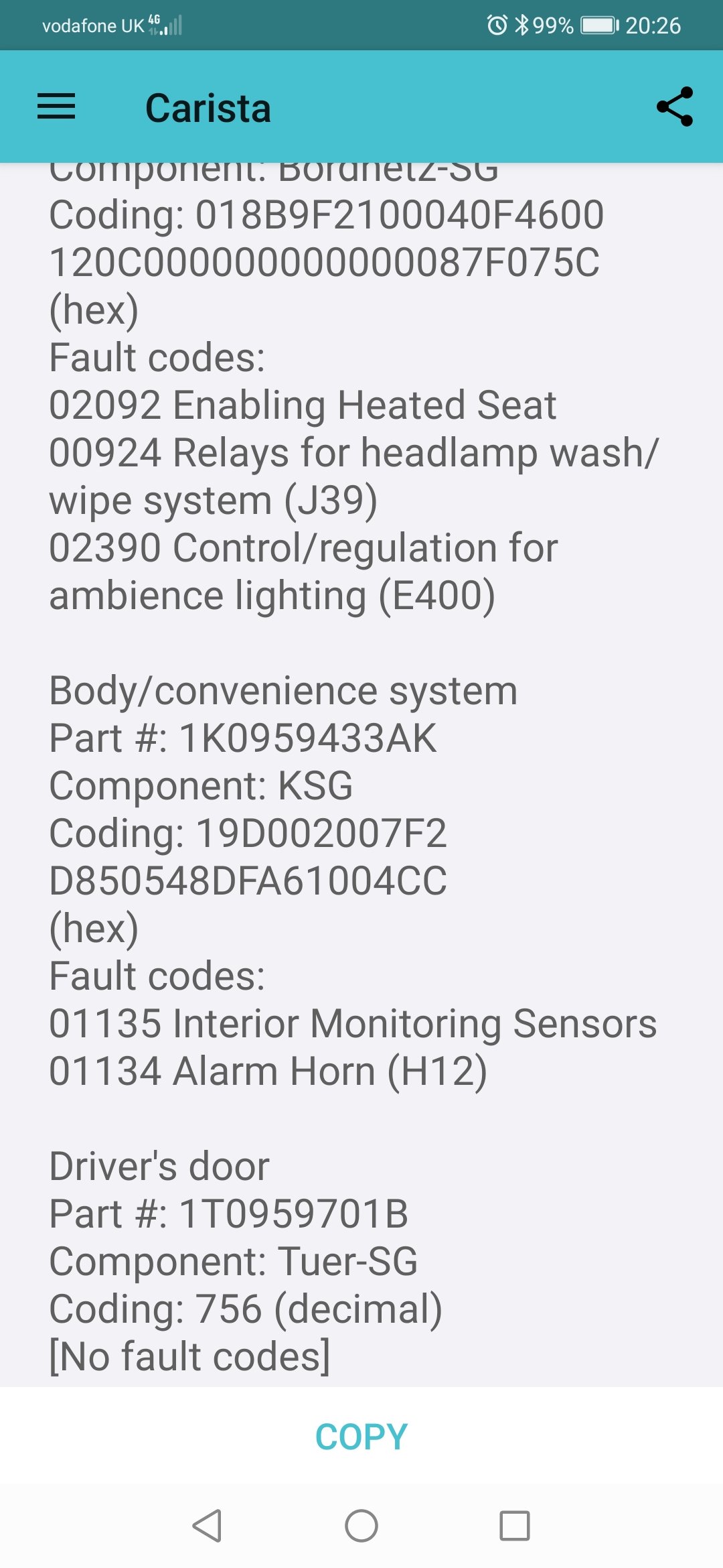

Put my factory head unit back in and the only fault codes comes up for it is this
It says about headlight washers and heated seats. My car does not come with them from Factory.
Any suggestions on what this fault might be and a remody on how to fix it will be much appreciated
I have posted a picture of the fault codes below

The most common causes of battery drain are faulty alarms, aftermarket headunits and dash cams left plugged in.
You've already confirmed the first two, you have an alarm internal sensor fault and a siren fault. The latter is probably the battery inside the siren.
The second is the aftermaket radio headunit.

Another thought based on symptoms and not experience, is that due to the car being laid up for a while, and assuming you removed the main battery during lay-up, the alarm battery had totally discharged and has finally failed.
With the main battery reconnected, it could be constantly trying to recharge the (failed) battery in the alarm.
Agree that possible suggestion. A easy thing to try temprarily disconnect the faulty alarm siren module and see if the problem is resolved.

Depends by what he means by hasn't worked along with the internal sensor fault. It may have not been the alarm that was faulty three years ago. And after 3 years the damage inside the alarm module could have worsened if the cells have leaked...  It's not a 100% diagnosis but an easy one to try.
