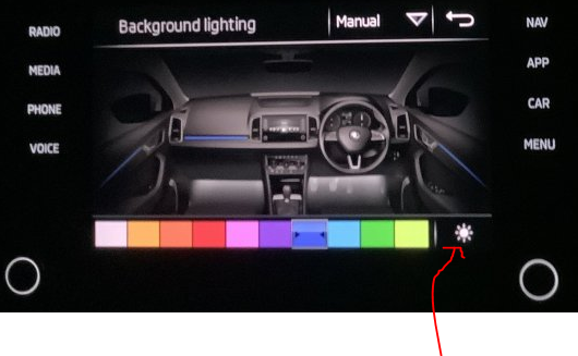

If not then it can be adjusted in 'Ambient Lighting'.
Area C...

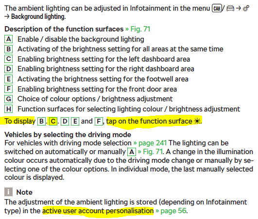

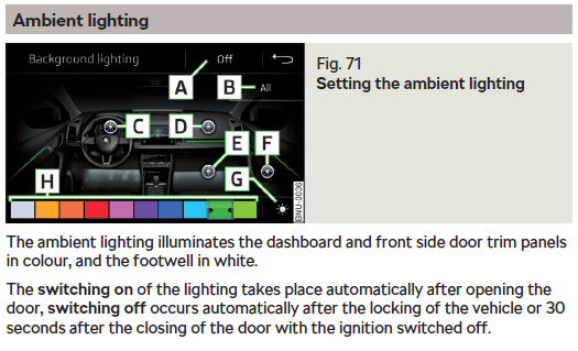

Without going outside to check mine, I'm going by the manual, which with Skoda often makes things worse.
It suggests that by pressing here...
You're able to select which area to change colour? C being the one you want...

Selected C but the controls do not affect colour or strength on dashboard. I’ll try and contact Škoda. Thanks for your time Silver

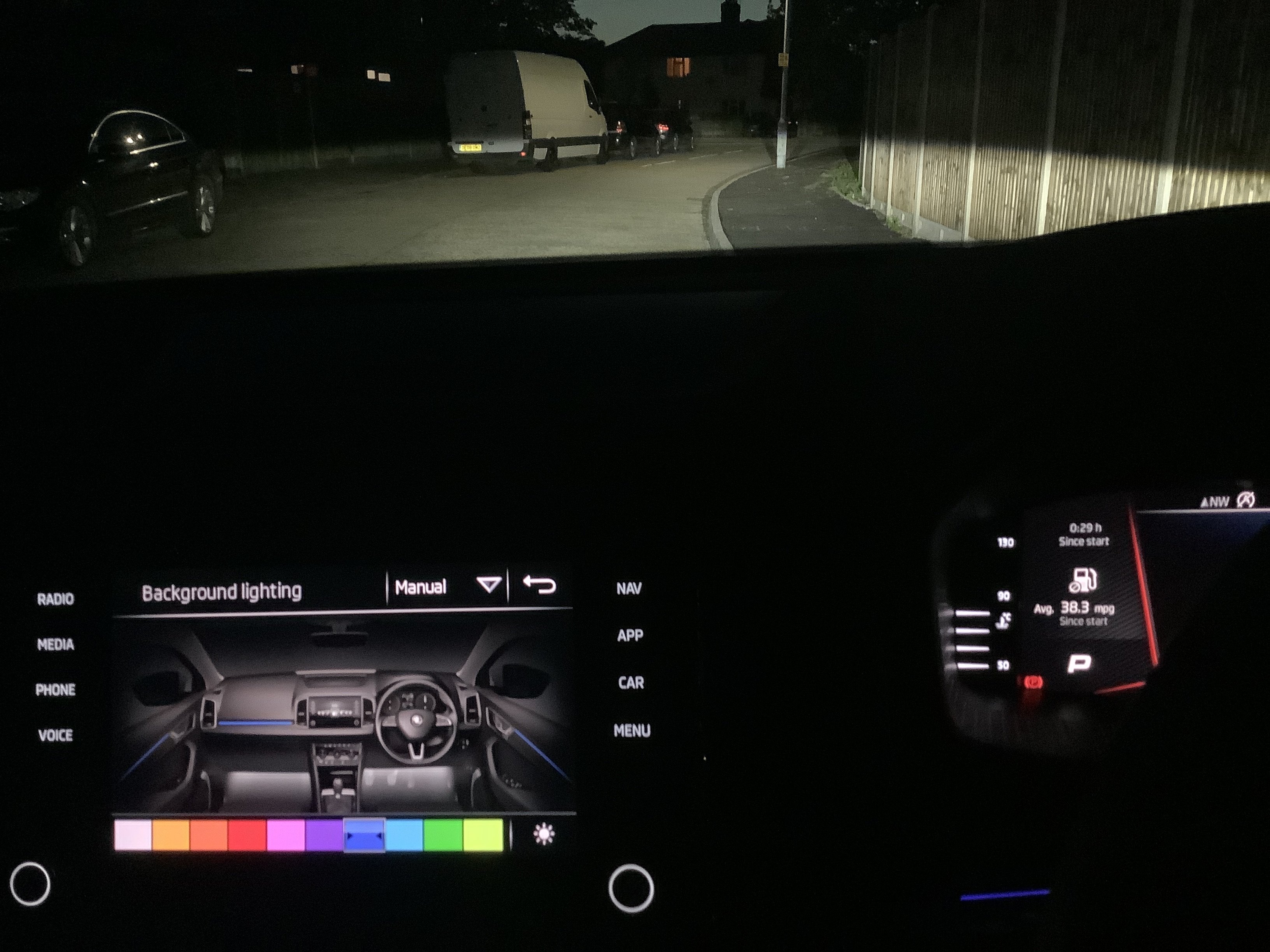

Here is the colour central display with the ambient lighting set to a shade of green...
