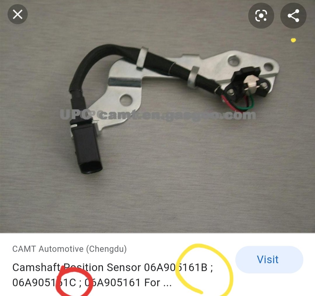

Hi, i have Skoda Octavia mk1 gasoline automatic transition, i have hot starts problems ( after 20 minutes from the car is off i face hard starts and hesitating sometimes in the beginning of driving )
Computer detected camshaft position sensor fualtls no signal , i want to change the cam position sensor but i heard that the cam position sensor model number should contains C in the model number  since my car is 1.6 cc i need your help to choose the right model number

Dear Alban, before trying to guess what is the problem, try to look for any faults by computer, when it is warm or cold,fixing errors then check the fuel pump pressure and if it keeps the pressure after you swith it off. Good luck
