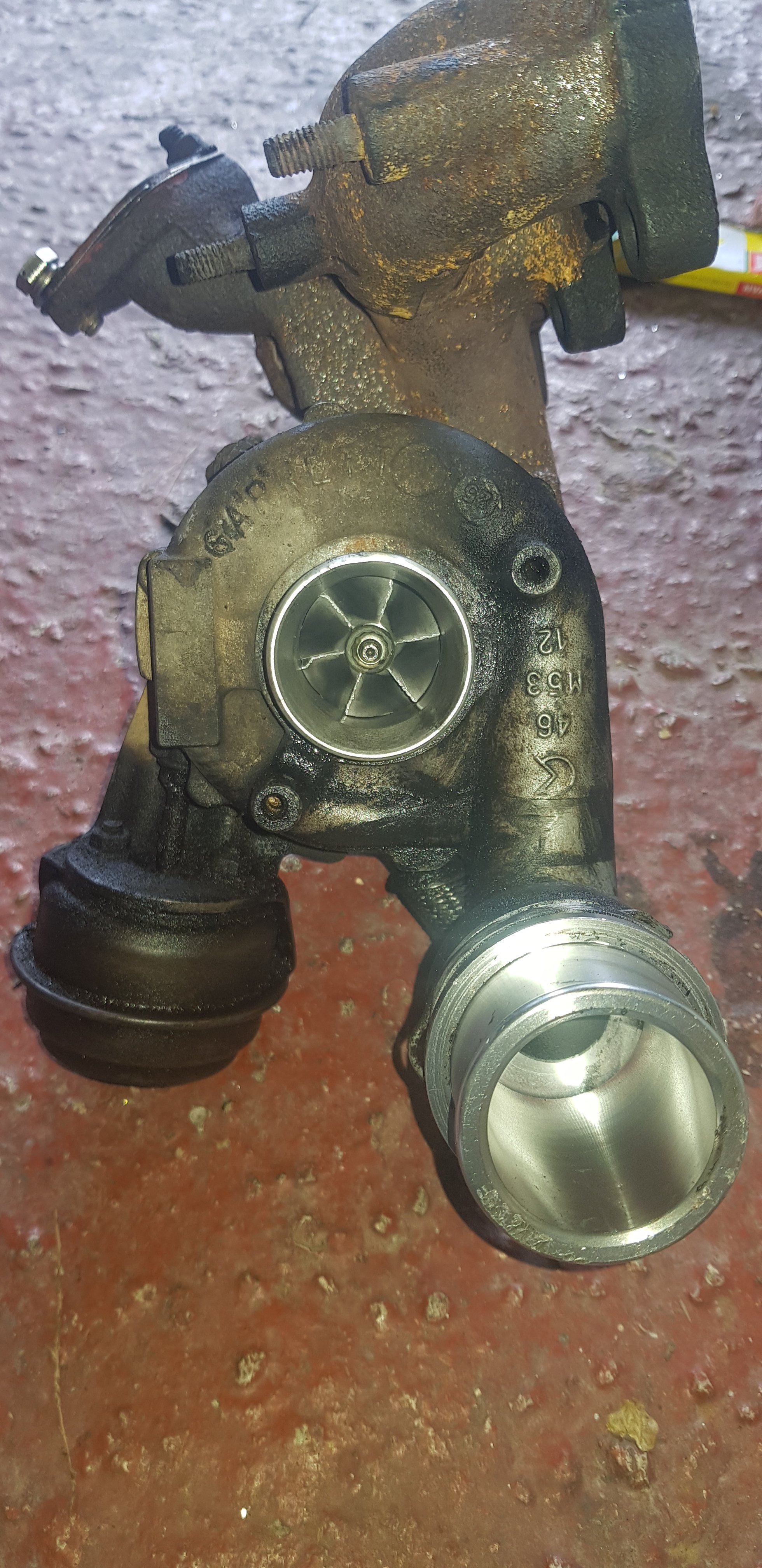

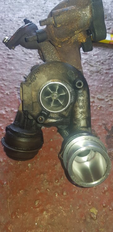

Whats the standard turbo on an asz engine is this standard
Being a garret I wouldn't have thought so. I'm sure KKK were standard fit on all fabia vrs.
Probably still a pd130 though.
Could of been most were KKK some were Garrett
the standard turbo is a GT1749va the flat area on the turbo on the left of the picture should have the details stamped into it to confirm, you may have to wire brush it to see
To add that turbo is deed though 🤣
