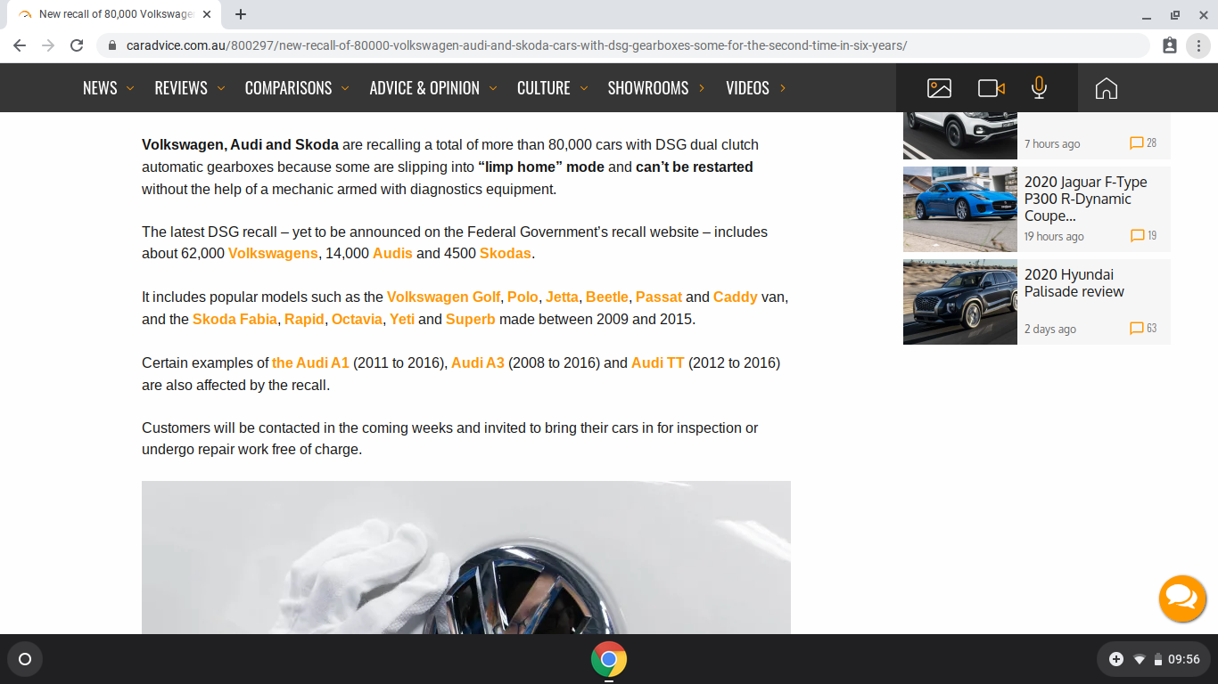

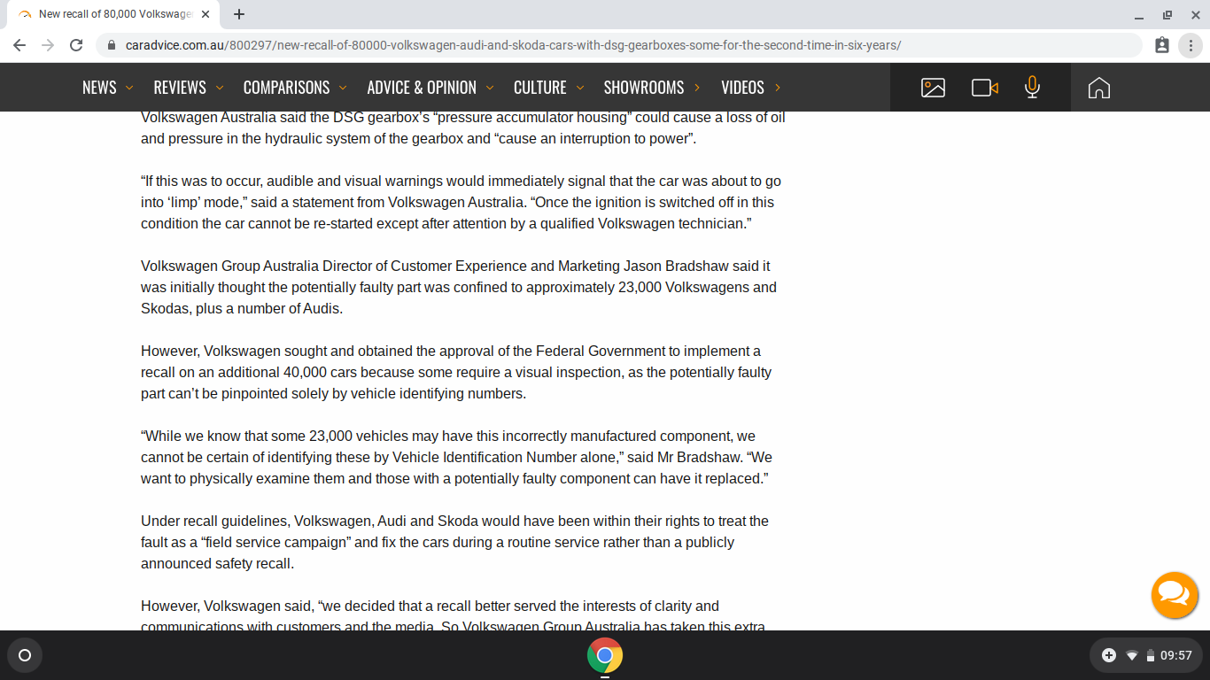

There is a Recall in Australia started in late 2019 on DQ200 DSGs up to 2016.
This follows from the World Wide Recall in 2012, then further issues which required a Service Campaign on some DQ200's 2013-2015. '34H5'. Software Update.
Australia should have been involved in that.
So now an Australian owners of cars with a DQ200 7 speed dry clutch DSG should check if their vehicle is part of the RECALL.
That means cars should be RECALLED, not like European / UK Secret Service, shsssss dont tell everyone seervice campaigns.
Octavia built to 2015.
But check on that, when the DQ200 was built, and the car built, and actually could 2016 Euro 6 vehicles be included because Skoda / VW are not always correct, or the VW Media / Press releases.
