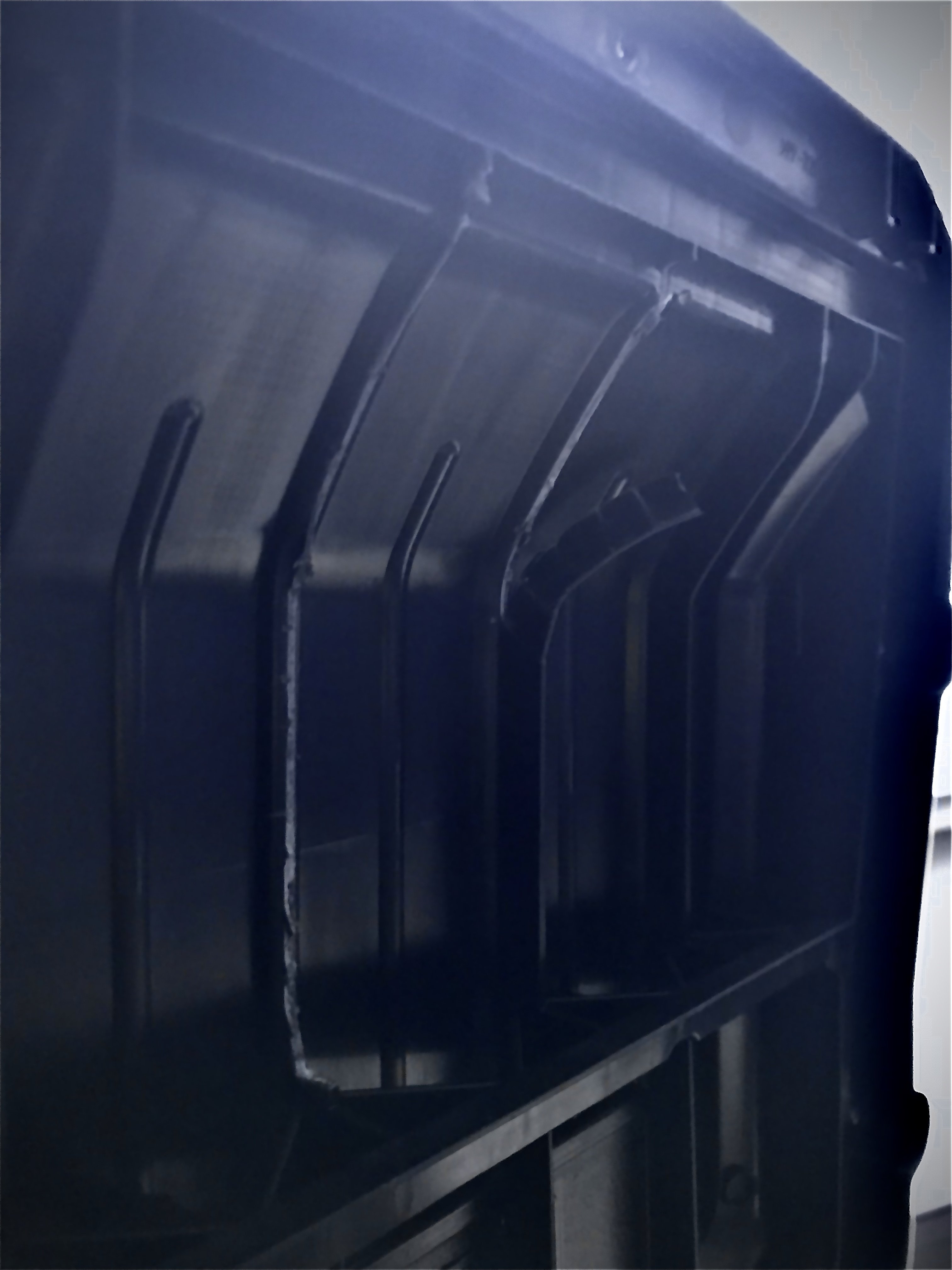

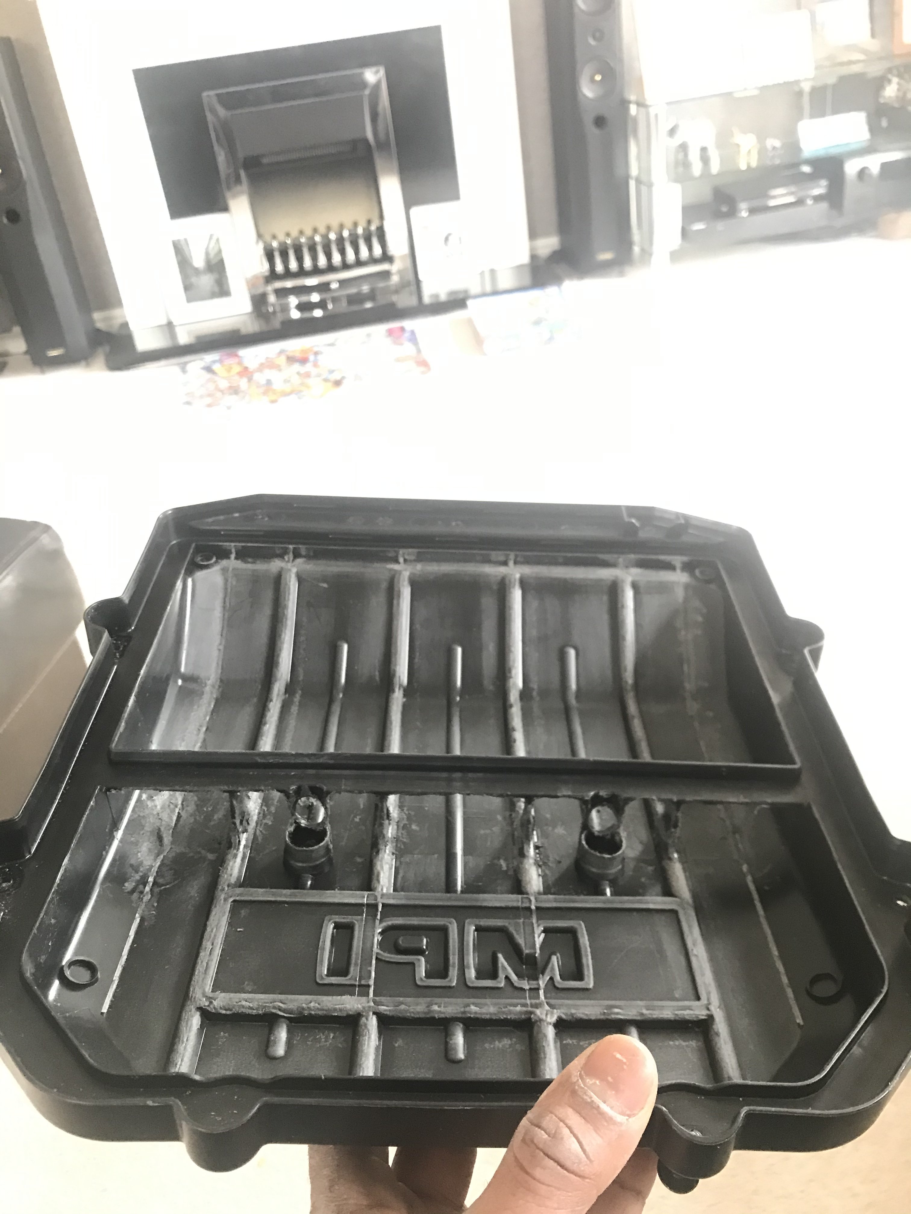

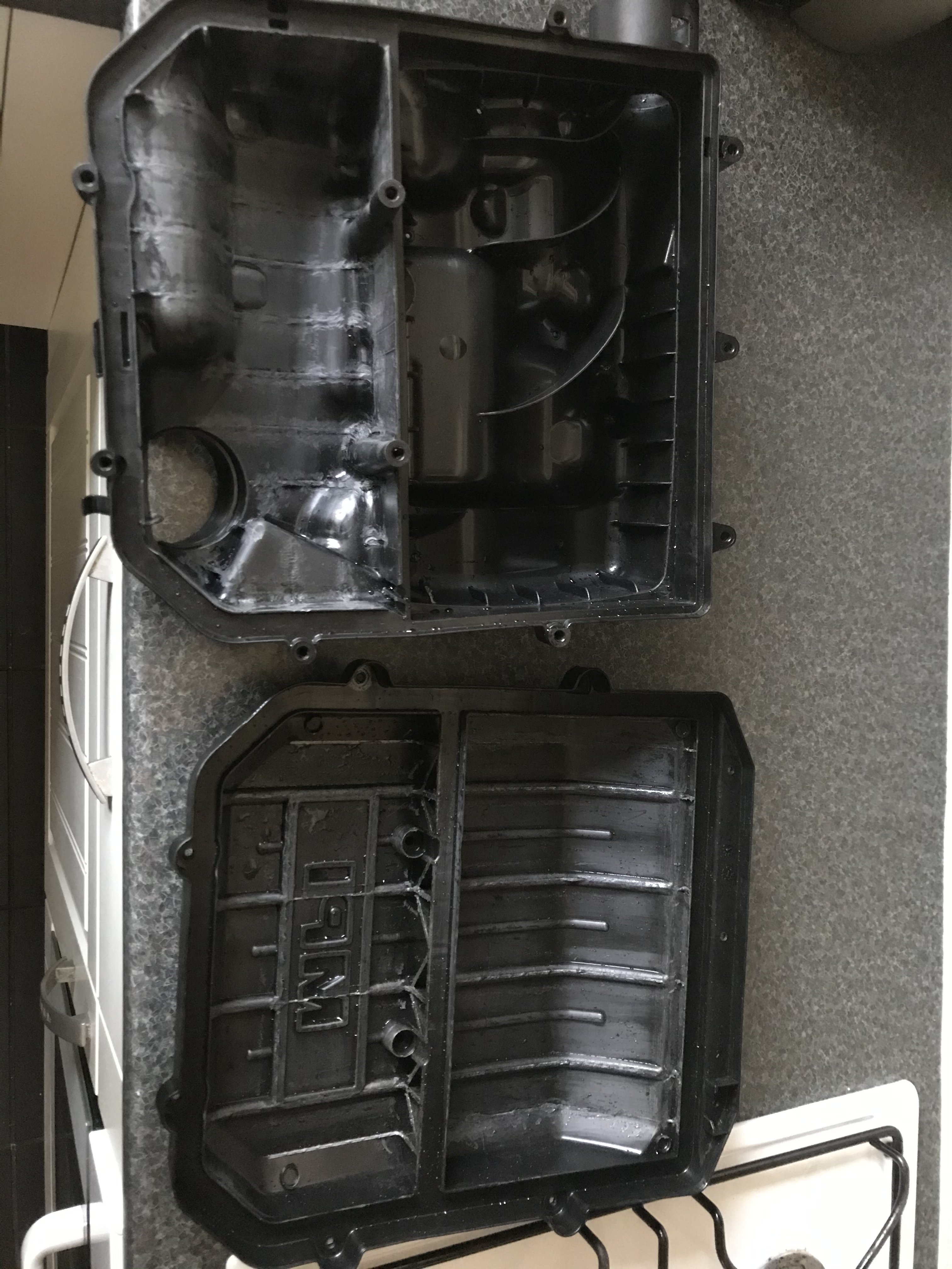

 smoothed out the majority of the internal plastic fins, a pair of pliers were used to snap off the fins and then smoothed out with a mini dremil. Results were a lot freeier reving engine and a smoother power delivery ( need to order an K&N air filter and then place on a rolling road for a remap )
I doubt that there are any gains to made by removing the strengthening ribs in the airbox. It may possibly sound slightly different, but "freer revving" is a bit unlikely....
