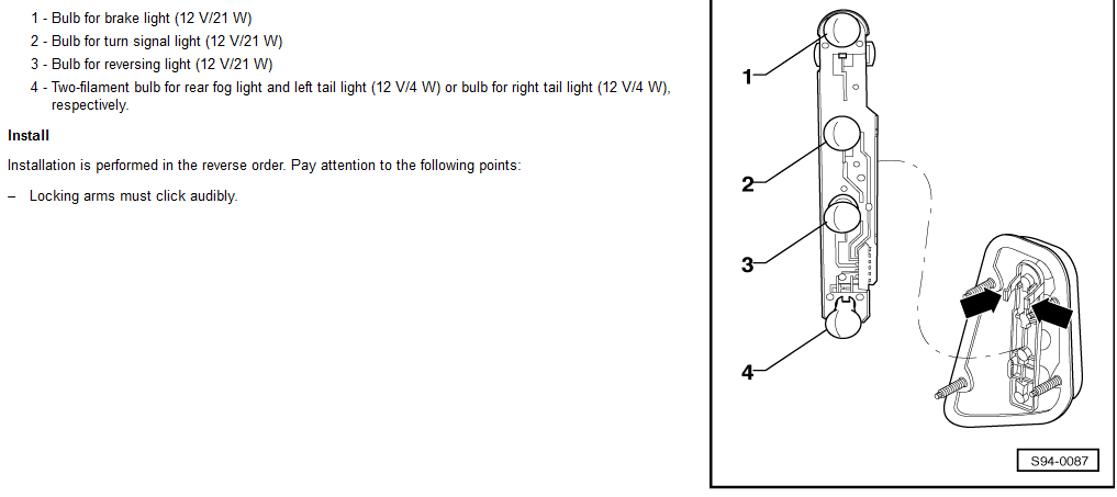

Have you definitely got the right bulbs in? Single filament 21 watt?
Thought they were double filiment
No, only the tail/rear fog are twin filament.
3 minutes ago, TMB said:
You sir are a geniouse! They have given me the wrong bulbs! Thanks for your help, it's just turned what was a really bad week around for me 👍👍👍👍👍
Haha, glad you have an answer 👍
