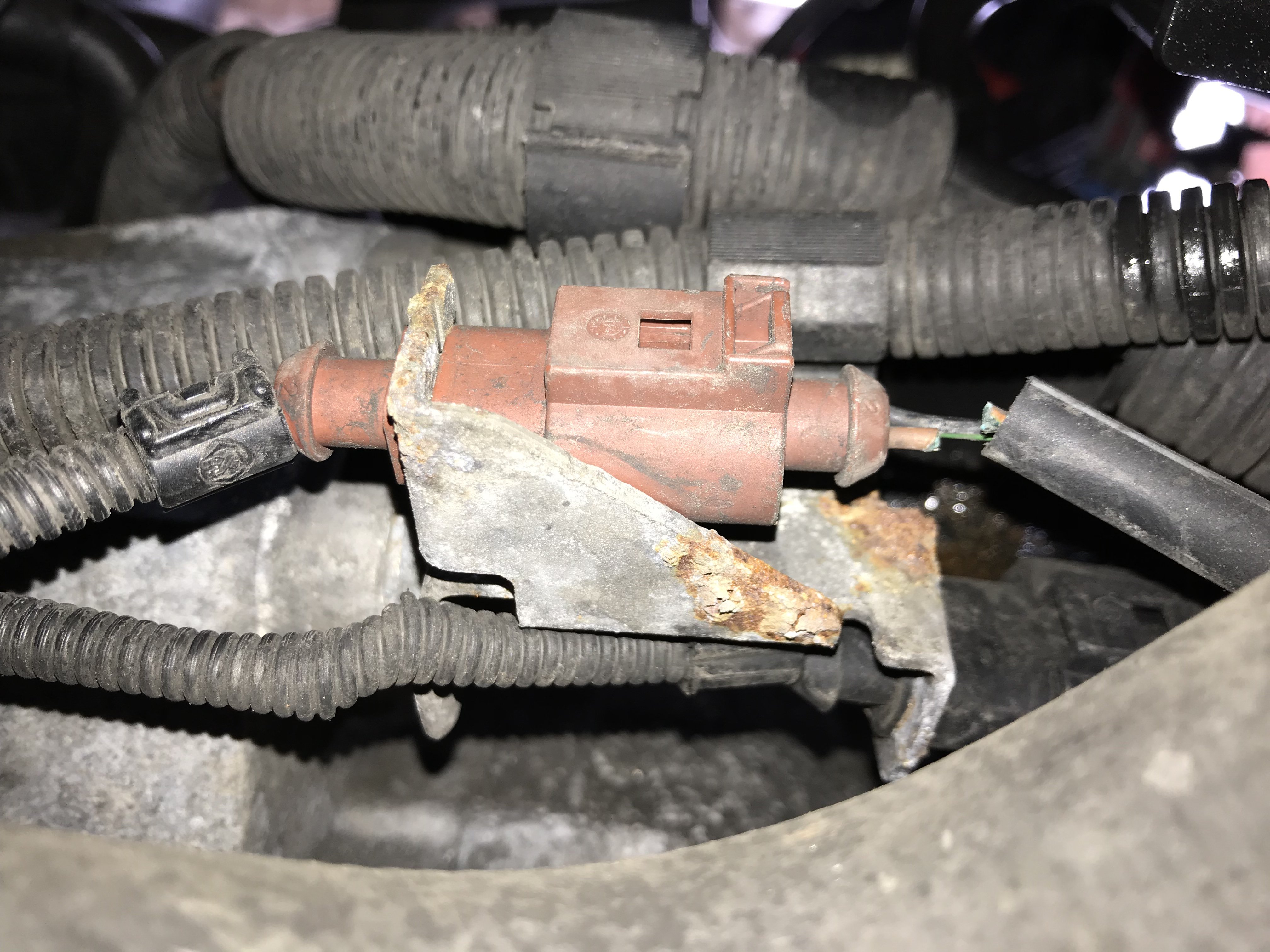

Check the terminal blocks next to the bellhousing, on the right front as you stand looking at the engine.They corrode away, if there is ANY doubt,remove all 4 and solder together and heat shrink .Had to do mine when my A/C packed up last year.
thanks mate will have a look do you have a pic
Sorry mate no pics.if you take off the engine undertray its much easier to see and access.
353A37C4-353D-4499-8E5A-995FF2F2D7B5.thumb.jpeg.274627af193116e8d834255d33dc0e0b.jpegThis is what you’re looking for /\

superb thankyou
