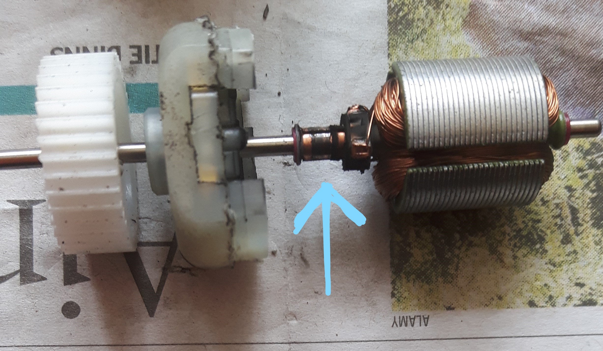

There's nothing in these lock modules that could be coded, it's just mechanical bits, microswitches, a little dc motor and the odd resistor.
A non-working one in my newer Polo was mended recently by cleaning up the innards of the motor; but it's not easy to get into it to do so.

This is the bit I cleaned up to get my original lock going by the way, if you fancy having a go:
