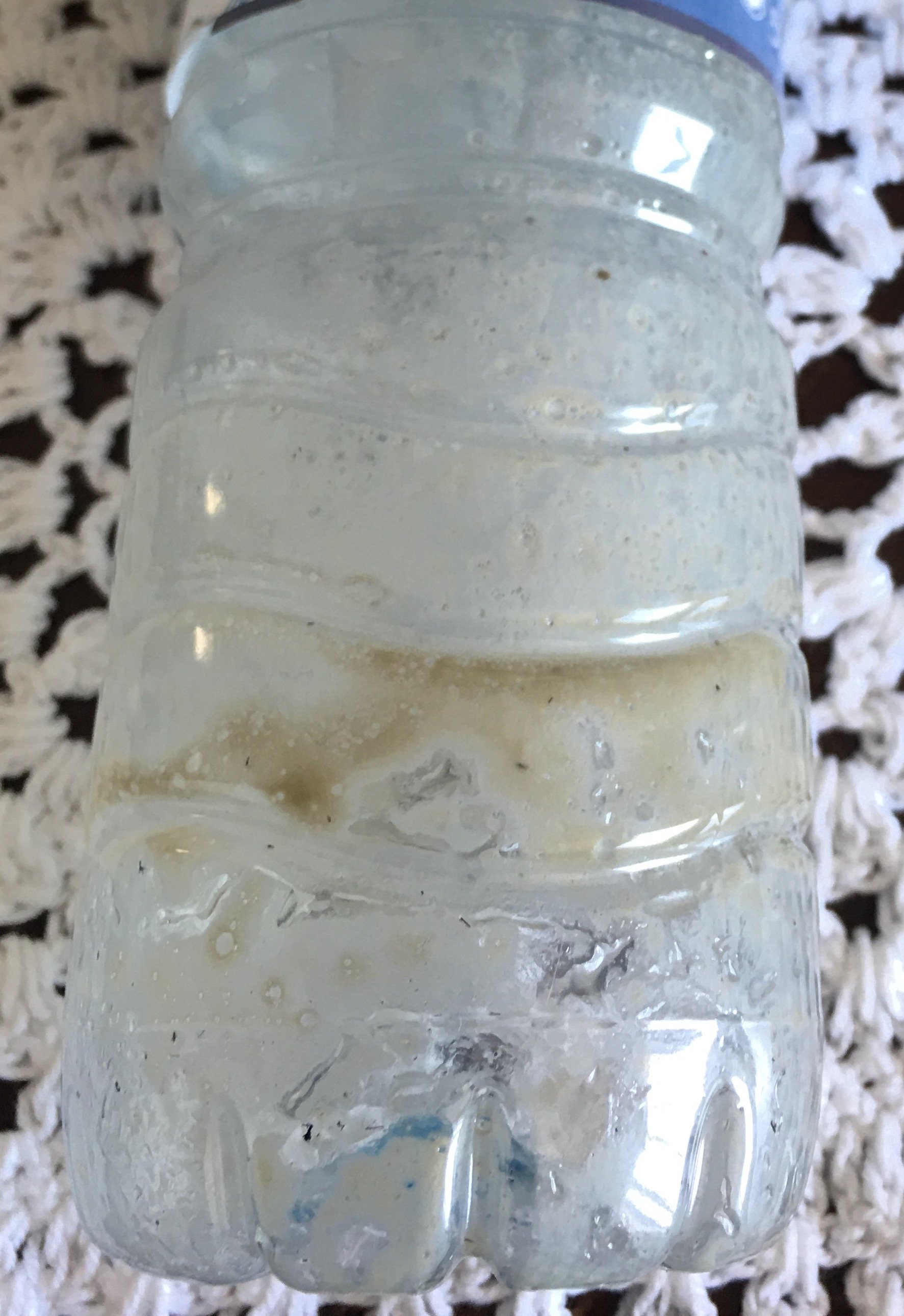

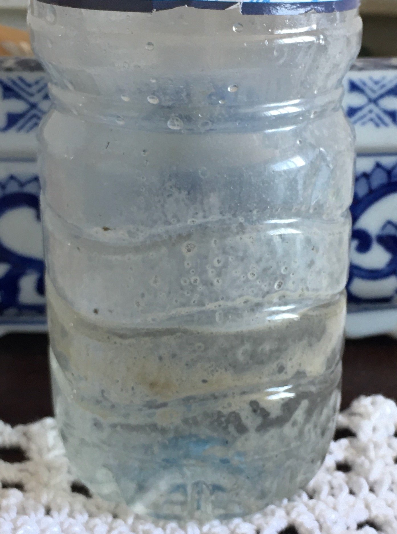

Just updating you on the steering pump saga!
The local garage have done a wonderful job and the steering is so light and easy to drive now and €600.00 cheaper than the main dealers quote!
What is interesting though was when the garage drained the steering pump fluid they were VERY surprised to see a clear fluid like water coming out.
The mechanic saved some and put it in a plastic bottle. Although the liquid is clear the sides of the bottle are covered in a whitish/grey film.
The liquid smells slightly fruity.
The garage said they had never in their experience seen steering pump fluid that colour - usually red/pink/greenish with some viscosity.
Could this have been a mistake by the Skoda garage when I had the steering rack fixed back in November?
I would be very grateful if anyone can throw any light on this liquid.
It seems very strange!
Thank you.

It really depends how long the last fluid was in there, Baring in mind steering fluid goes to your steering rack and back again when pumped, Over time it can end up contaminated through contact with the rack and pinion or it could simply have moisture or little source of water getting in changing the colour.
My bet is that been contaminated in some form of the process of fixing your steering issues, I wouldn't worry about if you've got new fluid in there.
Also good to hear your cars running well again!
Edited by Mickmartin
Thank you for your reply Mick.
Out of curiosity should the garage when changing the steering rack not have put in new steering pump fluid at that time?
Is it poor workmanship to allow it to become contaminated? How should they avoid that happening?
Thanks Mick
Hi Carolla. I am very sure the dealership should have evacuated the old fluid and fully replaced it with new stuff. Imagine if leaving the old contaminated fluid damaged a perfectly good rack within the two year warranty... They would have to then re-fit ANOTHER new one, in order to fulfil their obligation so, no, I sincerely do not think the would have left the old fluid in, unless they were looking for trouble!
As for smelling fruity... Screen wash often smells fruity and is often clear. Make of that what you will!
I think Skoda (VW) steering fluid is usually green.
EDIT... Following on from that, i just read a post a few down on the fabia site and someone else had steering issues. It turned out they had water inside the pump/rack or something so perhaps yours was a combo of fluid and water. (Technically called gunk)!
I still think the fitter of the rack should have changed the complete fluid and tested for leaks but if the pump failed AFTER the event, thats life.
Edited by mrgf
Thank you for your reply mrfg.
Yes I think that is my concern ie when they fitted the rack the mechanic should have changed the complete fluid and tested for leaks!
It does seem they didn't. If they had change the complete fluid then maybe the steering pump would not have failed? Or is this not the case?
