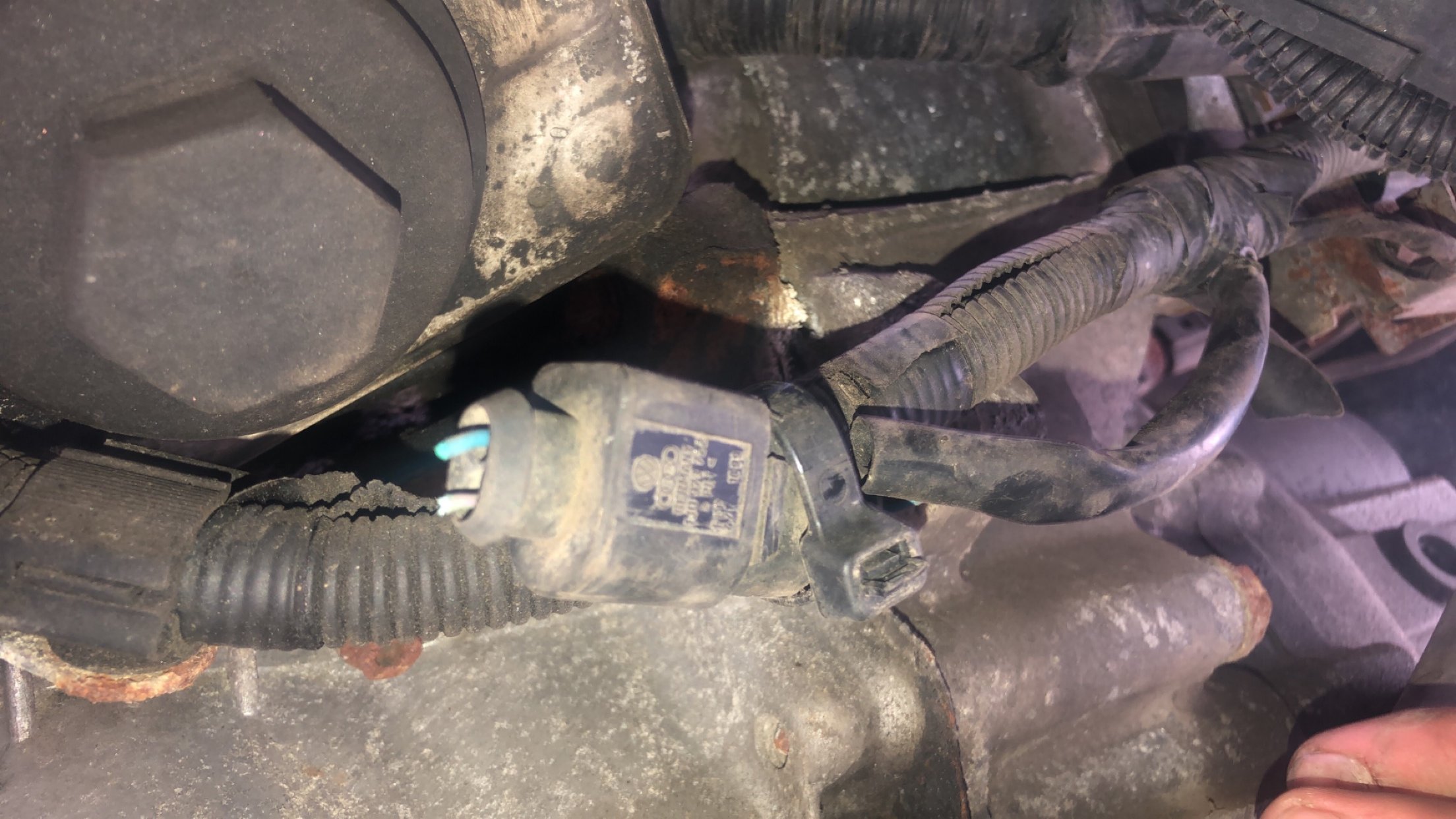

Is this the wire?
  • Sponsor
Yeah, probably. Bet your battery light doesn't come on with ignition either, cos both wires look to have broken and been abandoned. The angle of that photo is doing bad things to my neck!

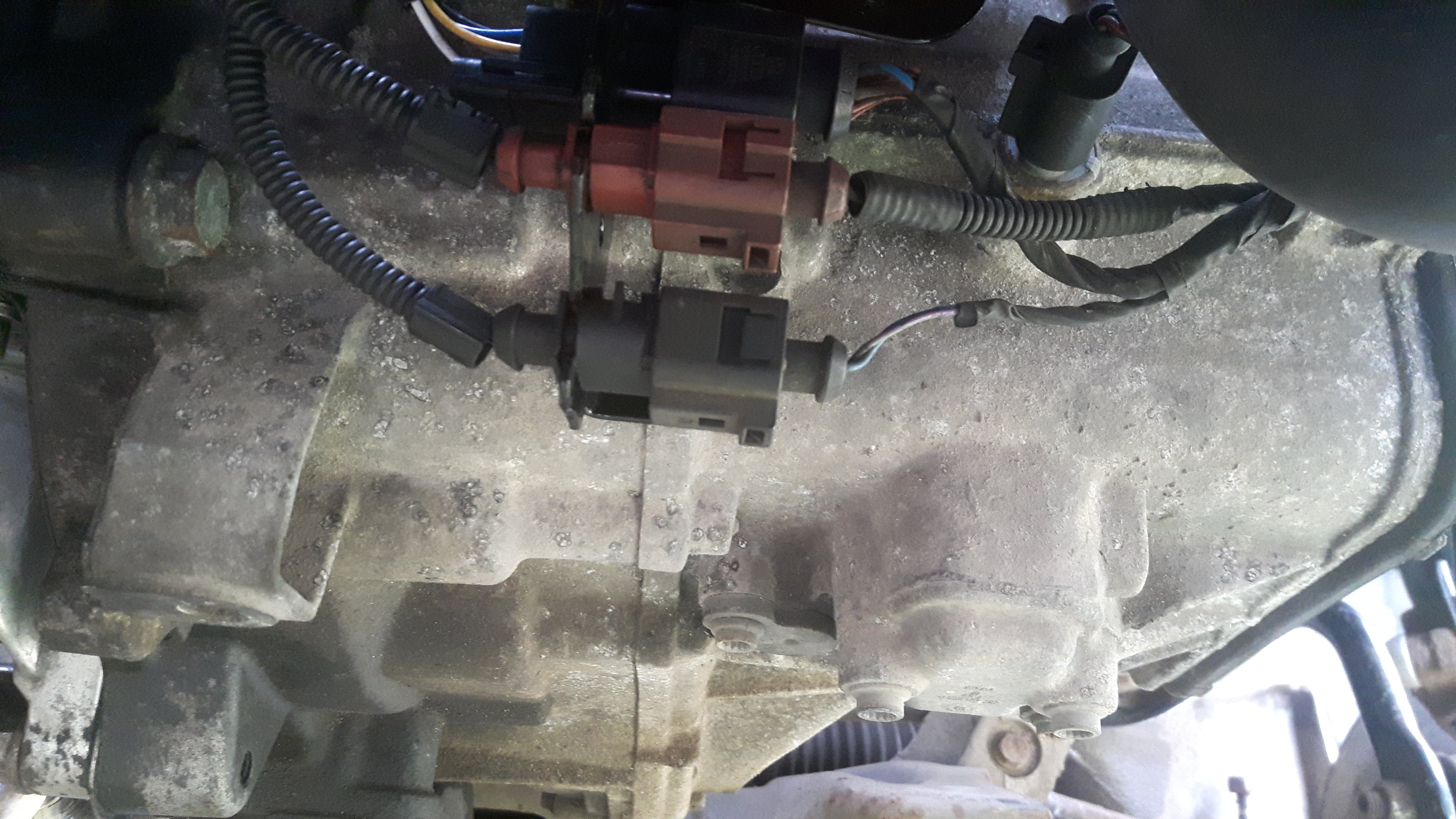

  • Sponsor
This is more like what you should be seeing, looking from the front, underneath, at the lower front of the gearbox (photo is of a petrol Polo, but should be similar).
Lowest, black, connector pair is alternator signal connections (and what is in your pic, in a strange place). The reddish brown pair above it is for the A/C compressor N280 valve.
