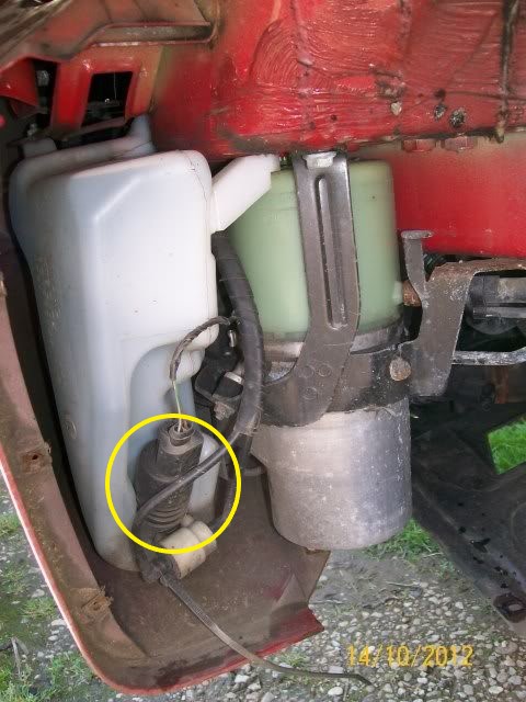

Yeah it could well be the pump motor or it's wiring. You can get to the pump from under the front N/S wheel arch by removing or moving back the plastic arch liner. You need to remove the T25 Torx screws in the liner.

The pumps can get gunked up, especially if you use plain water in the washers. I suspect that's what's happened if it's scanning as normal.
Pull the plug off and check for a voltage there and a clean run back to earth. It's also worth testing the pump by dropping 12 straight to it with a pair of wires.
Pumps are cheap and a fairly generic part. If you're taking it off, give the bottle a good flushing out
