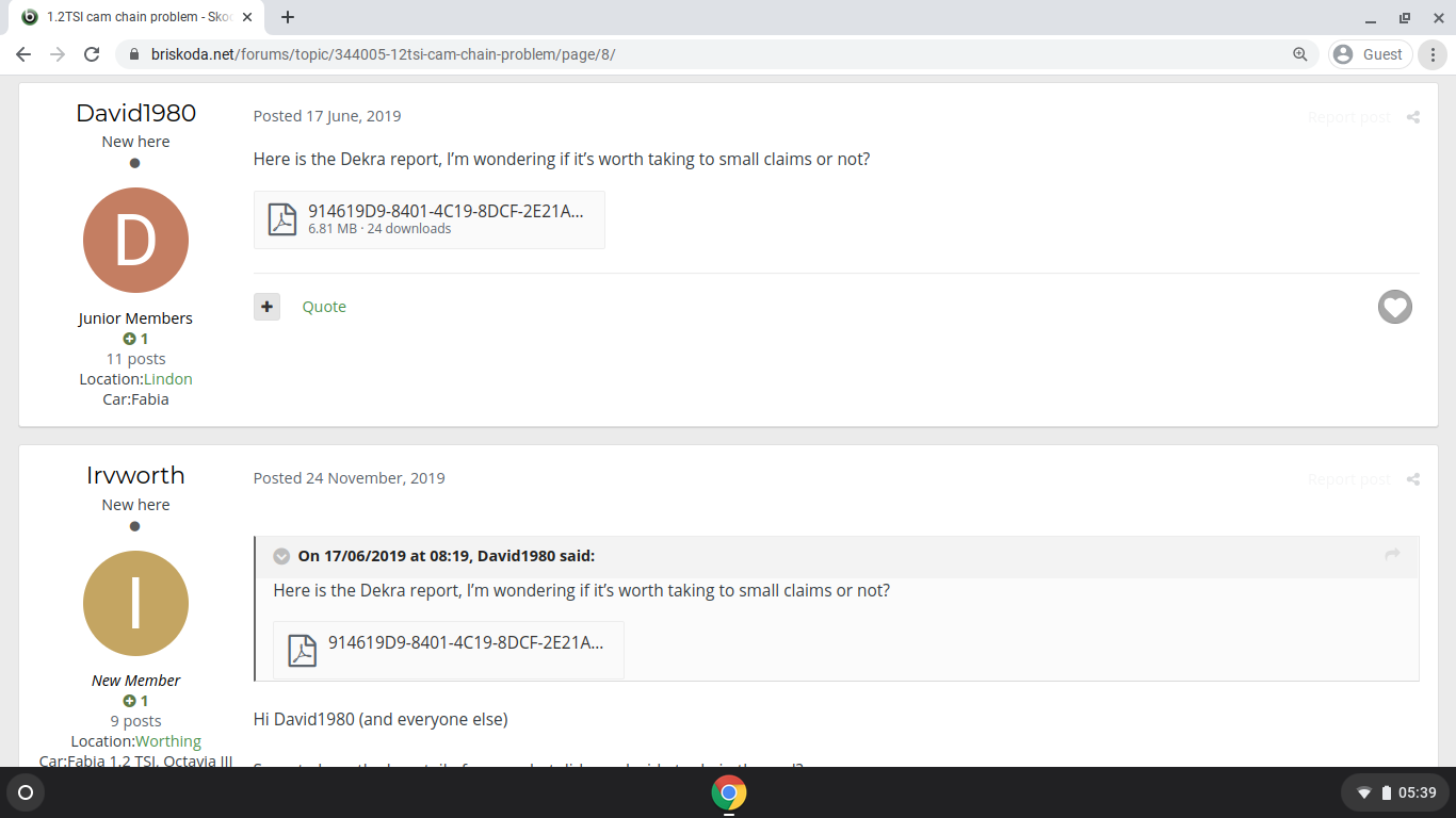

http://briskoda.net/forums/topic/435977-timing-chain
http://briskoda.net/forums/topic/344005-12tsi-cam-chain-problem
http://briskoda.net/forums/topic/344005-12tsi-vam-chain-problem/page/8/
See this link in page 8 of the link above.
