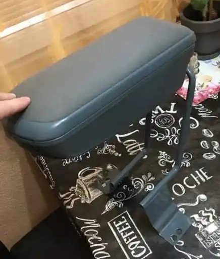

Only armrests for Felicia I'm aware of were sold by Milotec, but they are not available anymore. Maybe it would be possible to modify armrest for different car models - similar armrests are sold in UK by Kamei.
(Image "borrowed" from a market site)
Edited by Papez
I like the look of that. Does it bolt onto the same bolts that are used to hold the back of the front seats in?
Yes, they fit under seat rail. I read something about collisions with seat in rear position, but I cannot confirm that, since I wasn't able to get one...
No worries, my seats very rarely go all the way back anyway! Any idea if there's any other consoles that would fit? The issue is that the felicia puts the back rest adjustment knob on the seats in the middle of the car, rather than the edges, so they get in the way
I'm affraid there are no other consoles that'd fit, without some modifications.
That issue with knobs might be solved by switching left and right backreasts. Seat frames in felicia are symmetrical. But plastic side covers need to be modified for that.

I had a console like this, was a ''universal" one and i manage to fit it by myself.
I use it for few days in the city and one time in a travel but i wasn't happy,i had a problem,my elbow every time i was putting the R gear was hitting a little bit on that console so one day i was very nervous and i gave it to a friend of mine.
