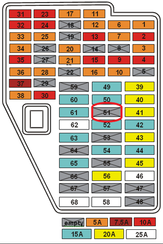

I brought a mk1 skoda with 48k on the clock. Everything was perfectly fine but the 12v outlet in the rear of the car is not working?? I have looked at fuse diagrams but haven't managed to find a rear 12v fuse slot.
Mk1 Fabia Estate 16v Engine number BBZ
Thanks for any help.
T

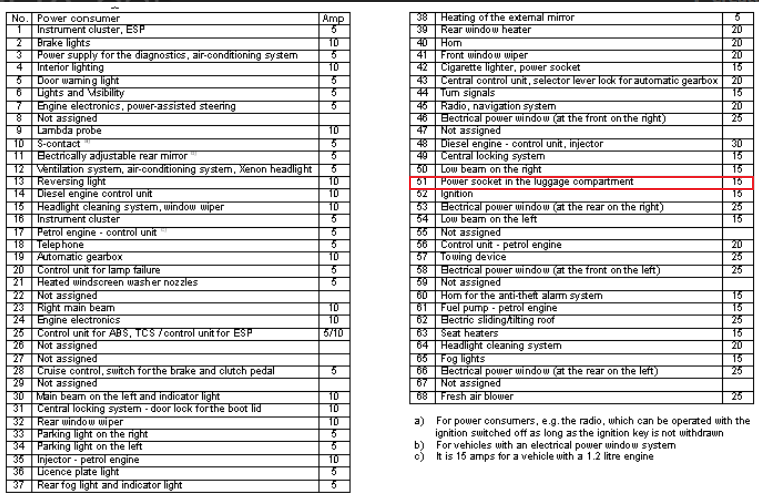

I would have thought fuse 51 but it's showing it as missing on the fuse box diagram.
Edited by TMB
  • Sponsor
What year is the car?
Don't bother answering that, it's the same on every wiring diagram for every year. Fuse 51 as Lee says, 15 Amps.
Edited by Wino
Thanks for the responce guys! Works a treat.
