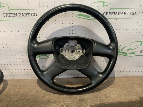

Does your current steering wheel look similar to this? Are you looking at getting a wheel like this one?
If so then no the airbag wont fit, you will have to buy the correct airbag for the wheel you want. However the wheel boss will fit, I think most, if not all, new Skoda steering wheels will fit.
I know for sure that steering wheels from Octavia 3 and Fabia 3 will fit Fabia 2.
Fitting MFSW to a non MFSW car can be difficult as it will require being coded with VCDS, there are people on the forums who might be able to do it for you.
Have a search of the forum for threads about changing steering wheels, it has been brought up a fair amount of times so there is a lot of information to learn.
The first one is a leather version of the soft plastic one I have, albeit mine does not have the little chrome trim. (WHYYY)?
The second is not the one I was ;looking at but I will try to post it.
Edit, this type, if MF is too tricky.

SKODA-OCTAVIA-FABIA-CITIGO-2013-STEERING-WHEEL-5E0419091M-Leather
Edited by mrgf
Fitting a Multi-Function version of the wheel you posted will still require the same level of trickery and coding as any other so its up to you whether you think its worth it or not.
Apart from that I think your current airbag will fit the one you posted as they are the same wheel so I don't see why they wouldn't.
Yeah, just a slightly different shape to the thumb area, I think. as long as the air bag fits, I am happy though as the air bags seem an arm and a leg to replace, even used and I am not sure I'd like a used one, anyway! Thanks, WillSmithy.
