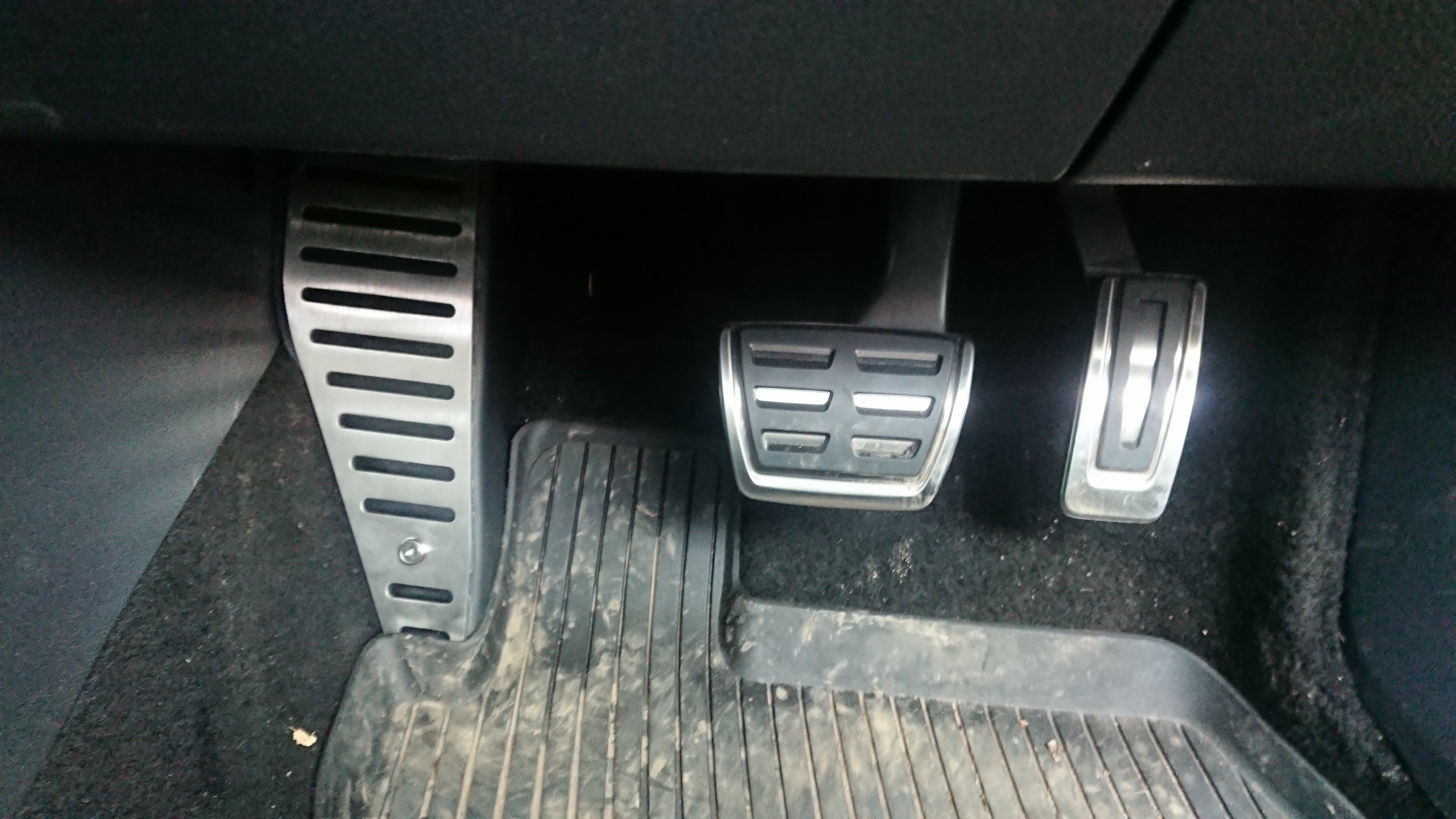

For those of you with DSG and the AL pedals ( much cheaper on eBay!)  I have successfully fitted the RHD AL footrest for the Mark 7 Golf - bit of a faff to fit, but it goes in eventually - see item 15400526889. £18.99 post free, came in 3 days via Coalville!
For the AL pedal covers  - try item 112551555557,  EUR 19.00 + 6.90 postage from Germany, which is where I got mine from!
Good hunting!

There's a video tutorial below which shows how to do it. It's in German, but still easy to follow.
👍  Footrest shape and fitting is different!
Pedals much easier if you warm up the new ones - hot water soak helps!

Well spotted - and good to know. So perhaps not the right video for a Karoq 😞
I took a gamble on the Golf one fitting, and it was a 'struggle' getting the lugs underneath to drop into the slots, but we made it eventually  - there's just one Torx screw to remove and the lugs on the footrest do fit and the screw hole aligns perfectly.
To remove the existing footrest, remove the Torx screw and firmly push/slide the foot rest about 15mm towards the front of the car then prise up with a trim tool.

According to this website, the Karoq one is as shown in the video above.
Part Number 5E1 064 209, Price 15.69 Euro.
Just checking - think that might be LHD only? 😔
Much prefer the shape of the one I have which matches exactly the factory footrest.
i fitted this footrest to my sportline it's a audi one it sticks on and you drill three hole and fit three bolts in it work ok had it fitted about 10 months now

Checked VIN with SkodaParts.com, which I have used regularly - that design of footrest is LHD only - HTH! 👍
many thanks for the correction! That's saved me ordering the wrong part :)
