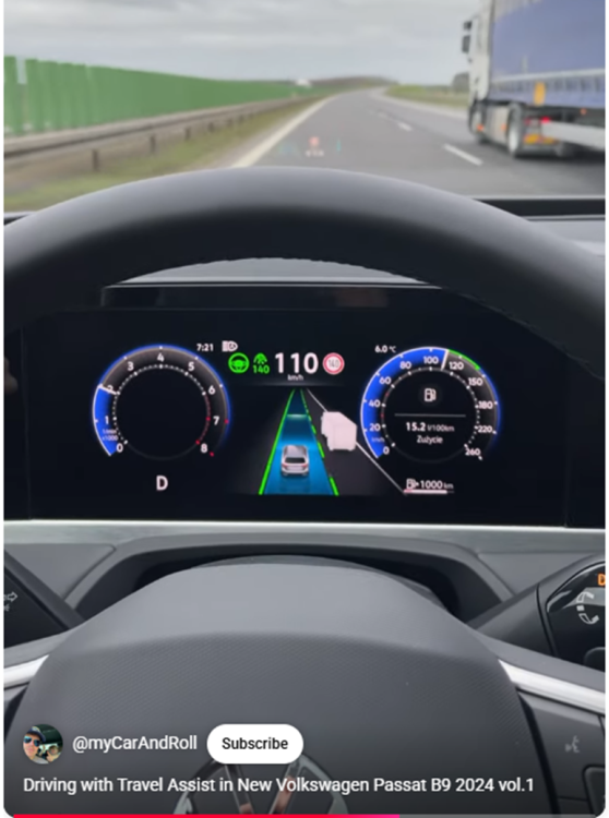

Hi. I added an image for clarification of the problem.
As you can see in the video there are 2 lanes on the screen, even sometimes it becomes 3 lanes. But for my car there is only 1 lane.
I guess there is a setting which i can not find.
Can you give me information about this issue. How can i do my car's screen like this.
Thank you.
You need to have travel assist turned on. When on this screen use the scroll wheel to turn on travel assist. It will show up to 3 lanes depending on the road you are on (it doesn’t always show multi lanes) and will show vehicles in other lanes like your image.

You do realise that the picture you posted is of a VW and not a Skoda? Quite possible they have different software, not all VAG cars are equal…

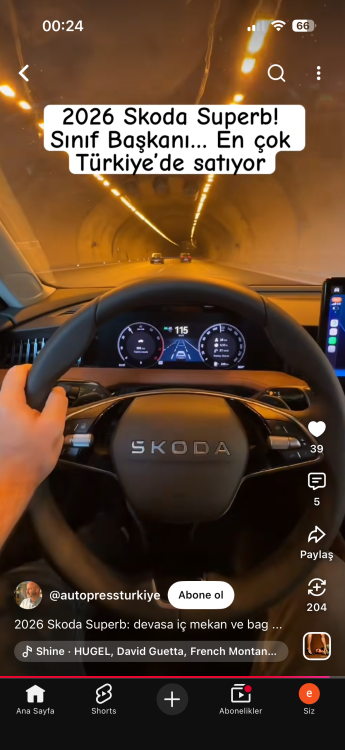

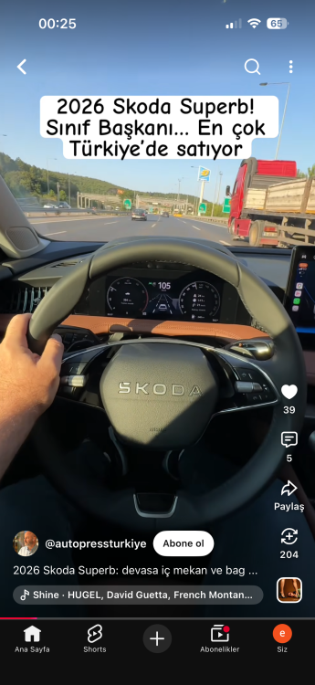

Actually i saw vw, cupra and superb on the internet showing 2 or 3 lanes.
I add two screenshots which shows the three lanes for superb.

Hello,
My observation: this is working when you use Travel Assist and it depends on type of the road. In my country (Poland) it only works on highways (2 or 3 lanes) but not on expressways (even 2-lanes same direction nor inside cities). It's not working with ACC in my case despite of type of road.
Pic from today:
Superb IV - 2025.
