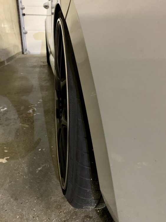

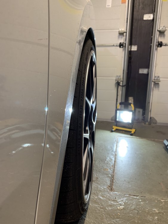

I  doubt that this wheel will fit nicely into the arches. I'm running 245/30R20 on 9J wheels with ET30, and that has only been possible by setting the alignment with standard arms to maximum negative. I do have to add that I've lowered the car with H&R coillovers set to the maximum height, which is around 40mm lowering in comparison to standard. Your wheels would stick out another 3.3mm further: https://www.willtheyfit.com/index.php?width=245&aspect=30&diameter=20&wheelwidth=9&offset=30&width2=255&aspect2=30&wheel_size=20&wheel_width=9-5&offset2=33

Would you say that a 8.5j wide is about as wide as you would normally want to go?
To be on the safe side it is better to not go beyond 8.5J wide, but it all depends on the ET value as well.

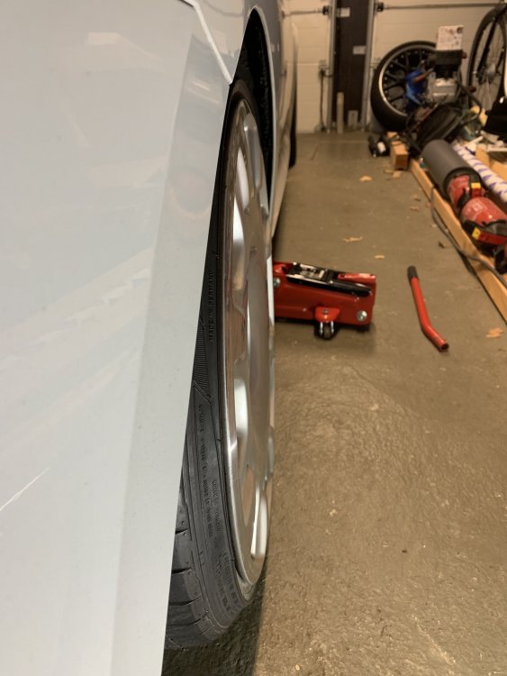

I’ve test fitted 9Js with ET41 and those  worked quite a bit better than the 9Js with ET30 you see in my previous pictures. However with these higher ET values you then need to start thinking about how close the inner rim is to the suspension, especially on the front.
I’ve included a picture of the test fit of the 9J with ET41 on the back of my Superb. Ignore the tyre size as that one is definitely wrong for this car, but It was good enough to get an impression.
