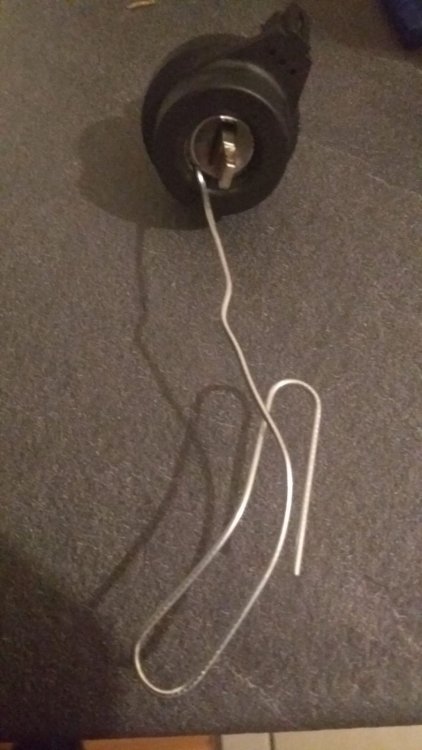

I’ve tried everything, it’s failed - I have removed the steering lock & barrel but I can’t separate them despite my best efforts. I need to replace both parts..

You should be able to get new barrel from Skoda dealer as it needs to be specially ordered to match your key.   Did you manage to turn the key to specific notch as you should be able insert a thick paper clip in the hole and it should pop out.  I found you need a heavy duty paper clip to provide enough pressure for the barrel to pop out as a normal paper clip is too flimsy.
I’ll call some dealers on Monday then, I’d hoped to be able to order online somewhere. I can’t turn the key to the first notch, I’ve tried in vain to turn it further - I don’t know if I can drill into the lock to make get around this perhaps.
