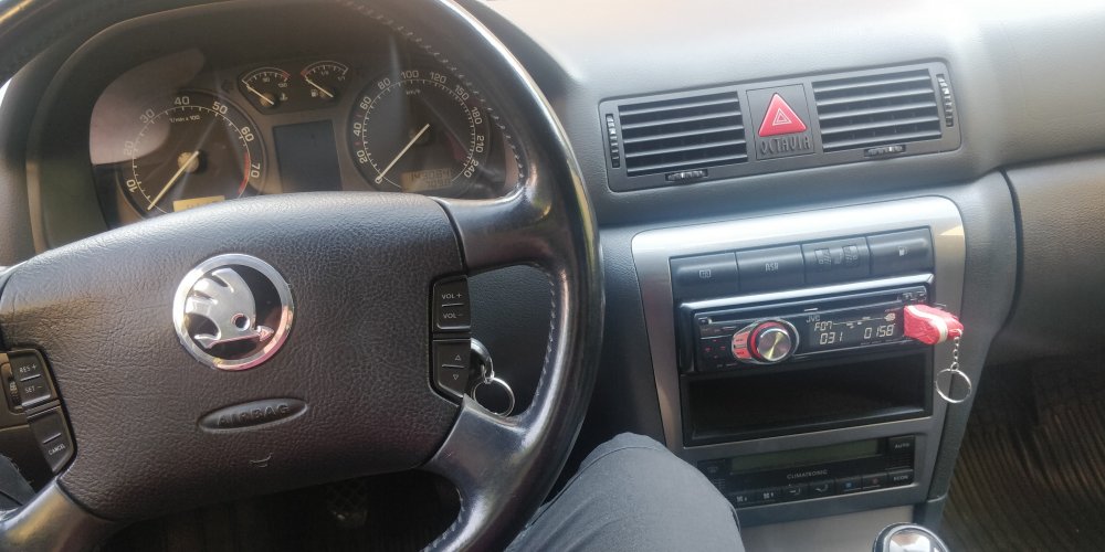

Aftermarket radio with the steering wheel commands?
Hey! I was wondering if there is any way to connect an aftermarket radio to the volume buttons on the steering wheel? Is there some kind of adapter, or what radio does come with the module? I would love to use the steering wheel commands :)) (I have an old-ish jvc player fyi.)
