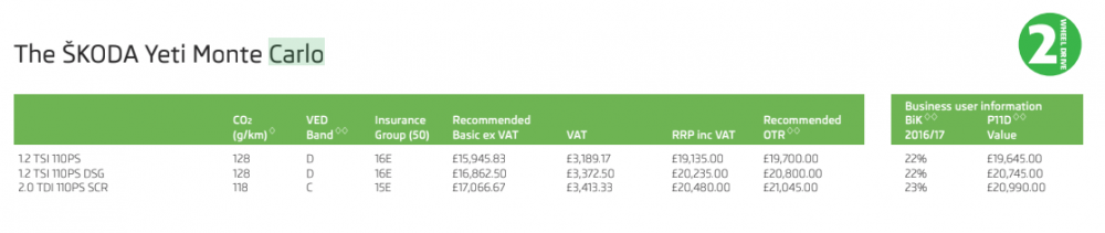

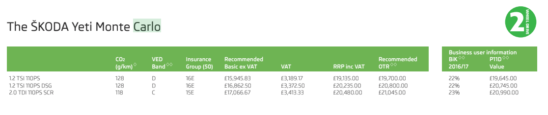

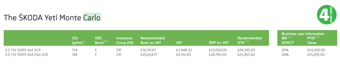

6 hours ago, Robjon said:
I'm not 100% sure the Monte Carlo was available with the 1.2 110bhp petrol engine.
Link suggests the MC was only available with 2.0 169bhp diesel engine and 4WD.
DSG variants of this engine would have the six speed, wet clutch gearbox.
From the brochure.
2 wheel drive version.
4 wheel drive
