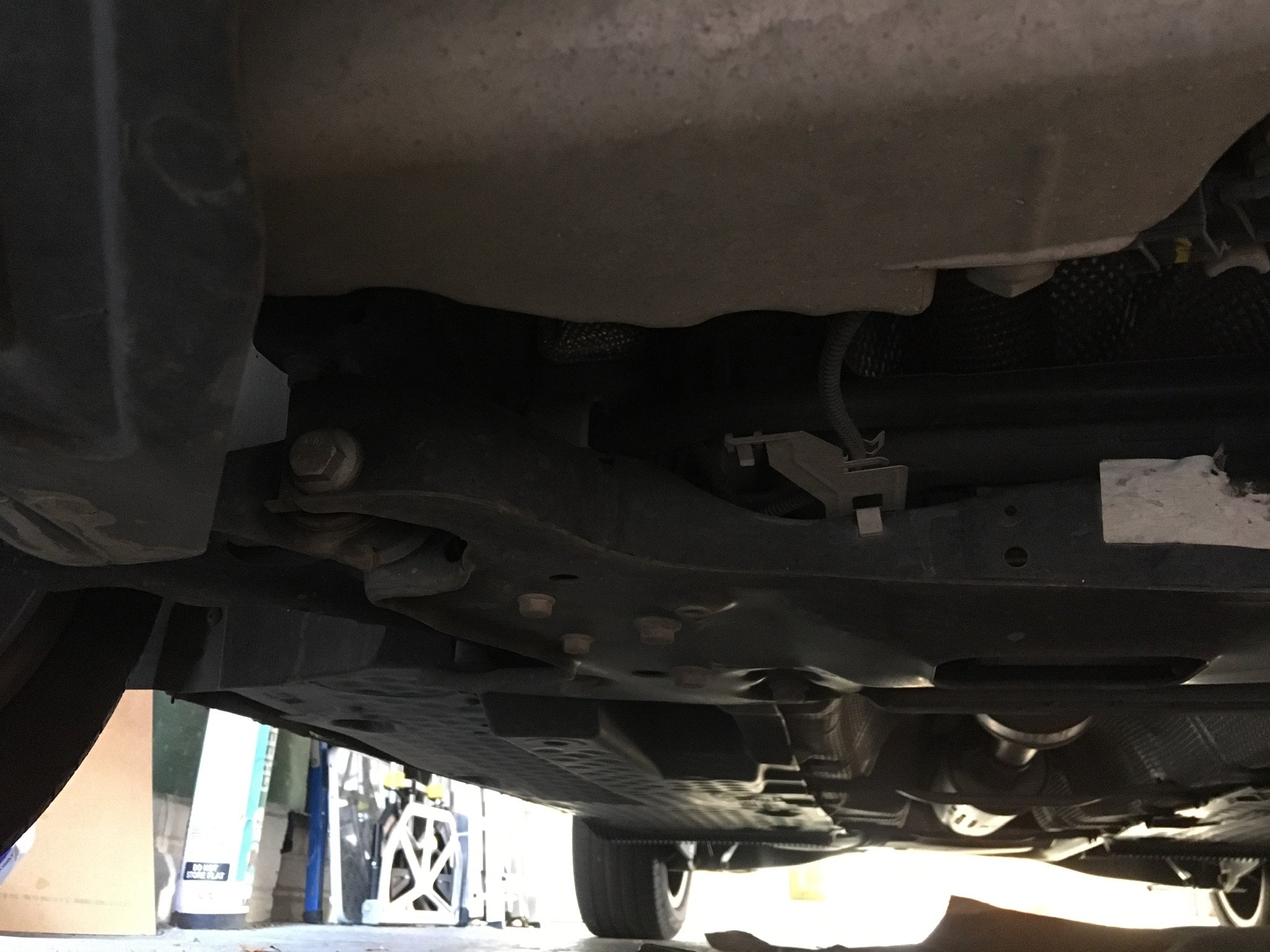

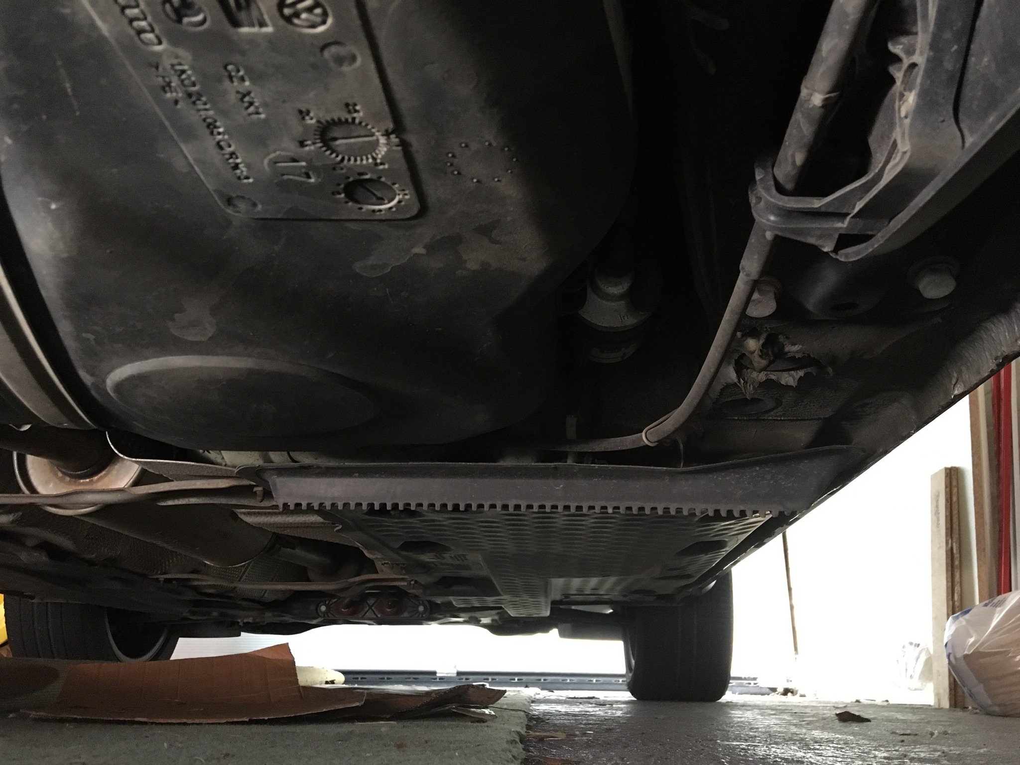

Here they are
22 hours ago, paco said:
Here they are
And?
All I see is the standard under engine shielding.
Why are you concerned?
11 minutes ago, Llanigraham said:
And?
Hi, I’m not concerned I was just curious but other posts say they are an extra specification so they are not ‘ standard ‘ ?
either way I’m glad I’ve got them 😜
No, I think you have misunderstood.
ALL models get a plastic undertray, as shown in your photos, but what you could do is order the Rough Road Package which provided EXTRA fitments plus a slightly different under engine tray.
