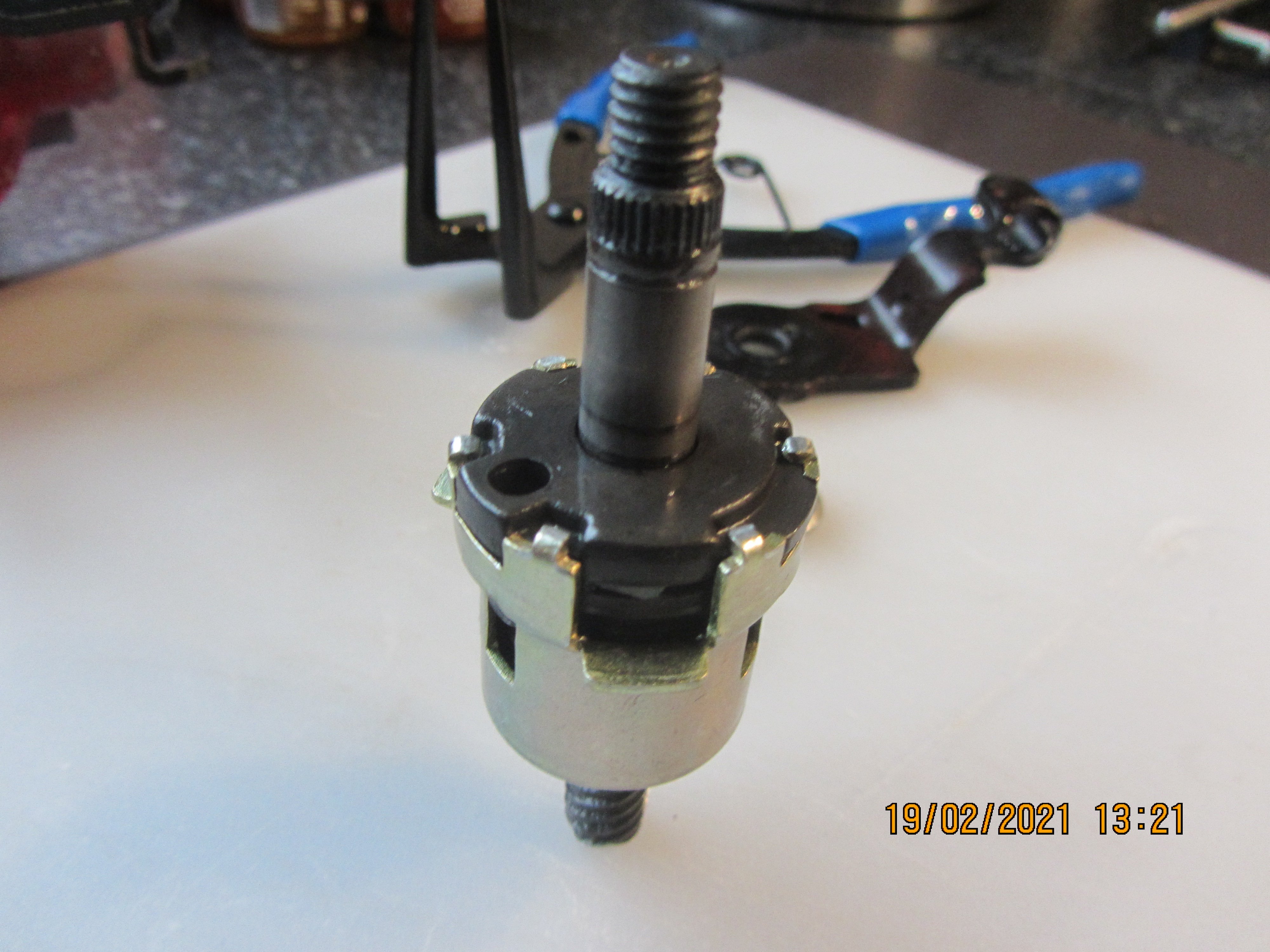

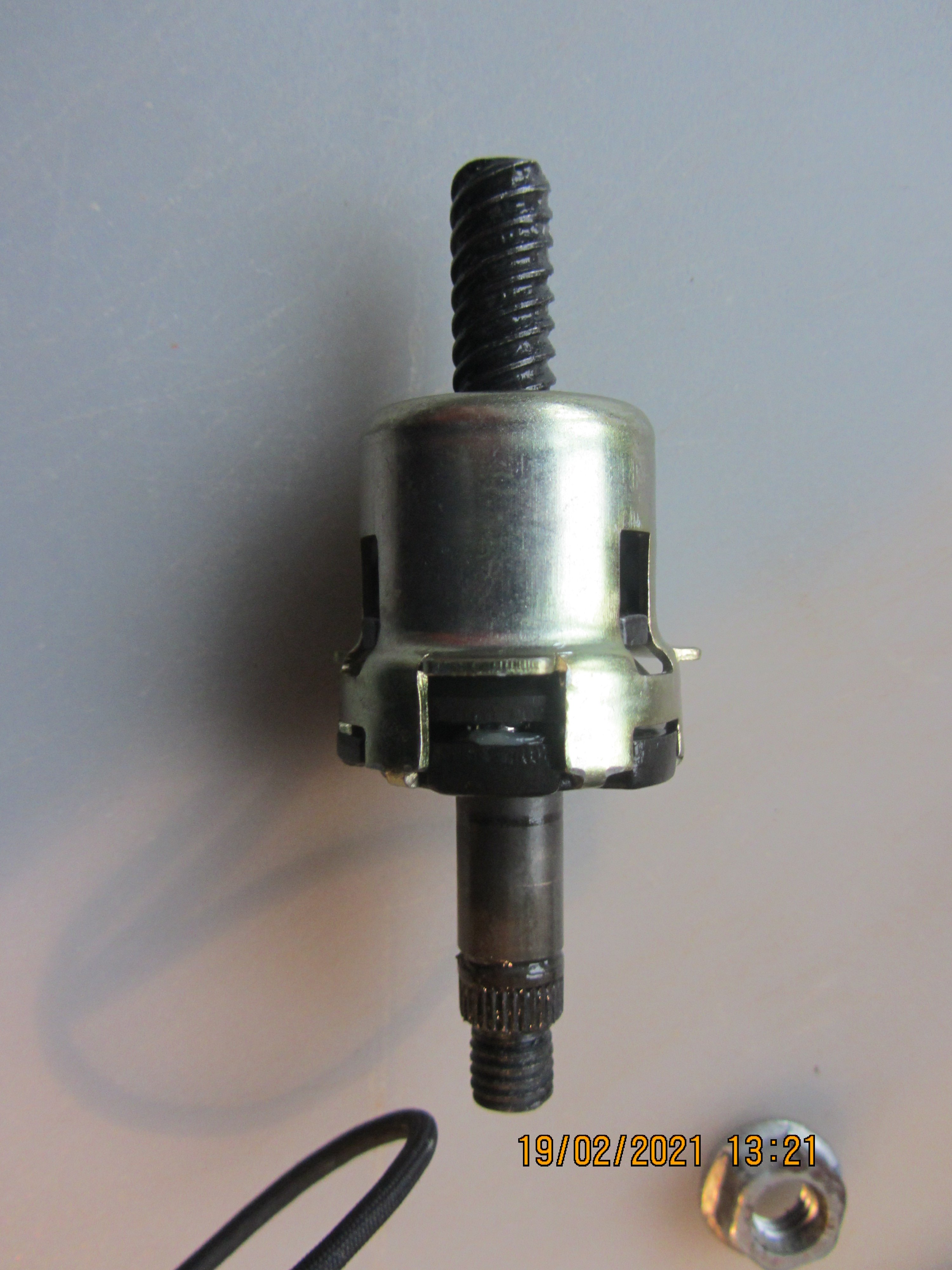

  9. My Yeti has this problem, and has been getting worse over the years. I life on a hill with a sloping drive, big wood chocks are now needing to stop creep. Yes, hard foot braking and yanking on the hand brake lever has some effect, although the hand brake movement is twice the amount I can get without foot brake use. Many attempts have been made by dealers and indies to no effect. The sliders, pads and discs are all good. I think the problem is the automatic adjuster behind the hydraulic piston. I have some Golf Mk 4 rear calipers which I was going to fit on my MG, but didn't as I was able to rejuvenate my Rover 800 rear calipers which are OEM fitment. I've taken the Golf calipers apart, and the handbrake adjustment is a tightly clenched packaged unit which seems very difficult to find. I don't know if it is the same as in the Yeti, but I may have to get new rear calipers as it's getting worse all the time. The front discs are fine, disc wear is uniform and may be compensating for poor rear brakes. The rear discs look tatty, indicating not really working effectively? My MoT testing garage uses a Tapley meter, so I haven't any real data. It passes every time!!

  11. My handbrake has always been "weak" and has never held securely on my sloping drive without chocking. Despite many attempts by main dealer and indies to rectify - no success. The only way to get some sort of grip is the old dodge of standing on the foot brake and then applying the handbrake. The lever travels quite a distance, goes solid and holds on a hill with some creaking. I have some new Golf calipers which I was going to retro fit to my MG, but gave up for various reasons. Dismantling the caliper revealed the adjustment "cartridge" a clenched over little sealed unit: I think the problem lies here, and would seem to need new calipers to sort out.
