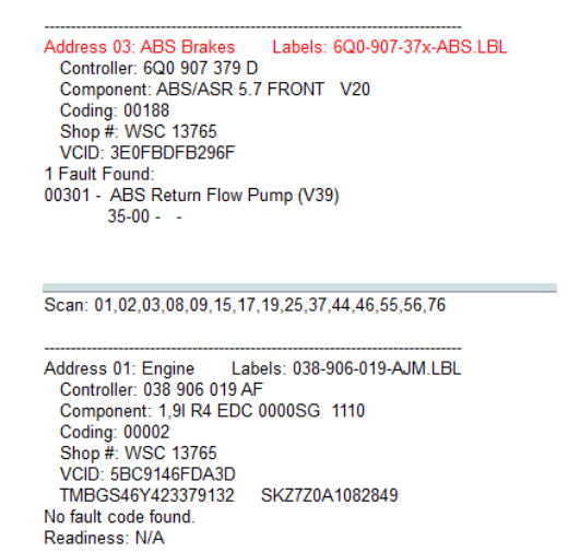

 I have purchased a diagnostic lead from Gendan and  loaded the Ross tech software. This is the reading .
Is the ABS ecu module ??? Any help appreciated ...

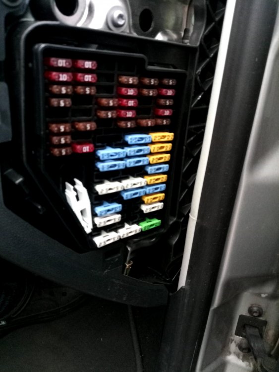

No, try the 6th one.  Take a well lit, sharply focussed photo of it.
Believe all fuses are good ........is 6th the same as 3rd fro  RHS ?
Will put a multimeter on tomorrow to confirm all good ... BUT garage stated all were good and replaced the blown one.......George

6th from left (looking from in front of car into engine bay). 1st from right of the strip fuses.
Don't trust garage; check, measure, photograph. Never seen that fault code not be the strip fuse. In this circumstance they don't 'blow', they crack, sometimes almost invisibly, so if they did replace a blown/melted one, it probably wasn't the ABS one.

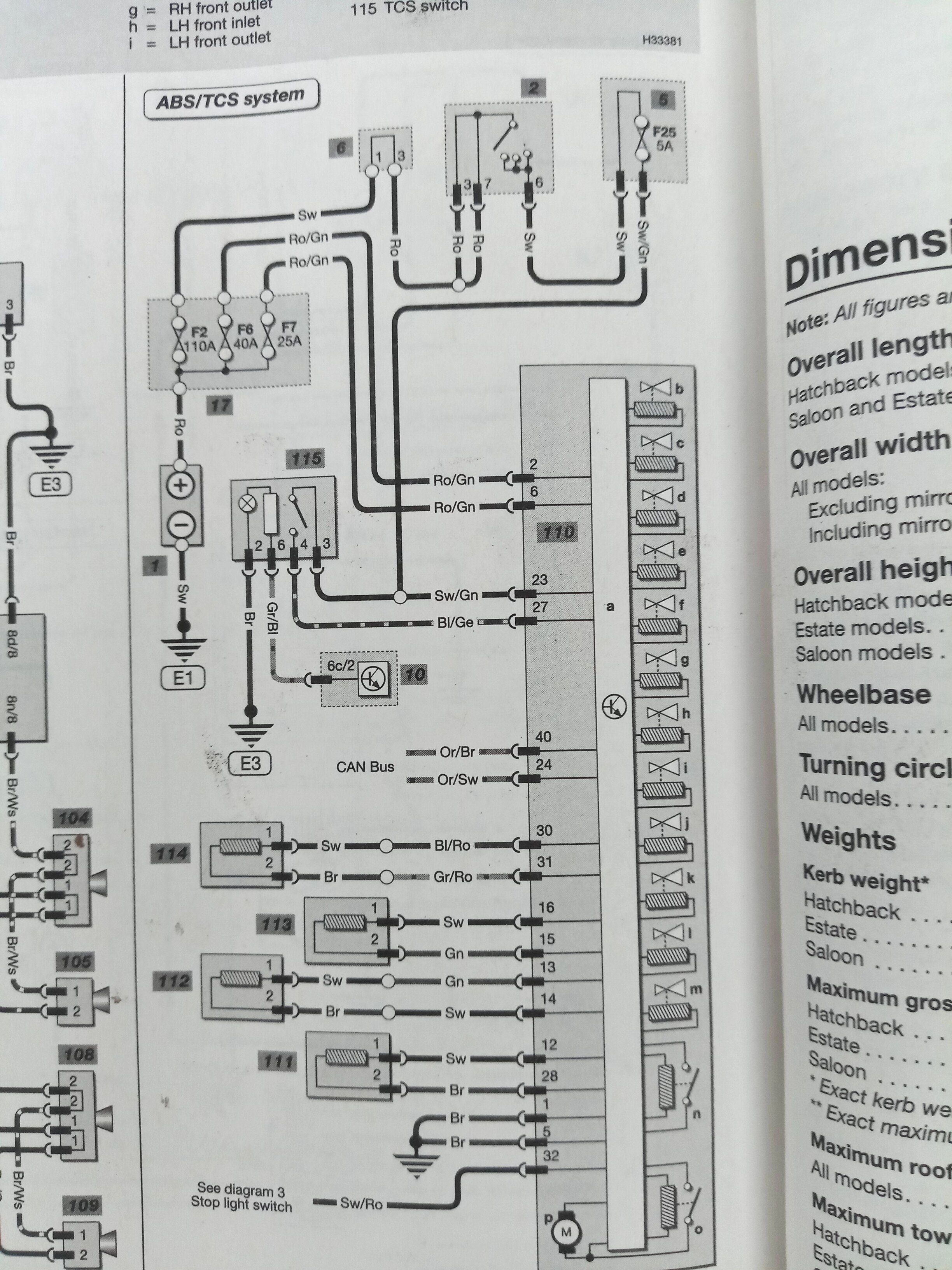

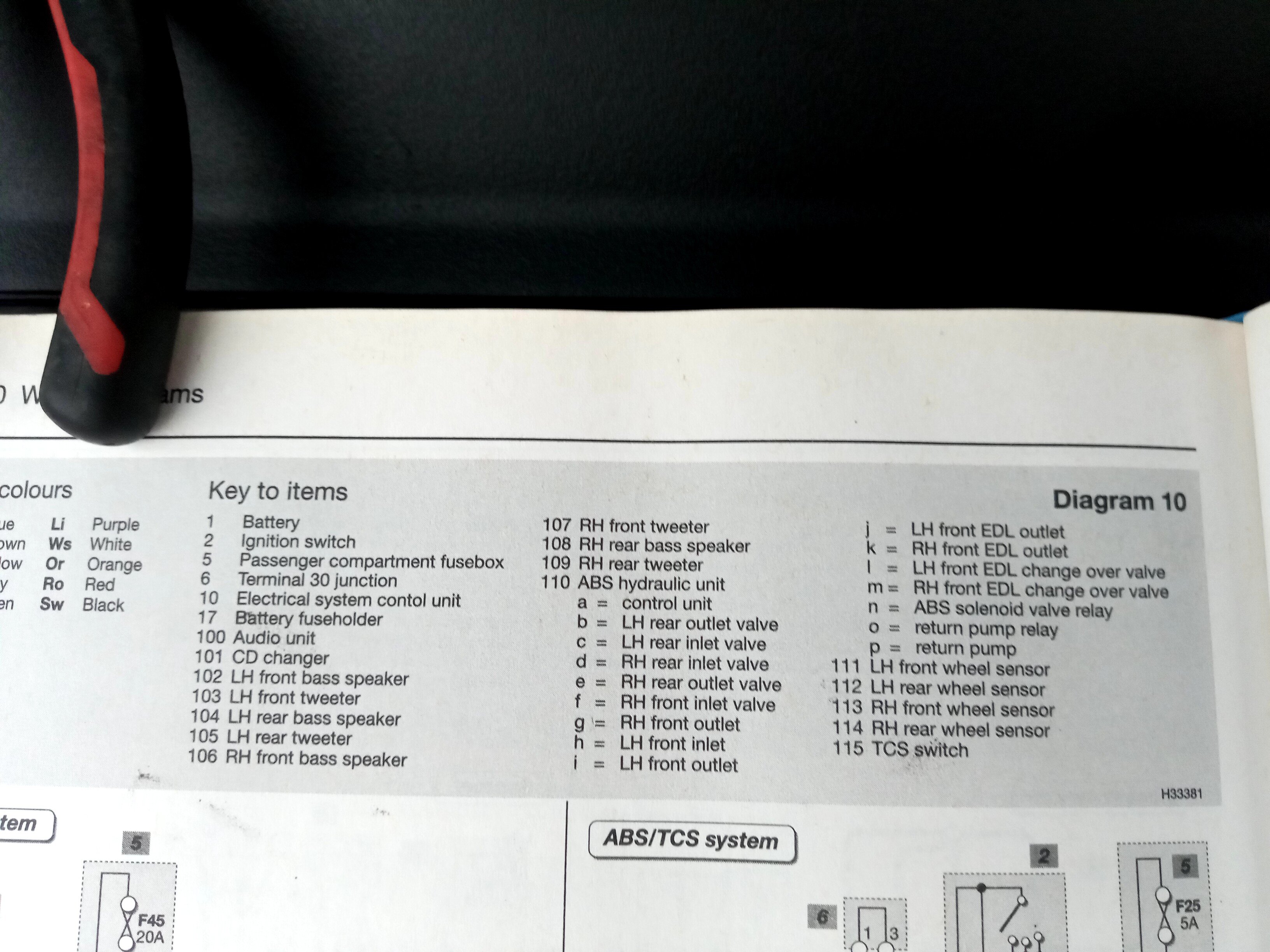

Using trusty Haynes manual i cheched cabin fuse (5A 2nd column 3rd down)    beeps good.

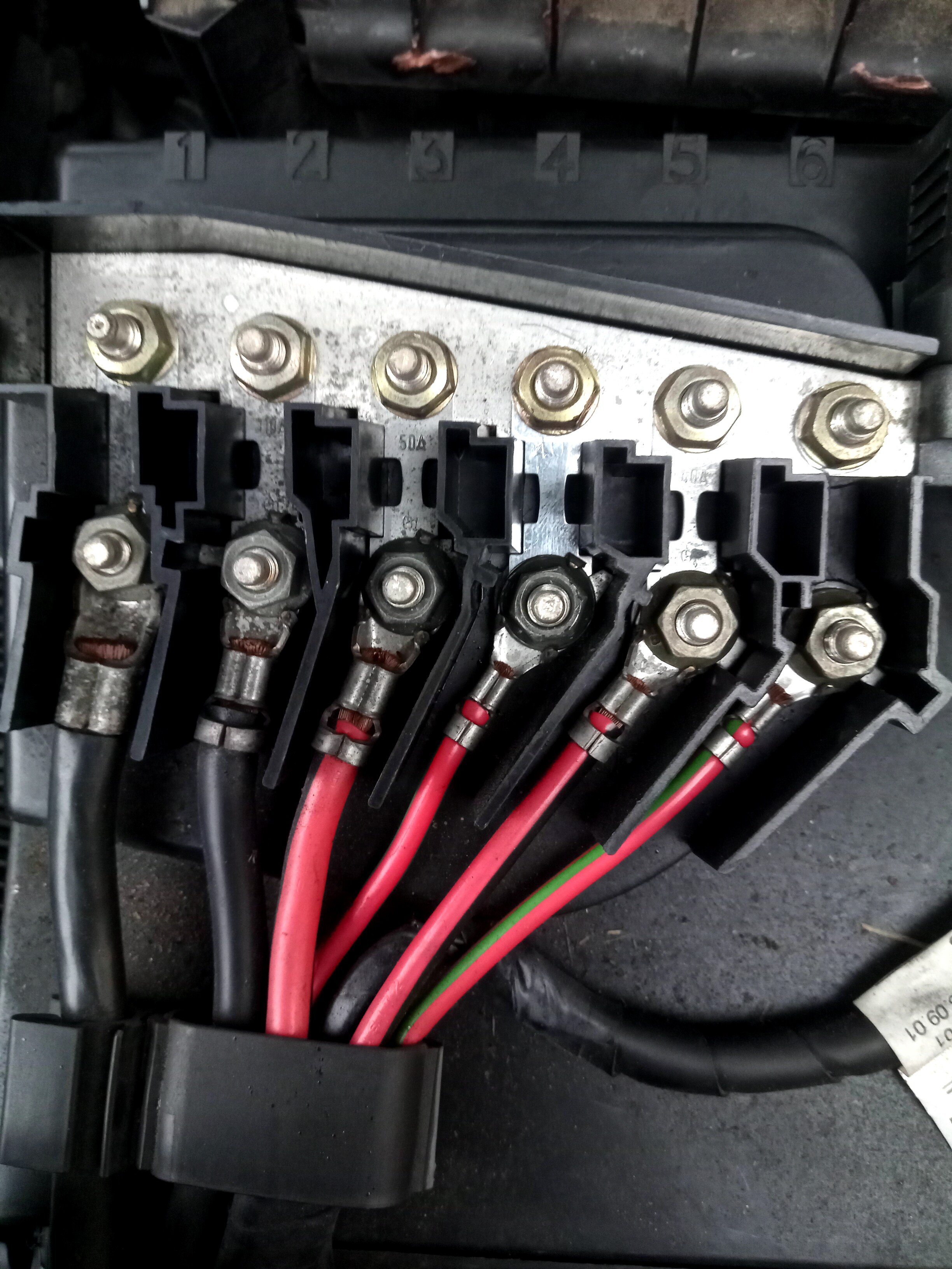

then checked fuse links on top of battery .all beep ok - no.5  is new BUT no.6 is missing ?? Have the garage not refitted it ??? is this the correct fuse ??
George
  • Sponsor
That'll be why you're getting that warning!
40A stripfuse needed there in position 6. No idea what your garage were up to*.

Fit correct fuse, drive a few yards/metres and the lights will go out. :)
links ordered will report back ;)
George
Ebay fuse links -£1.99 for 10 .
Link fitted , lights out after 3 yds !!!  well chuffed.
