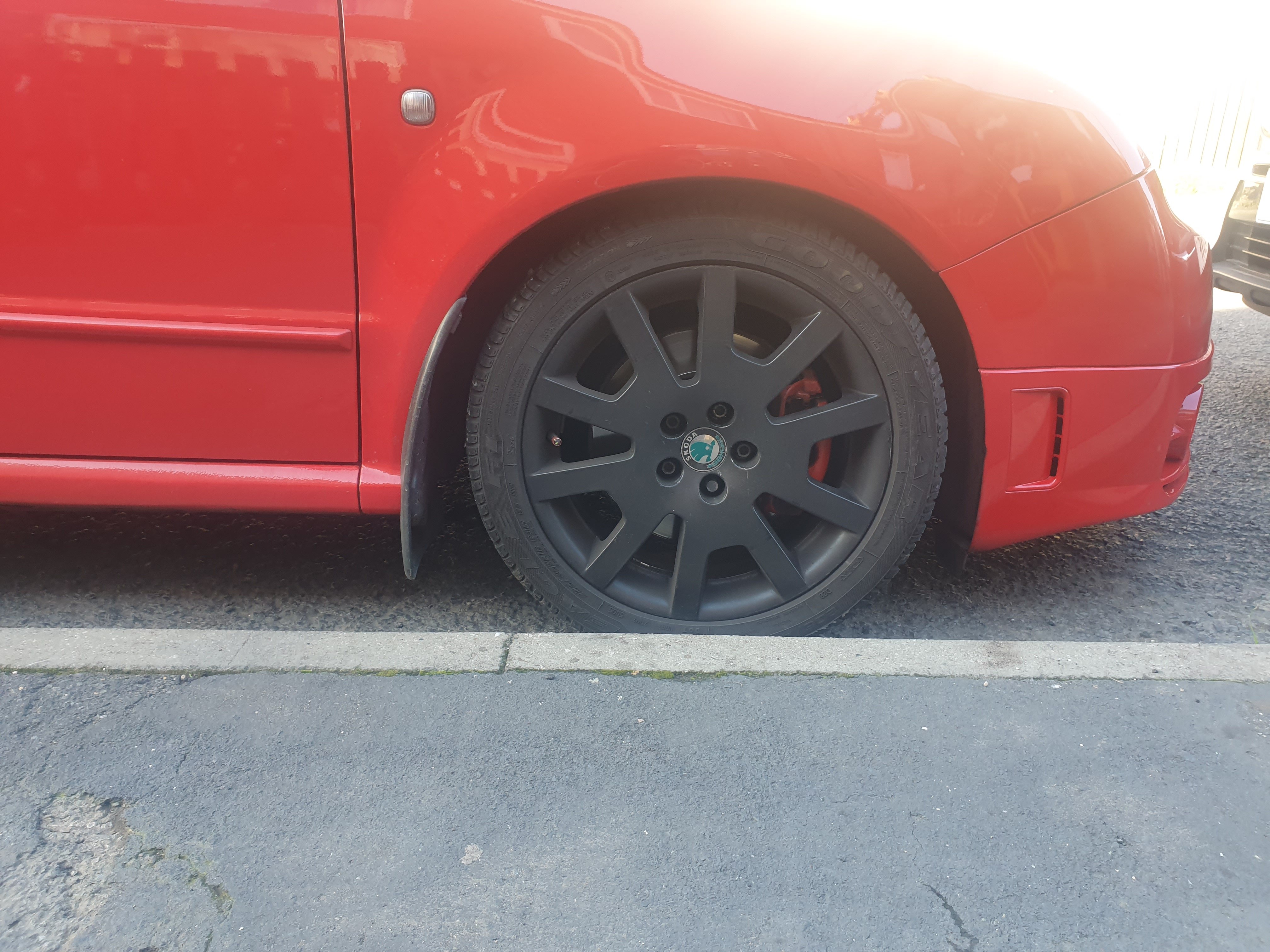

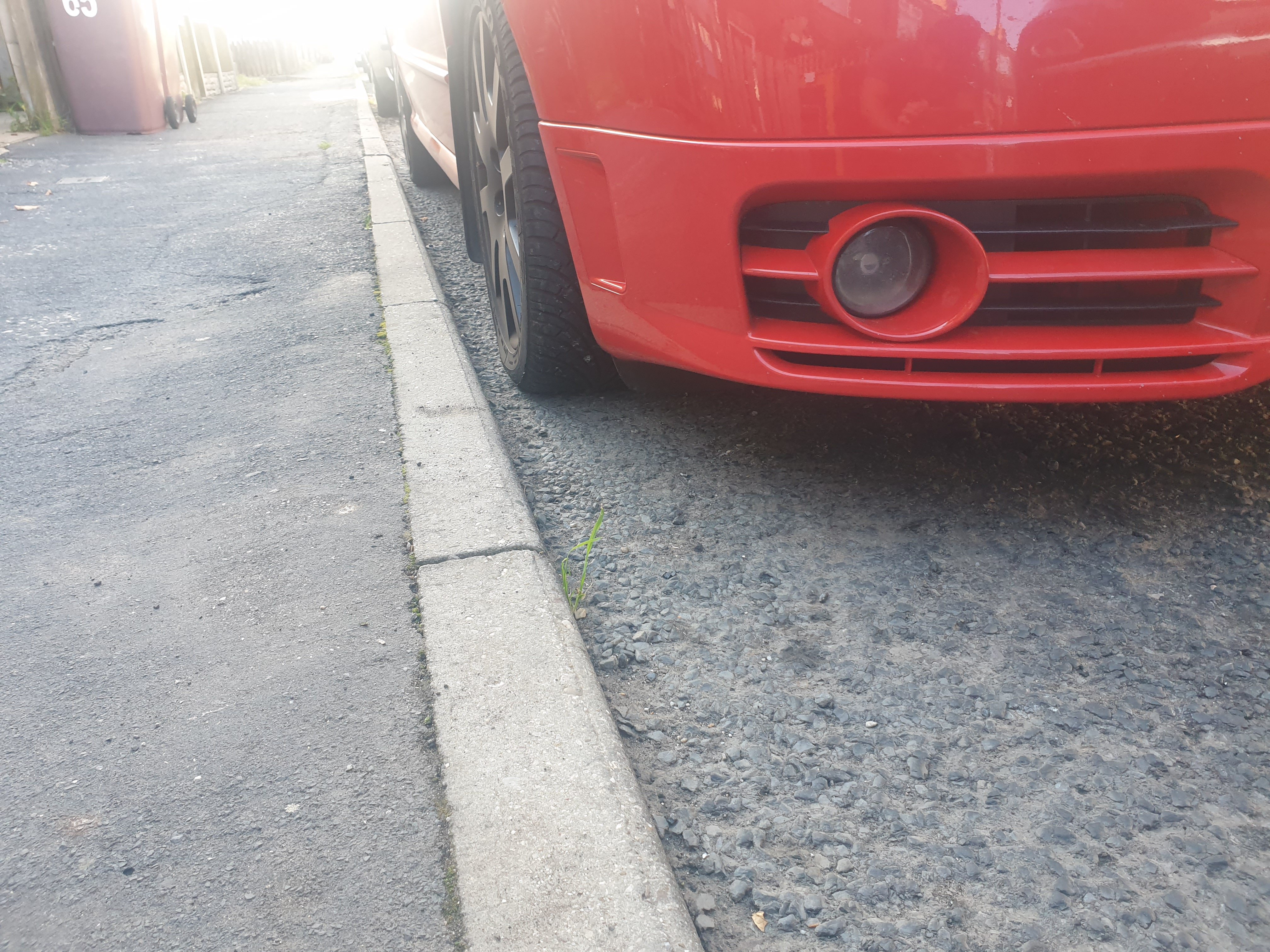

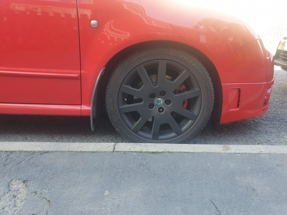

heres  a wider view apex 35mm on back and h&r 35mm on front
That looks quite extreme. I'd be quite worried about the sump if that was my car.
Possibly you can claw some height back with a set of new front top mounts but if you're doing that, swap out the springs anyway.
I'm baffled as to what you mean by the track rod end being pulled out of its slot?

thanks for replying, Iam for sure worried about how low it specially after all the new parts i have changed. where the track rod end bolts up rather then being flush it has pulled down about 1-2cm when car was up in air the so when hitting slight bumps it sounds shocking... but thats not the issue. its how low the car sits with 35mm h&r springs new shocks. iam gunna buy some apex 35mm like car was on at the start. would new top mounts raise the car up ? i will get a picture when partner and kids in car its shocking. just cant figure out why i have took part number and spoke with larkspeed and it comes back as 35mm drop. madness car was fine on old parts :(

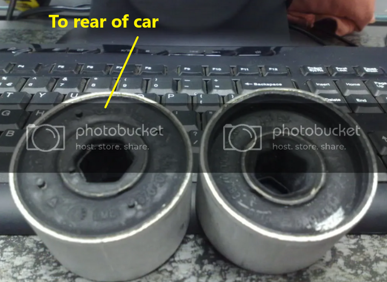

The Cupra console bushes should be fitted with the flush side towards the back of the car and with the hexagon hole flat at the top and bottom.

1 hour ago, TMB said:
You are more than welcome.
:):):) full of help :):)
that's great i will show the garage this
