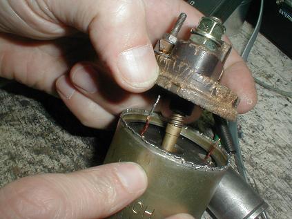

Not on mine- I had battery box out when I changed the battery  to rule it out. My problem was more like a sticky solenoid . I could hear the solenoid trying to engage, but no motor, till I tapped the solenoid. As I mentioned elsewhere ,I'm shocked at the gauge of the wire used . IMHO- far too small for the current the solenoid will draw . For information- IF it's possible ( I have not checked yet) the cure for solenoid problems is to take the solenoid off and clean inside and polish up the contact surfaces. last solenoid I had problems with had the high current wires soldered . I simply unsoldered  the connections, broke down the solenoid , cleaned the inside & contact surfaces.  I did get a clutch problem at one time and gave  starter to a mate in the Auto /electrical trade. After cleaning up the inside he remarked that it was as good as a new starter - and that was on a 15year old car.
Often the metal 'can' is crimped over the plastic end piece and can't be removed without trashing it.

Possibly that's the "modern"way . In that case a new solenoid might be possible ( if available).  I know my daughter had problems with solenoid a few years ago and a local place fitted a new solenoid.  Basically there's only a few areas where problems can occur
Brushes.
Solenoid contact area - poor contact after dirt on the contact surface.
Clutch mech. And that 's normally just dust/dirt build up .
