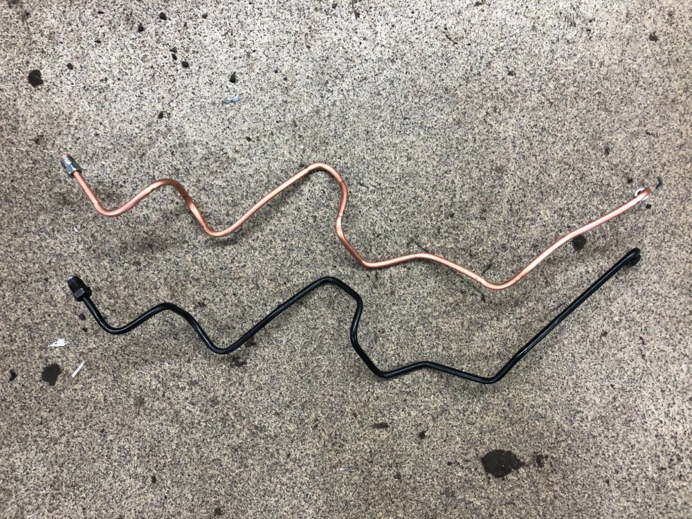

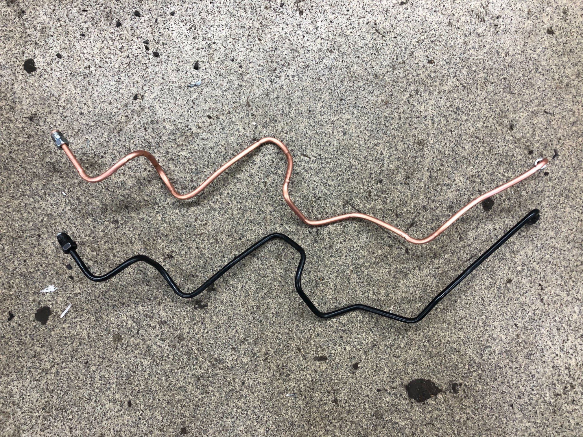

- left side: replaced brake last part of brake pipe (picture shows the copper one I formed next to original)

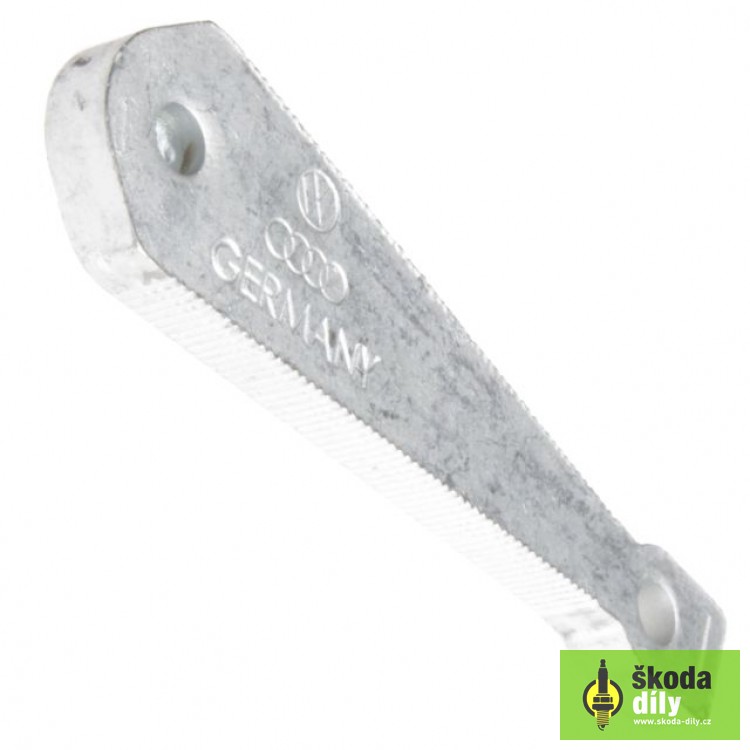

Is the auto adjuster working ok? The teeth on the adjuster wedges can become worn causing the wedge to not hold its position.
Edited by TMB
They look fine. If they were the problem, shouldn't the hand brake test show exact same symptoms as when using the pedal?
