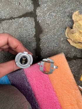

I was removing the high beam in mu Skoda Fabia Mk3 2016 to replace it, the retaining spring clip got lost in the process. It seems to be the same clip for the high beams and the main beams I think. When I contacted the dealership they said that I can only get a new headlight assembly for $$$ - not just the clip.
I have found a part number from a website that says it is for Fabia 2 or Roomster but it looks the same to me as the one I uploaded with this post :
You can also buy them off amazon with next day prime delivery if you aren't willing to wait a month whilst you wait for a replacement to ship over.
Standard H7 clip:
https://www.amazon.co.uk/WinPower-Adapter-Retainer-Conversion-Accessories/dp/B01COS4K5Q
LED H7 conversion clip:
https://www.amazon.co.uk/Adapter-Retainer-Support-Conversion-Accessories/dp/B078MLTYHT
I can confirm the LED conversion clips do fit correctly and the standard H7 clips are pretty much identical so they should fit fine.

Electrokiddi I lost the exact same part, did any of the options work for you?
This one worked perfect :
