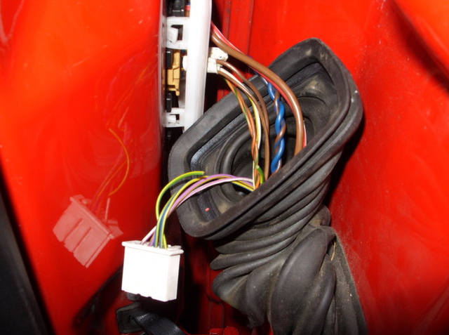

They might mean the wires in the door bellows, they can snap with the opening and closing of the doors over the years. Can be repaired if you're handy with a soldering iron.
This was mine for example...
