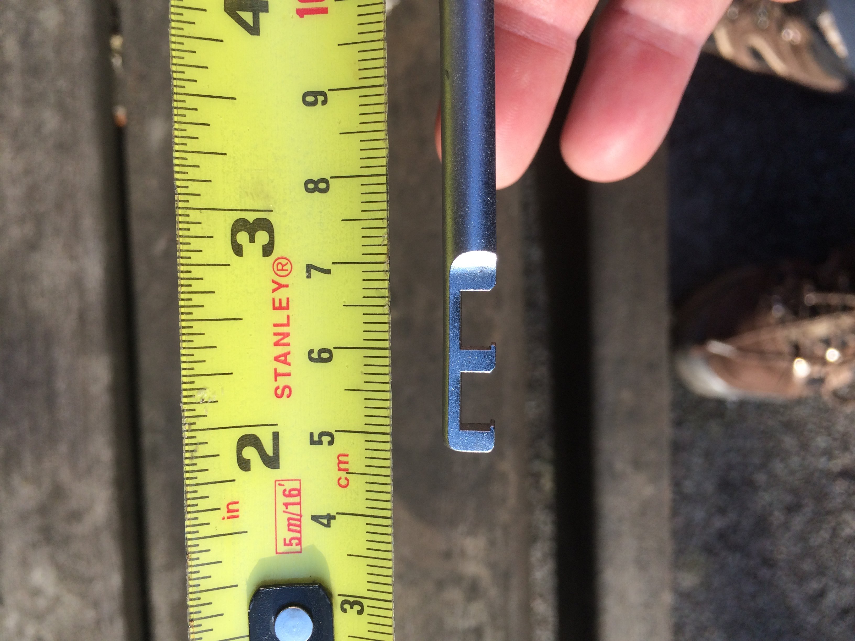

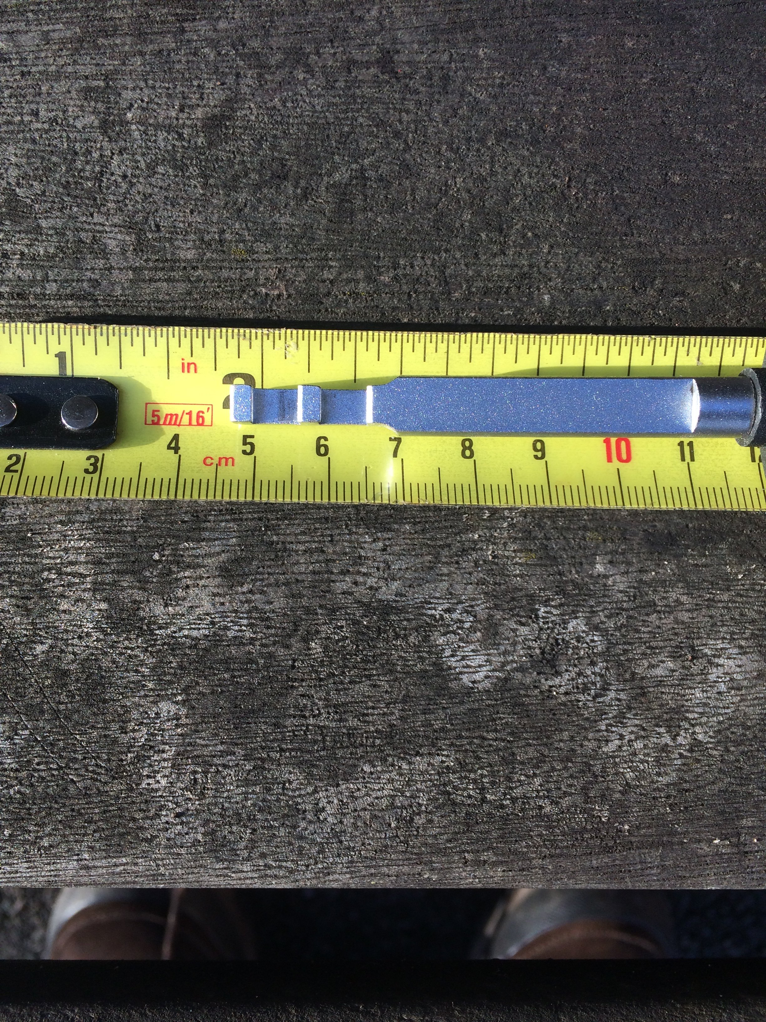

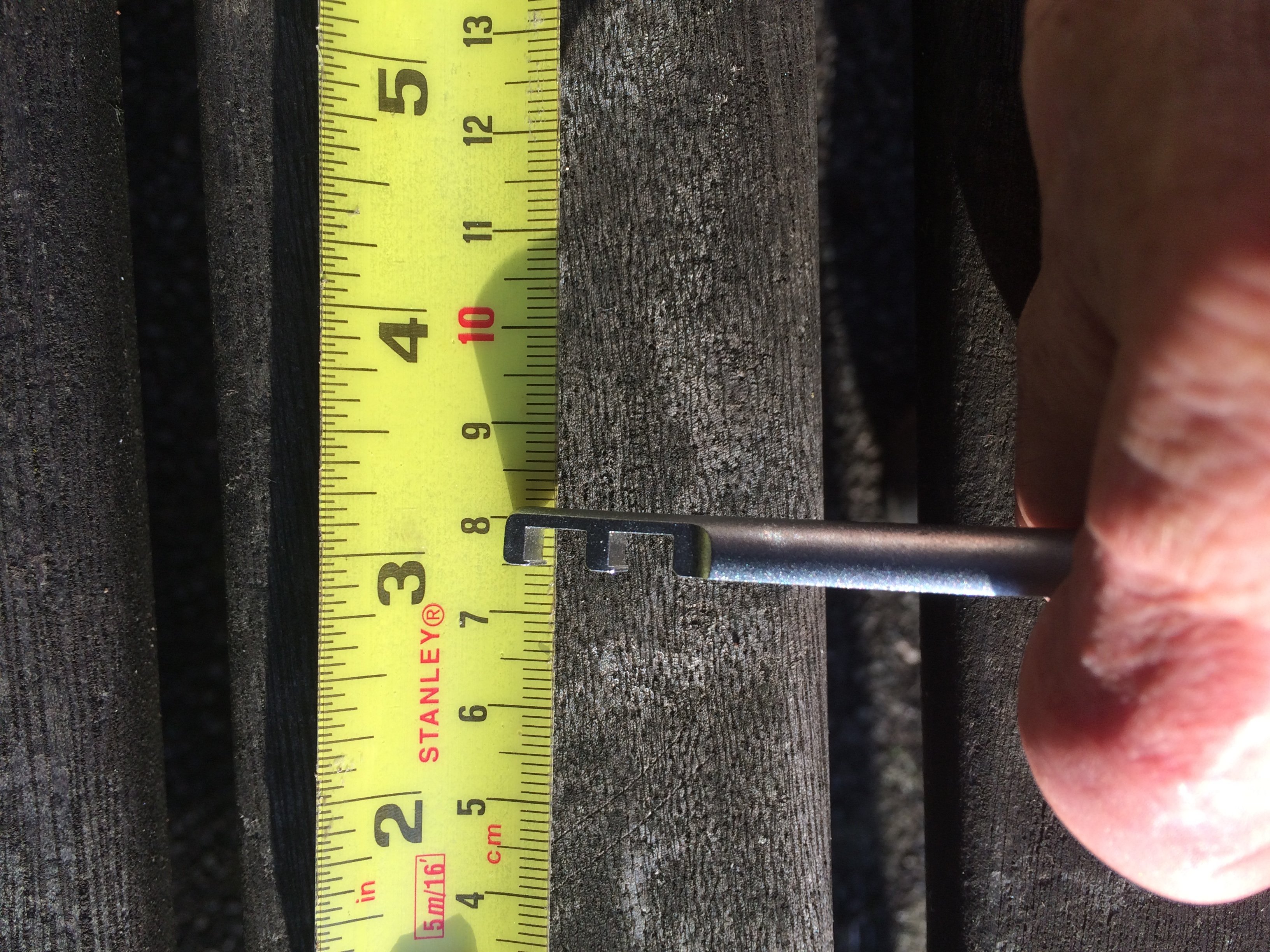

I'd be interested in seeing your connector latch tool. :)

Here is an example. Push with the tool then hold the connector down with your fingers then pull back the tool to release the tab whist still applying finger pressure to the end of the connector. It leaves the end of your finger in one piece and not feeling numb!
https://www.ebay.co.uk/p/12017007400
  • Sponsor
Reckon you could do some measuring and sketching of yours? Looks like a fun thing to try to make.
I'll take a photo in the morning alongside a a metal ruler and see if I can post it on here

Sorry it is a bit later than promised but here are 3 photos showing the business end of the tool with measurements. I greased the tensioner pully today. Probably added a bit much grease as I can see some squirted out due to centrifugal force. The bearing did seem a bit dry

Much appreciated, and good pics. :)
Those hooky/barby bits are subtle details.
